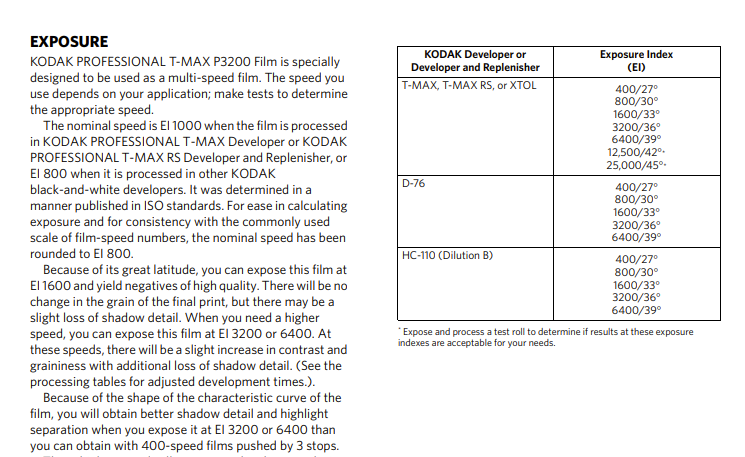

Perhaps not by folks on this forum, but there indeed is confusion out there about the difference between ISO and personal E.I. I have seen web reviews that, for example, claim that Delta 3200 and Tmax P3200 have NO ISO, though the manufacturers list it in the data sheets. What they may be getting at is that because these films were designed to be pushed, the reviewer feels that they don't have enough contrast when shot at ISO speed.
I am glad you mentioned the case of Foma using Microphen to establish ISO. There may be even a greater lack of awareness that ISO is established in relation to a specific developer, and if one uses a different developer, the results may be different. A novice may be forgiven because it may be that ISO is usually measured with a typical D-76 type developer.
Just read the fine print on the Tech sheets. Delta 3200 does have a "official" speed rating around 1000. But it was designed to be usable at higher speeds with only moderate loss to shadow detail. I personally rate it at 800 for sake of PMK pyro and full scale tonality. The case with TMZ is analogous, and also confessed in fine print. So both of these are representative instances of the nominal speed on the box being a marketing ploy - not a falsehood, but certainly a stretching of the rubber band.
You are being entirely too forgiving of the writers who say that Delta 3200 and TMax P3200 have no ISO. They say that because the ISO is not printed on the box, and they are too lazy to read the datasheet, where it couldn't be clearer. One wonders where they find the recommended developers and development times for processing the films when shot at higher EIs. Probably the MDC. God forbid that the have to read the datasheets.
EI not ISO. The nominal speed should be what the ISO would be if it was done to the ISO standard. Odds are they didn't complete some part of the standard like testing film from multiple batches over the course of a number of months. Every other value would have to be an EI even if they did.
I just visited three D 3200 reviews that praise it's "wide ISO range," and some say it can be pushed to "ISO 3200". It annoys me is that reviewers sometimes imply that because the films have a wide exposure latitude, they are categorically different than other films, hence the fallacy that they have "no fixed ISO". There might be a kernel of truth that films are distinct in being intended to be pushed. But in the end, I think it is misleading to describe them that way. P3200 shot at E.I. 3200 is a two-stop push. The difference between it at 800 and 3200 is similar in character to the difference between HP-5 shot at 400 and shot at 1600. There will be a loss of shadow detail, more grain etc. with both. The trade-offs are similar. A push is a push and D 3200 and P3200 are not entirely different than other films in this respect.
"It was determined in a manner published in ISO standards." sounds pretty clear to me. Perhaps you think the statement is ambiguous.
D 3200 does have a rather long toe allowing you to capture at least something down there with under-exposure, if not ideally. I don't use it for that reason, but at realistic speed, and mostly during walks in the rain under soft lighting, when it's nice to quickly pull out my Fuji 6X( RF from under my rain for a quick shot. It can be lovely film for those conditions.
It said in a manner. If the standards are not followed exactly you cannot include the ISO prefix. Kodak probably only followed the sensititetric exposure and processing part, which is enough to achieve a film speed value. If they did the work, they would have included the prefix.

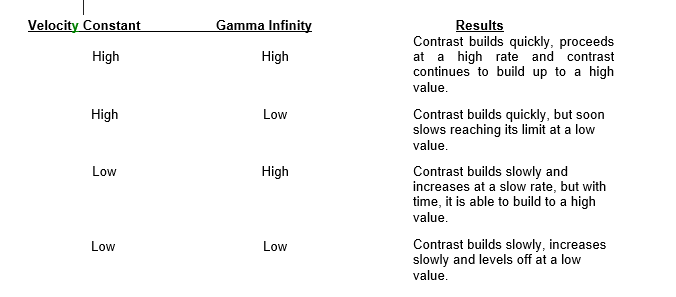

The characteristic of the time / gradient curve can be of additional help, and it's a little discussed topic.
Films with high velocities reach normal contrast fairly quickly. The developer may have insufficient time to adequately develop the sub latent image in the halide crystal which can result in lower effective film speeds. A 400 ISO film could have an EFS of 100 in a high velocity film/developer situation.
A lower velocity combination would reach normal contrast with sufficient time to allow for more complete development of the shadow values. This will more than likely result in a film with an EFS closer to the ISO.
A film with a high gamma infinity makes for a versatile film. It is able to handle a greater range of pushing. However, when pushing for speed, a low velocity/ low gamma infinity film would work best. The longer development times will give greater speed potential and the lower gamma will restrict excessive contrast.
Films with a low velocity are good for less precise systems or for an amateur just learning to process film. The allowable error in development is higher for the same level of precision control than with a high velocity film/developer (see example). The origin of the myth that one film is contrastier than another film in a given chemistry perhaps comes from this point.
