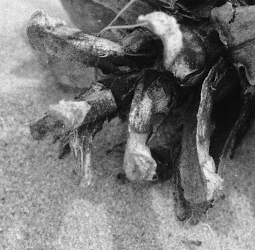

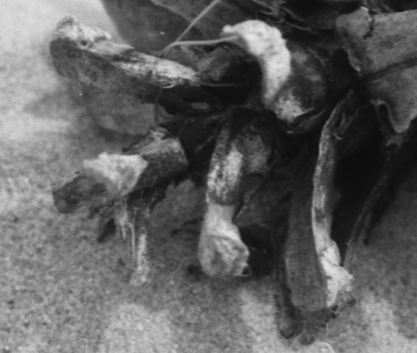

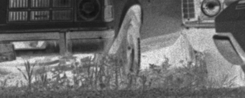

For amusements' sake, here's 3 scans of the same negative made with 3 scanners, all downsampled to the 3200dpi native resolution of the lowest common denominator (so not the 4990):
No sharpening was applied to any of these scans. They were acquired, 2 out of 3 were downsampled to 3200dpi and pasted here.

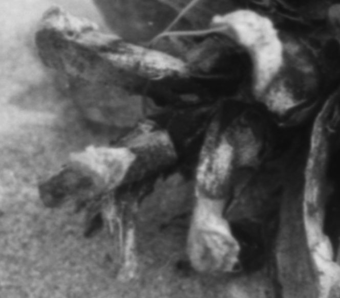

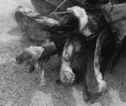

One of the samples of each set was scanned at 4800dpi, the other at 2400dpi (they are not necessarily presented in the same order - on purpose). Top row is both samples scaled to the same 4800dpi (so one scaled, the other left alone). Second row is the top row scaled back to 3200dpi (which is to a slight disadvantage of the 2400dpi capture, but I doubt it's relevant in practice), with some sharpening added. Bottom row is the 4800dpi scan downsampled to 2400dpi and the 2400dpi capture left alone, both with the same modest amount of sharpening applied.
There's a difference, for sure. Is it worth the extra scan time and storing up to 4x more data? That's the question I'd ask myself before pulling that slider all the way to the right.
"But your film isn't in the right place for proper focus" - this is with the stock Epson holder shimmed at optimal height for this scanner and this negative, taking into account film bulge. My scanner doesn't get any better than this.
"But your negative sucks, you need a proper test chart" - See reference Scan Dual IV 3200 dpi scan below (without sharpening, and with the same sharpening as applied to the '3200dpi' flatbed scan). Besides, what would be the advantage if the benefits only materialize with a resolution target and not with real-world images?

Thanks for samples @koraks. It's refreshing to actually see a demonstration with images instead of words only.
Did you also find out that there is a small bump in real resolution if you use the highest native resolution when the negative has enough detail and is scanned in optimal position?
I hope that the examples illustrate this aptly - the bump, which I do recognize in this n=1 test, is so small that I'm not sure whether people will consistently recognize it. I doubt I would, but I had the advantage of knowing which is which. I can imagine that there are negative structures that are more conducive to recognizing it. For those who need to eek out the maximum this scanner can yield, it may make some sense to scan those negatives (and IMO those only) at the highest resolution, and then sample back down to something more sensible (e.g. 2400dpi). However, if that sort of resolution gain matters, I'd recommend looking into different ways of digitizing those negatives, allowing for cleaner, crisper results 'out of the box'.
One would hope people would see the difference if they paid attention (it's 2nd, 1st and 2nd that is sharper).

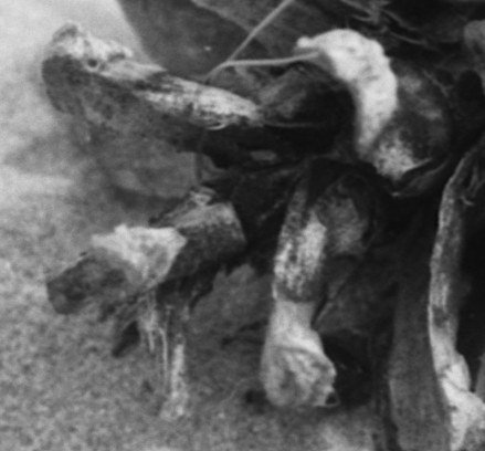

Image courtesy of @Don_ih
I think both of the top two are usable, with a preference for the middle image. The third (bottom) is not usable.
