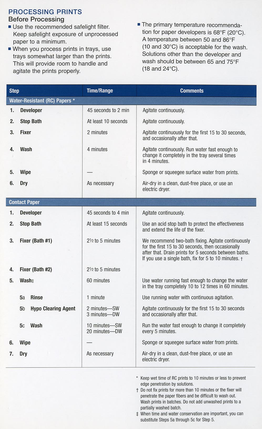

Kodak paper processing instructions
Here is the page from the Kodak darkroom dataguide with washing suggestions for all types of paper and that is most recent.
PE
