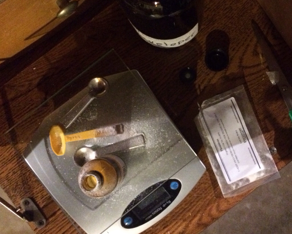

What happens when I try and mix powders... This is why I don't like them...
Was trying to make a Tech Pan developer...
Ugh... Well, we'll see how it comes out...
Why then send chemicals in baggies is beyond me, stupidest thing I've ever seen...
That's Phenidone by the way...
Stone,
Have you ever heard of a beaker?
Link
They are great for mixing your chemicals in. I usually use a two liter beaker, unless I'm mixing a gallon kit, in which case I use a large stainless steel container. Haven't gotten around to getting a gallon sized beaker yet.

I was by no means "rushing" and this is the aftermath of me trying to store the REST of the opens phenidone in something other than a baggie, so yes I should have used a small funnel which I will get in case I do this again.
The actual 1.5g part was relatively less messy, but still, I just find it much easier to pour liquid than mess with mixing powder.
