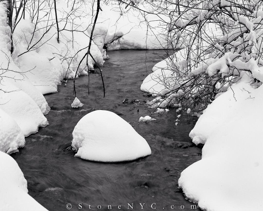

There's no camera shake.... It's a rangefinder on a tripod...
StoneNYC
StoneNYC
Aug 5, 2012
8,345
Antarctica
8x10 Format
If the exposure is long enough for water to move, its long enough for a camera to move.
Rangefinders on tripods can shake too.
I shot this specifically for this thread, there's no camera shake....

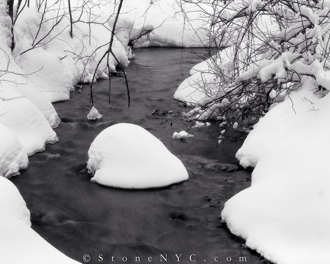

There is something going on in the second one. I will blame it on the coriolis effect. :D
They are both crops of a larger image...

Where's the non-rotary "control" picture?
I've been non-rotarying long enough to know what a good shot looks like and was just testing ilfsol 3 as an option (since I had used it for the GAF before with superb results... Apparently the GAF just works, too bad it doesn't exist anymore.
Once I find something that seems to work I'll do a control to compare.
