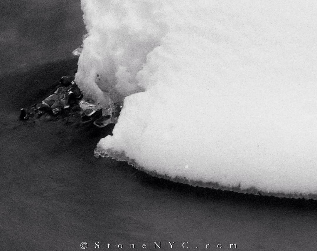

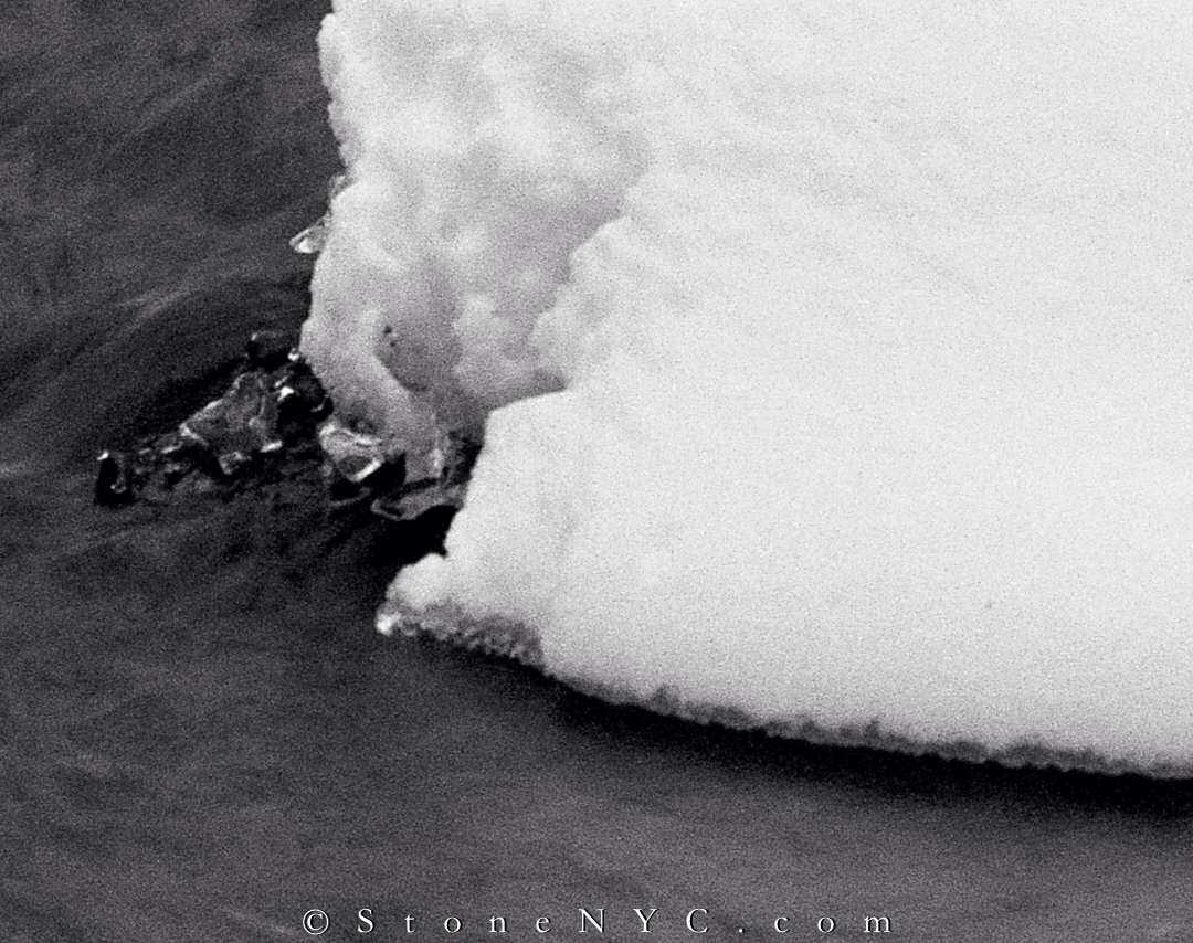

Is the contrast the same as the inversion processed ones?
I have never used Ilfosol but as long as I ad just the times for similar contrast I really can't tell a difference between my rotary and inversion processed negatives, using normal developers (D76 and T-Max in my case - I throw that in because I do use Diafine but not in rotary, and I wouldn't expect Rodinal style edge effects as we have already hashed out here.)
Especially if you don't use a pre-soak rotary times will usually need to be a bit less for the same contrast. If you don't adjust the time for similar contrast the contrastier rotary developed negatives will be somewhat over developed and likely to show more grain.

Not sure my phone will display this large enough, if it doesn't I'll have to borrow my GF's laptop later tonight to post a better larger image.
Both in ilfsol 3 same lens, shot etc, except one stop change for film speed differences... Rotary
GAF 200 aerial
TMY-2
The TMY looks more to me like scanner aliasing than film grain.
But that doesn't do Stone much good, if he has to rely on that scanner to get what he needs.
