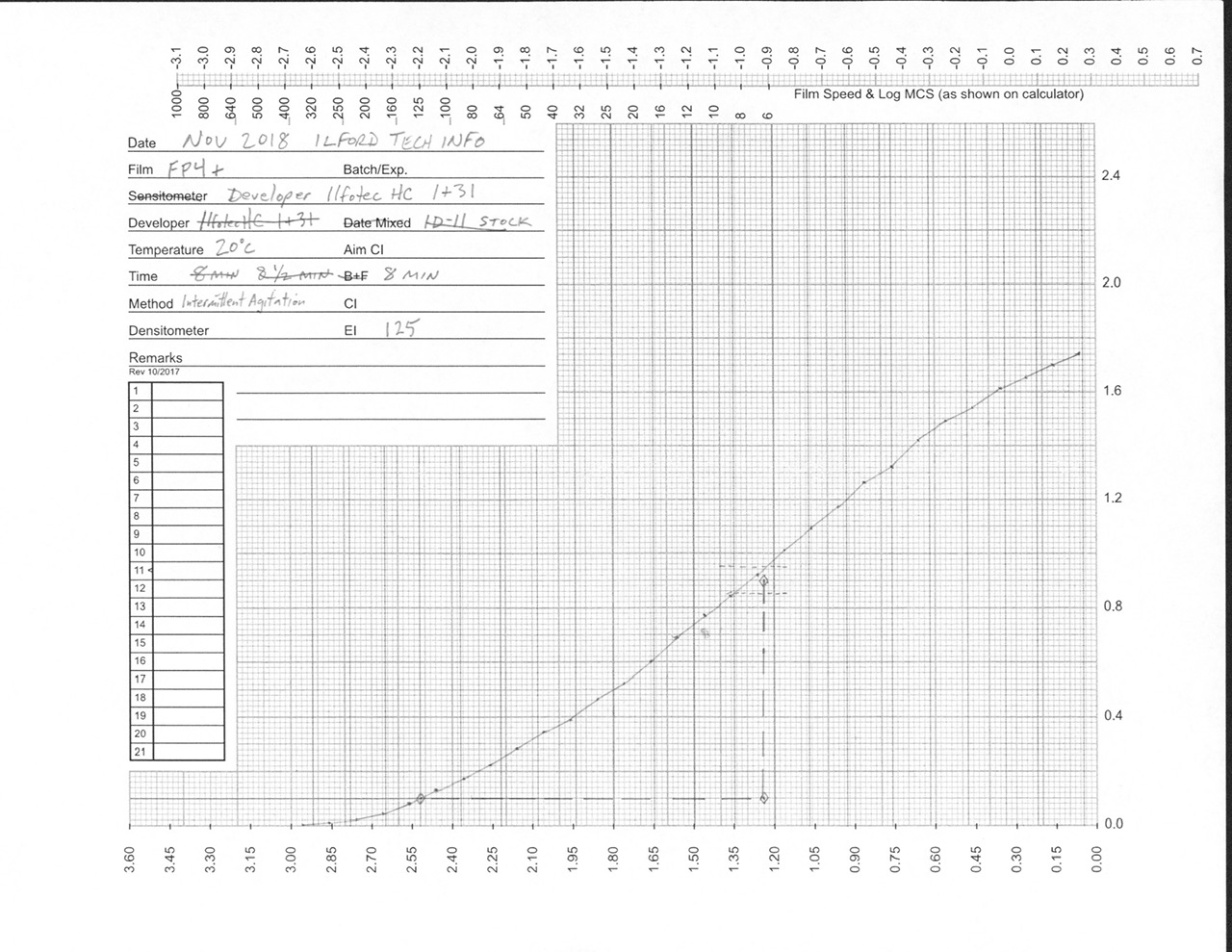

The HP5 document also refers to the ISO speed:
Although rated at ISO 400/27º, HP5 Plus can produce high quality prints when exposed at meter settings up to EI 3200/36 and given extended development in ILFORD ILFOTEC DD-X, ILFOTEC HC, MICROPHEN or RT RAPID developers.
For some of the films the wording is clearer so I think it’s just a matter of inconsistent writing. FP4 for example:
FP4 Plus has a speed rating of ISO 125/22º to daylight. The ISO speed rating was measured using ILFORD ID-11 developer at 20ºC/68ºF with intermittent agitation in a spiral tank. Best results are obtained at EI 125/22, but good image quality will also be obtained at meter settings from EI 50/18 to EI 200/24. It should be noted that the exposure index (EI) range recommended for FP4 Plus is based on a practical evaluation of film speed and is not based on foot speed, as is the ISO standard.
Bill Burk
Feb 9, 2010
9,455
Note: My transcription of the Ilford data sheet curve depends on the published curve being accurate. I divided the exposure axis into ten divisions and then calipered to the middle of the thick curve line at each crossing.
Then I set the speed scale to where the foot crosses 0.1
I didn’t actually process and graph my own results. I am curious to see how that will compare.
Last time I bought a couple boxes of paper the seller included a roll of HP5+, so I will test it sometime soon.
