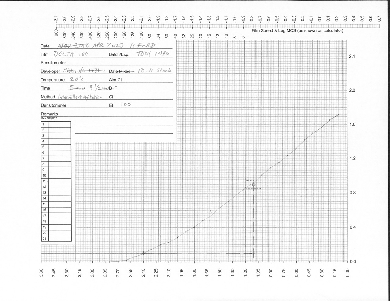

Note: My transcription of the Ilford data sheet curve depends on the published curve being accurate. I divided the exposure axis into ten divisions and then calipered to the middle of the thick curve line at each crossing.
Then I set the speed scale to where the foot crosses 0.1
I didn’t actually process and graph my own results. I am curious to see how that will compare.

The Ilford data sheets use relative log exposure, so there's not really much more they can do than give than an impression of the type of curve of the film. In my opinion, a good Gamma-time curve would be more helpful.
Their graph is crisp and clear, I think it transcribed fairly well. By tentatively pinning LogE at the speed point per corresponding film, I think the underlying exposure can be nearly identified. They were a little goofy changing the relative exposure between Delta 100 and FP4+ so their two graphs don’t make sense until you realize that and re-draw them aligned for exposure.
Here’s transcription of Delta 100 from their data sheet.
