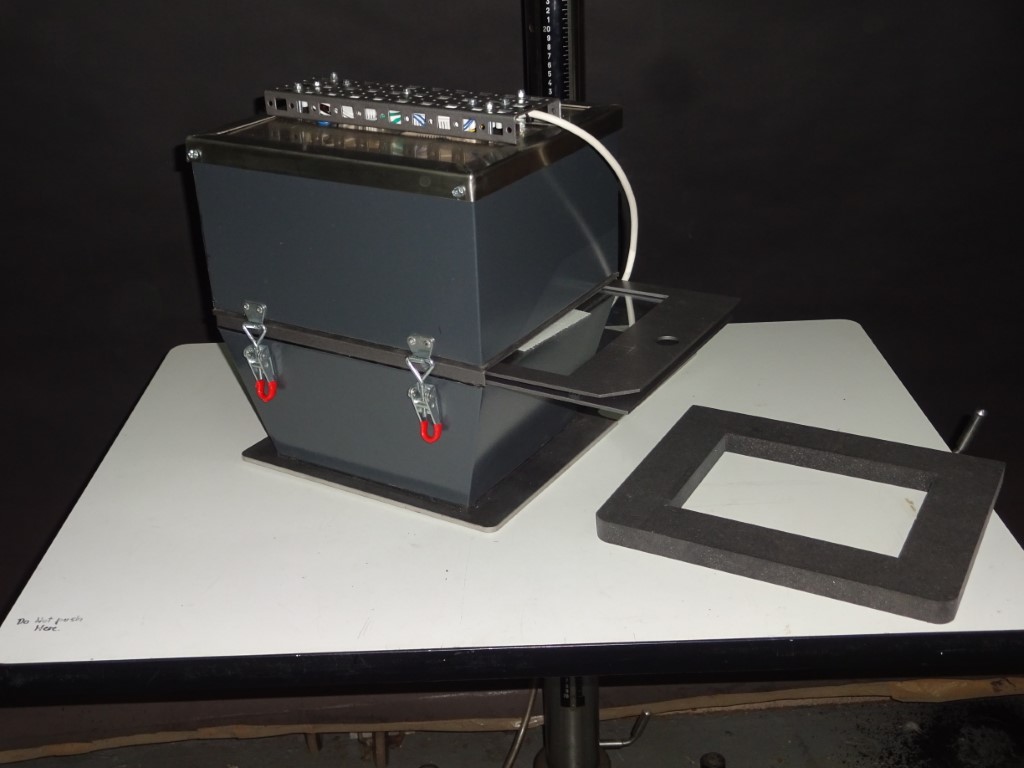

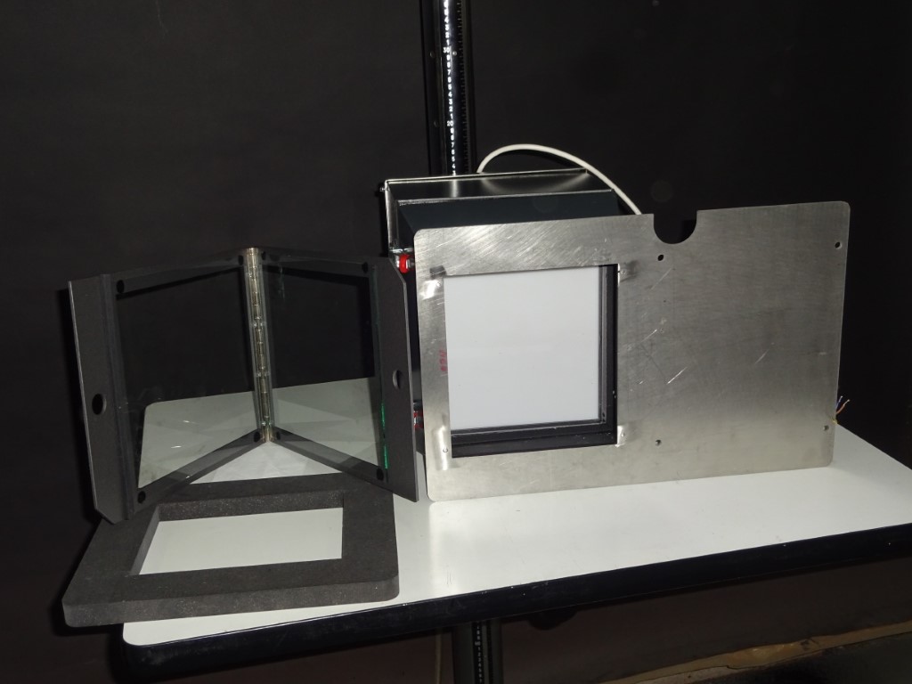

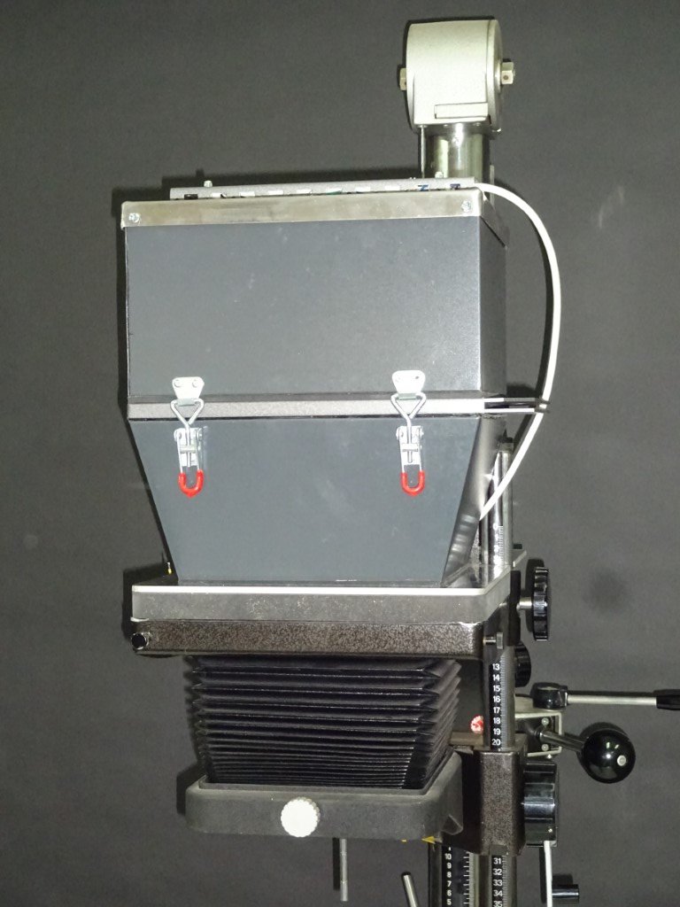

18x24 ( 8x10") conversion durst 138S / G139
all parts needed for the set up are included !
1 x light head with 53 pcs 3 w leds with 2 x led 240V drivers atatched
110 volt drivers on request - same price
1 x pyramidal stub (?) on stainless mounting plate
1 x negative holder for up to 8x10 neg.,double glass book type
1 x adapter plate to replace original 5x7 neg. holder
1 x light seal to replace 8x10 filmholder
(when you use original 5x7 holder for smaller formats)
4 x bolts for assembling
spare bulbs,
conversion is made for 240mm lens,
that makes vertical enlargemants over 1 x 1 meter on the board
no need for a noisy cooling fan.
all parts of lazer cut steel and stainless material,
finished in grey paint
you need a screwdriver and a 10mm spanner , a hack saw for small adjustment
and 1 hour for first time assembly
thereafter it only takes few minutes ( 4 x 6 mm bolts !) to change back to original enlargerhead if desired.
if you have any questions, please ask me.
asking price 440 euro for one unit ( two units 1200 euro - it takes me a lot of work and i do it for fun !!! )
klaus lundsgaard
nibe
denmark
ph 0045 - 2442 0096 evening

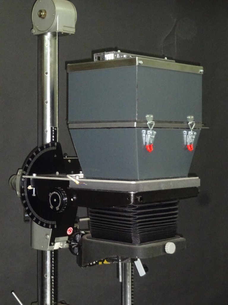

Is the LED light set up to print with VC filters? I have a Durst SM 183 and this would make it an 8x10 enlarger for B&W.
Do I understand it correctly? You'd send me the pieces to convert a 138 to 8x10 (along with instructions for the conversion)?
regards,
chris
I bought a set from Claudius, it works perfectly. The LED's produce a lot of light! It's very easy to assemble if you can handle a screwdriver & hacksaw. @Luis: VC-filters work fine. I use a Rodagon 240mm, if I'm not mistaken Claudius has a (or some) suitable enlarging lense(s) for sale as well.

yes you get all parts you need for converting your durst 138 / 139 into a full working 8x10 enlarger.
i am also giving you info on how to assemble - is actually very, very easy, like jeromen just said.
and the price is 440 euro, i had to raise it a little due to highter expences to the new, and far better, producer of the parts for the conv.
i belive postage to Germany is around 30 euro
klaus

View attachment 234500 View attachment 234501 View attachment 234502 View attachment 234503 View attachment 234504 View attachment 234505 View attachment 234506

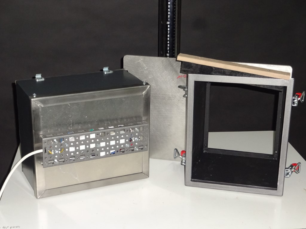

if the bulb , the fan, the heat - - is the problem, i have made a LED conversion instead of the
two 1000W halogen tubes i have in my BWL 300 light head with the same light output as 2000W halo - extremly bright and no heat and silent fans.
i got tired of the noise from the double fan and the heat in my darkroom.
if you have a light head of CLA 300 type ( or BWL 300) with reflector lamps on a flat plate that slides in two rails , my led conversion will fit nicely after disconnecting the original wire.

hi boon
it is quite difficult for me at distance to make a reasonable lightbox for you, as i said, i am not familiar with your L184 and have no acces to one.
if you can make the box yourself, i can ship the light panel to you.
my standard panel is 5mm alu plate at 240x280 mm in size and works on seperate led driver,
if this is not working for you i can make one in size for you.
i think it is possible to convert one of the condensors into a light box, but then i need you to send me two without the lens.
i have seen it done in fora. the condensor is not necessary as the light is diffused from a separate diffuser in the lower condenser slot.
klaus

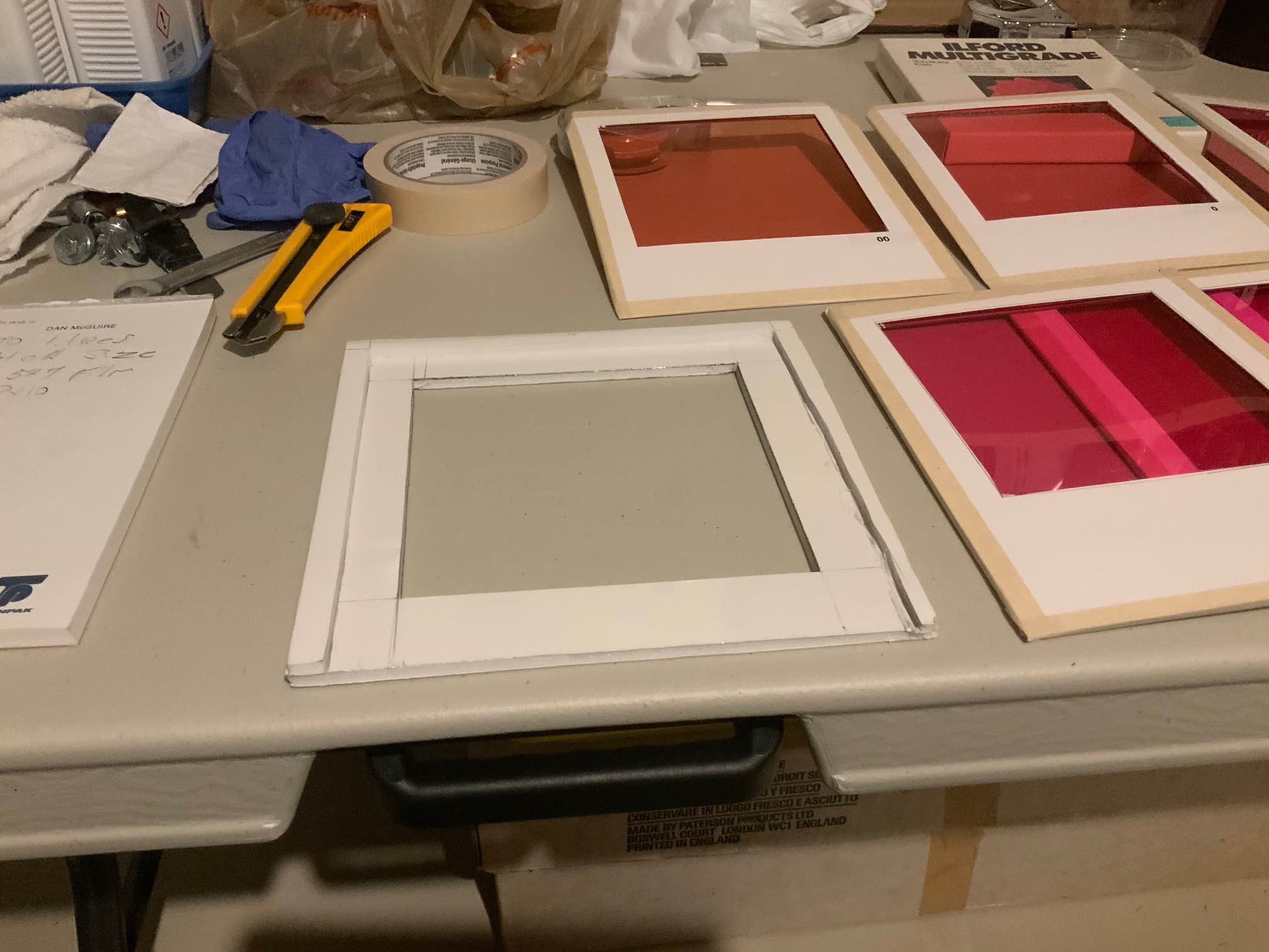

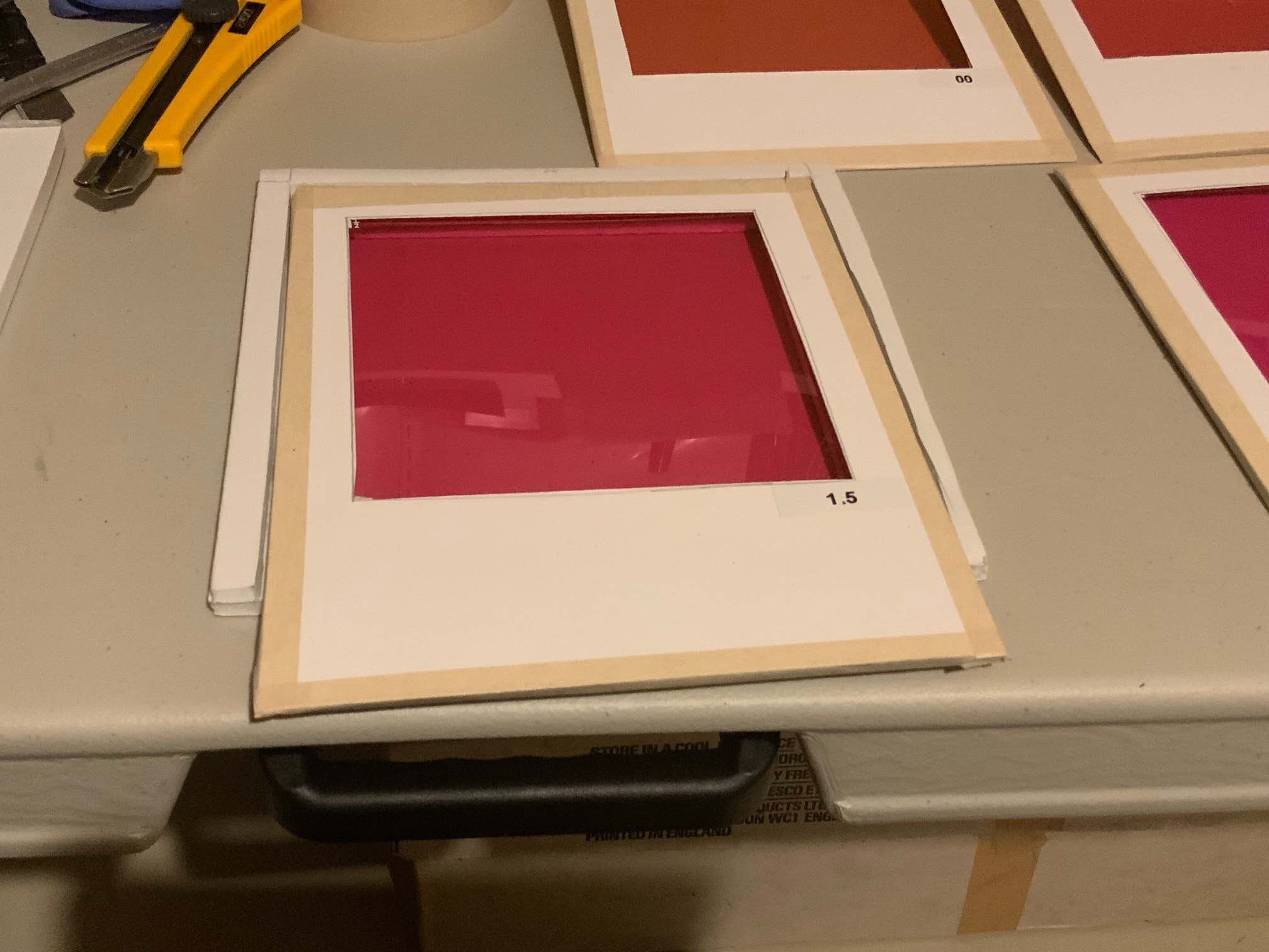

How do you use VC filters with this? Below the lens? Would a filter drawer right below the LED be possible?

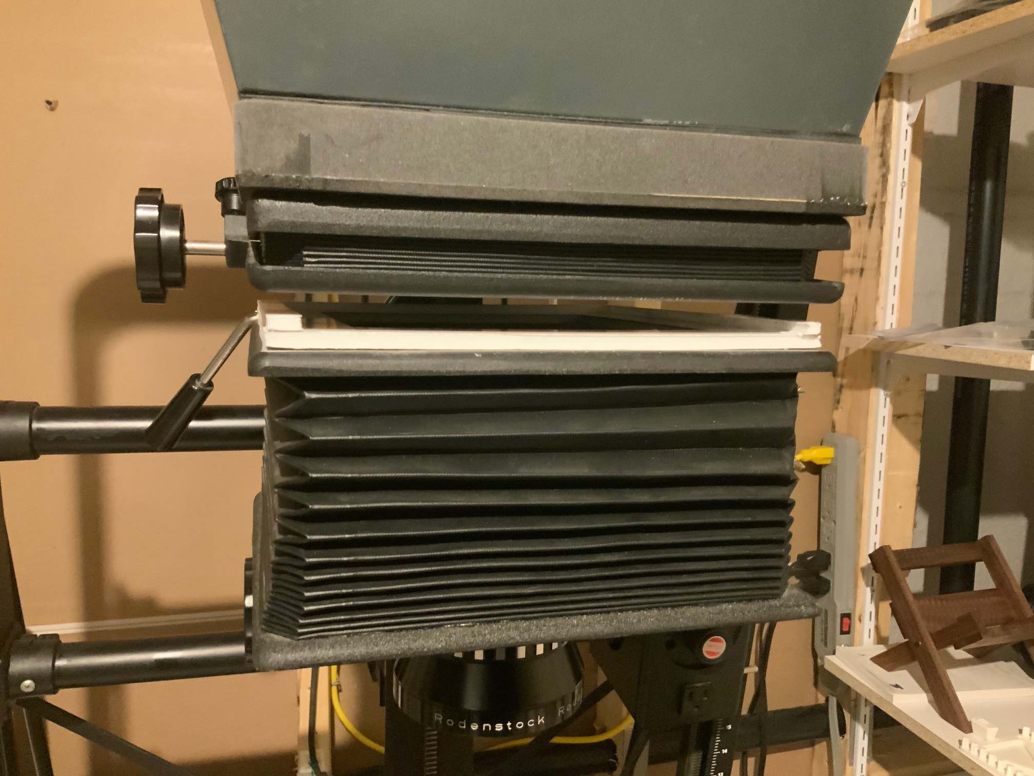

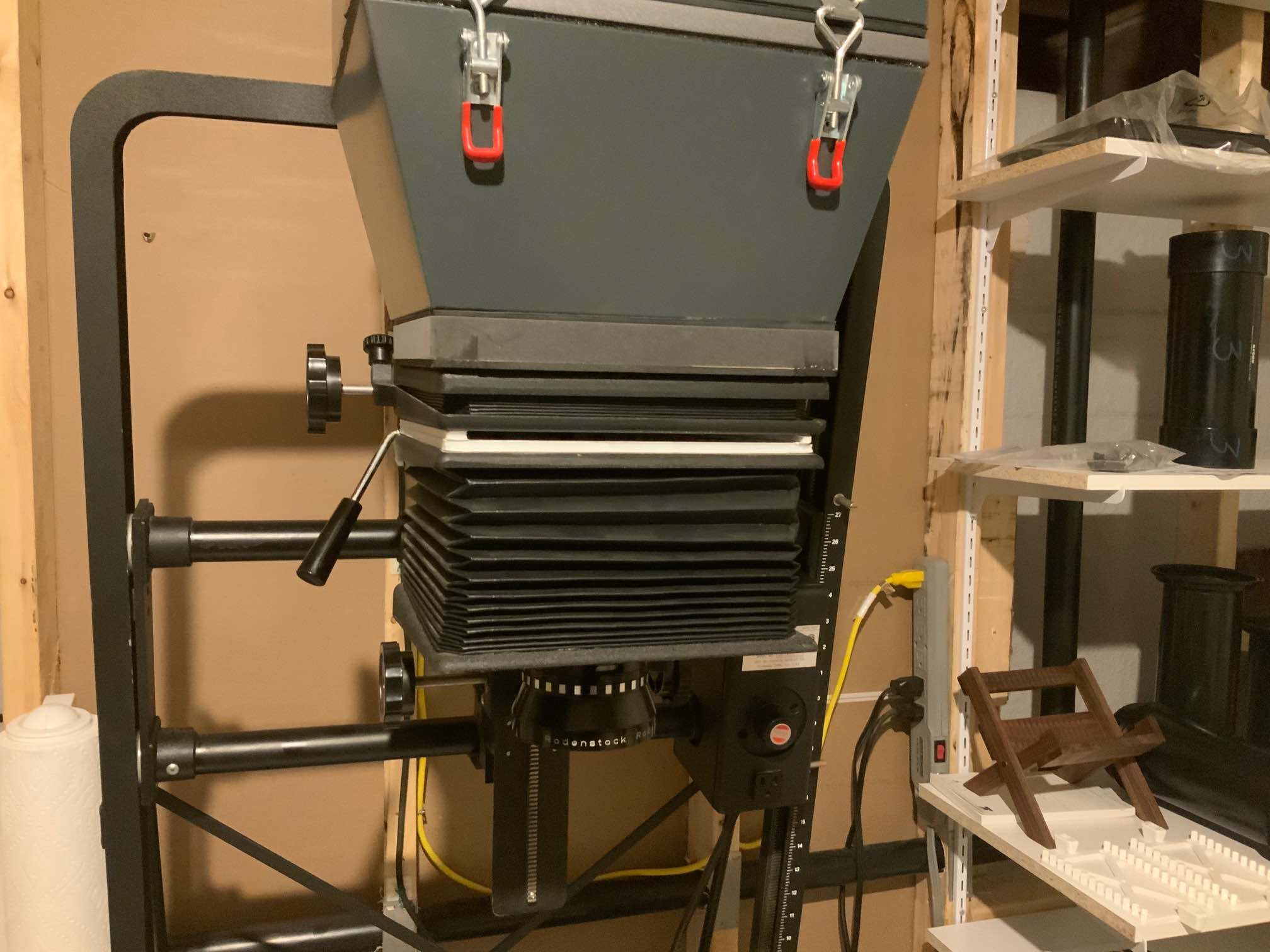

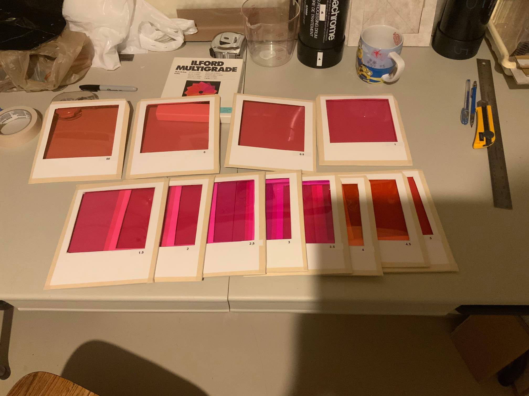

Hello
Funny you should post this question
I just spent yesterday and today putting together a DIY contrast filter solution for the Beseler 4x5 to 8x10 conversion enlarger by our friend Cladius
In place of the normal negative carrier I put in a drawer
I then clam shelled the contrast filters between some cardboard
and there you go, a filter drawer for the 8x10 conversion enlarger
Are are some pictures that hopefully show what I am talking about
Dan -- Happy user of the Beseler 4x5 to 8x10 conversion
IMG_0144.jpg IMG_0145.jpg IMG_0146.jpg IMG_0147.jpg IMG_0148.jpg IMG_0149.jpg

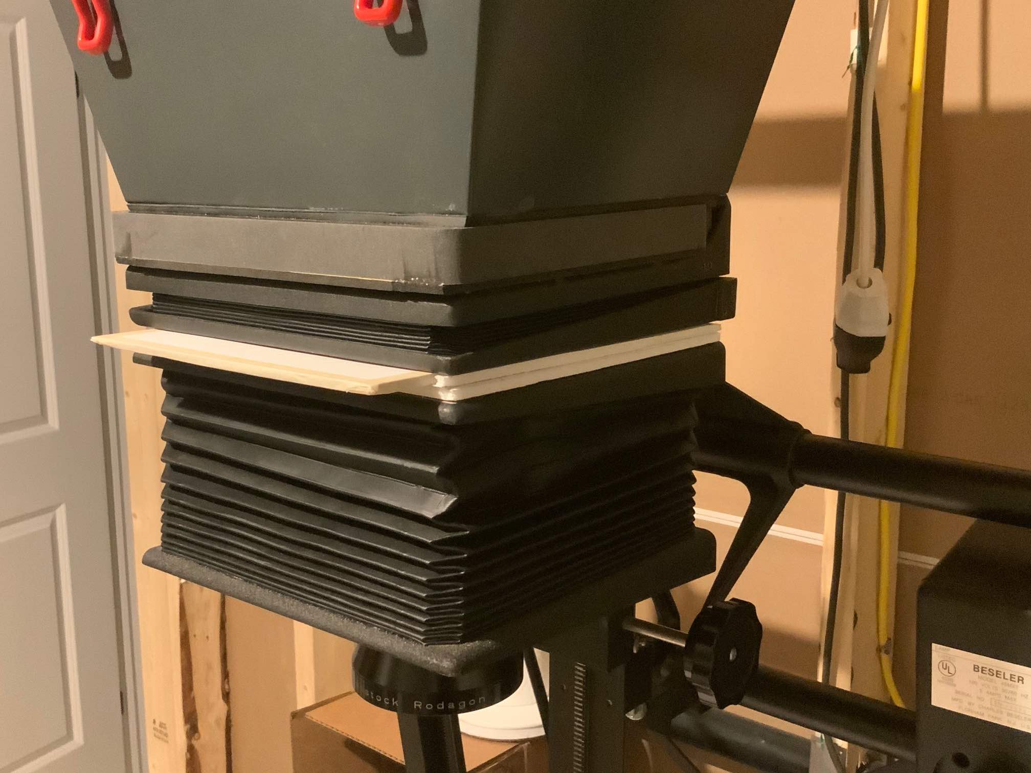

I just received my kit. Is ANR glass not needed? Assembled on the enlarger, just the soldering left. Looks great and feels good quality. There is some flex in the base plate however, will use clamps as a temporary solution.
i have had a email conversation with saus.
for information if anybody else has same issue:
occasionally the durst film holder bay is not in line ( parrallel) to the head carrier ( where the 8x10 kit is mounted)
simply place a suitable "O" ring under the carrier ( the large stainless plate ) and adjust until the carrier rest flat on the black19mm / 3/4" fiber adapter plate.
i had the problem with my old 138S and this little trick makes the job.
klaus
