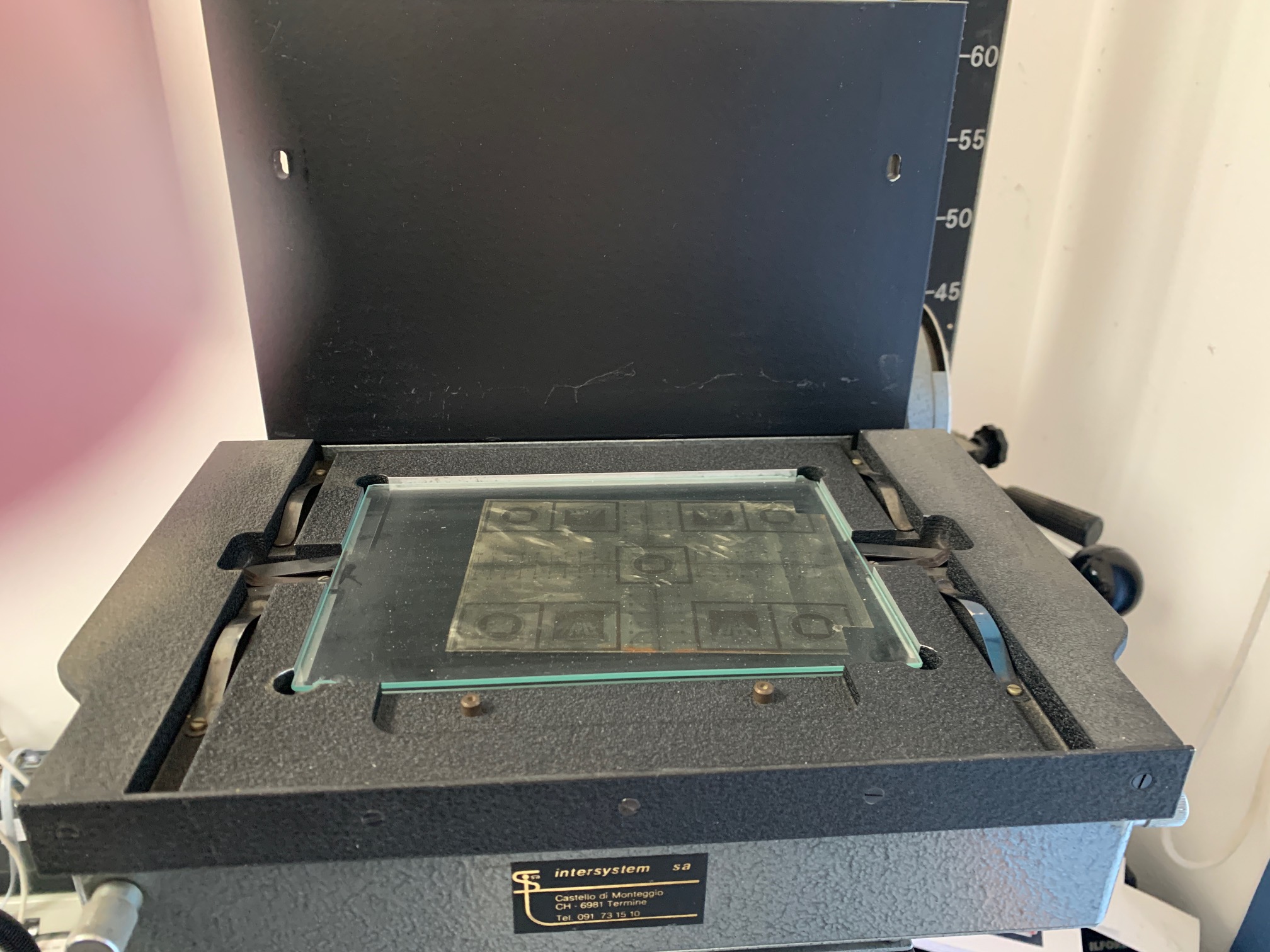

Hi Klauis, how do you extend the bellows coverage to 8x10, or do they already cover this on the Durst? I would love to convert my IFF Ampliator (see photo) to 18x24 but cannot see a way to get the extra bellows coverage. The size of the entire mount area is 18x24 but bellows coverage is way less. Thanks for any pointers here, Alan

Excellent, had to be really. Could you send me a side on photo please and major dimensions, I am thinking this may adapt to my IFF without too many changes other than the base plate, although using the adapter plates for using the 5x7 carrier won't work for mine. Thanks, Alan

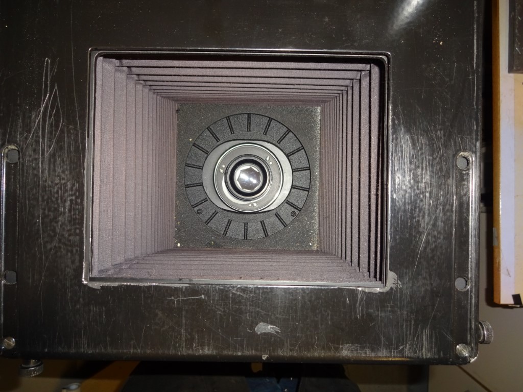

att. a picture on how it looks after the cutout is made,
( it is the durst film holder assy. bay you see, take off the durst light head and it is clear what i mean.)

You mention in your original post that included is a light seal to replace 8x10 filmholder when one uses the original 138 5x7 holder.
1- Do I understand then correctly that it is possible to use the original holder for 5x7 and 4x5 etc without reinstalling the 138 head?
2-If so, at which position is the neg holder then installed?
3- And looking at the pictures, to insert the 8x10 holder one has to unlatch the light source?
Thanks a lot
Michael
you get a mdf adapter plate that sits in place of the original 5x7 holder.
for smaller formats than 8x10.replace the 5x7 holder
very simple, and use the light head for all formats.
klaus
