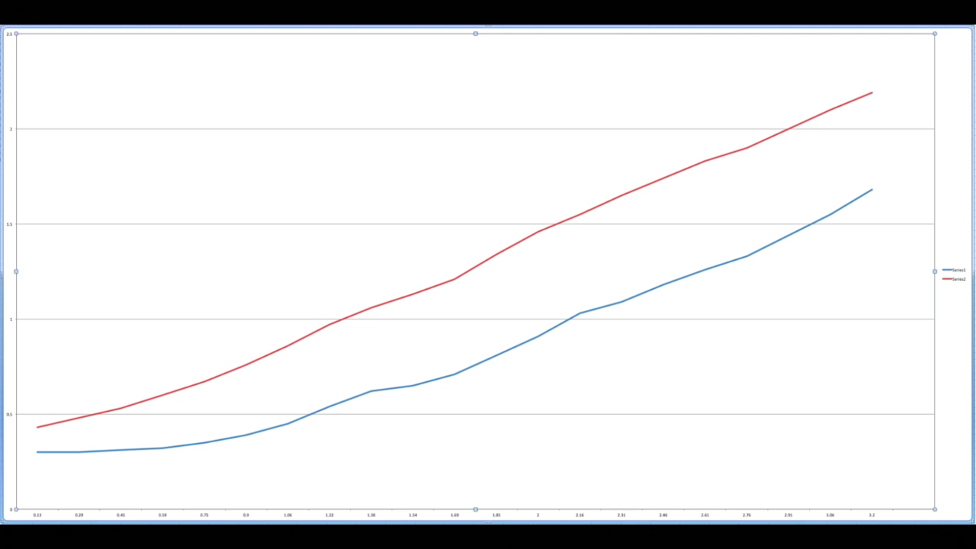

The following plots are from the YouTuber "The Naked Photographer". Here's his comparison of Fomapan 100 vs Tri-X and here's Kentmere 100 vs Tri-X.
Plot 1: Fomapan 100 in red, Tri-X in blue. Notice Fomapan's shoulder, giving poorer separation of the highlights --- I'm not saying it's "poor"... I just mean "less good".

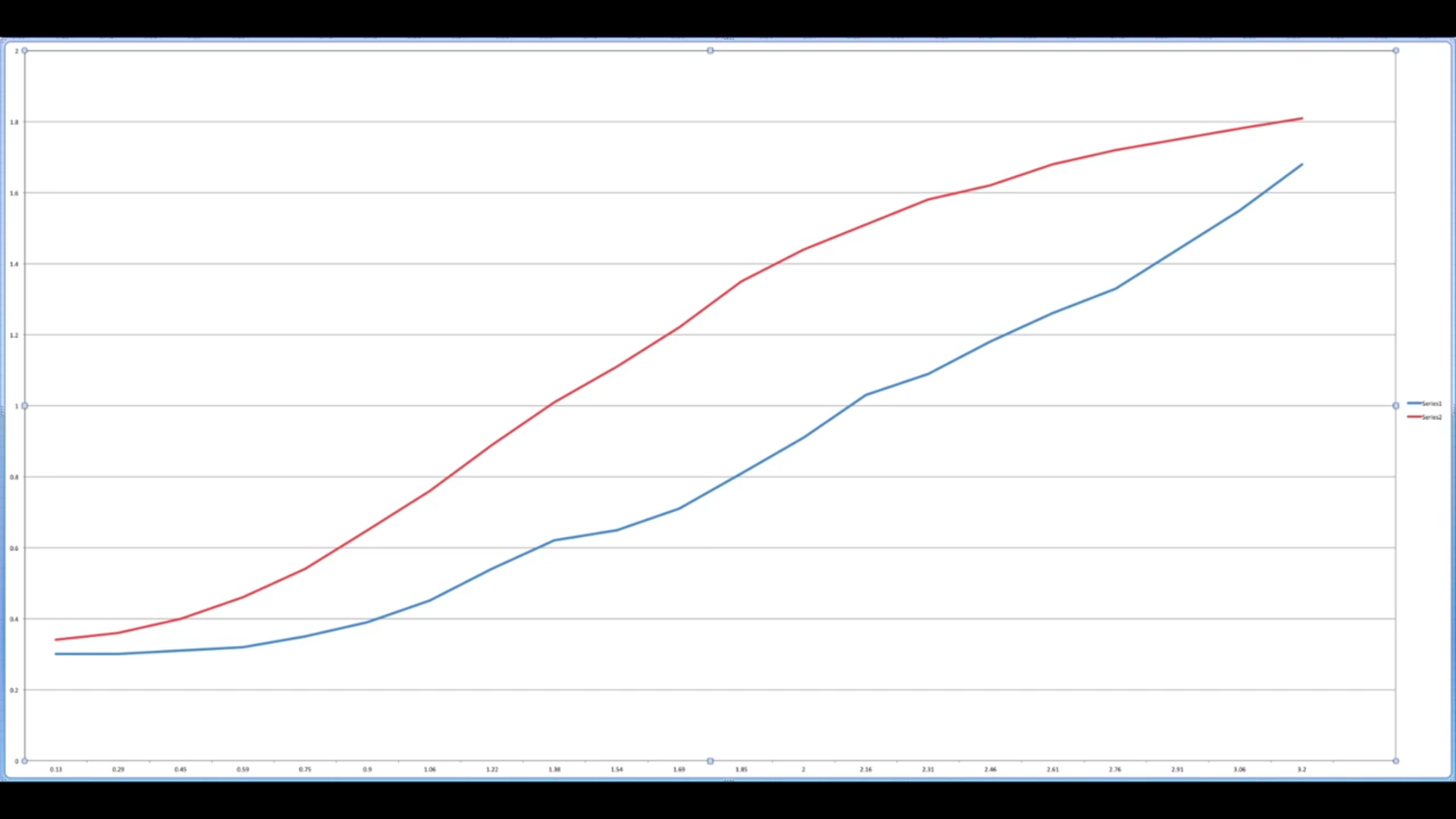

Plot 2: Kentmere 100 in red, Tri-X again in blue. Notice that Kentmere gives a near perfect straight line, with a fantastic toe, no shoulder, and steady tonal separation from end to end.

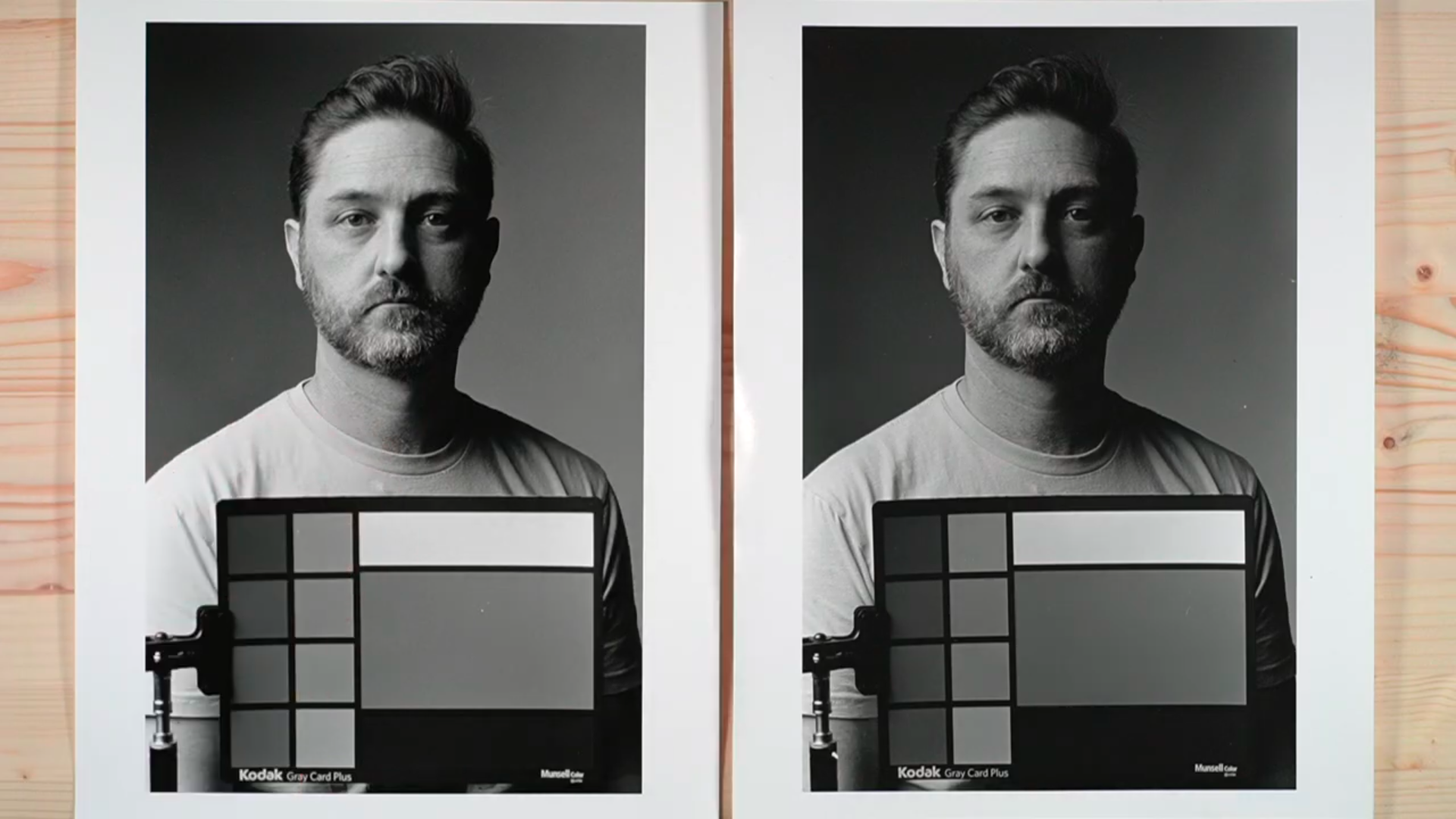

Next, here's the scene he photographed.
Shot 1: Fomapan 100 on the left, Tri-X on the right. Foma 100's spectral response is pretty good, unlike other Foma films which are relatively poor, but you do notice the dark flesh tone (top-left color box) being darker than other colors that should all have been equally dark.
(edit: Yes, Foma is overdeveloped; but we're talking about spectral response here)

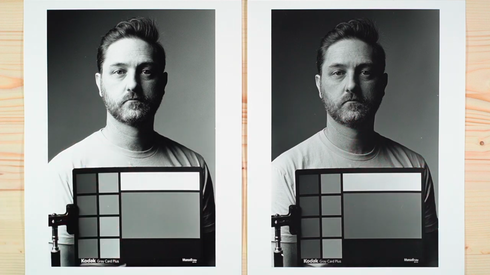

Shot 2: Kentmere 100 on the left, Tri-X on the right. Kentmere 100, like other Kentmere films, has a full panchromatic response, certainly no worse than Tri-X.
