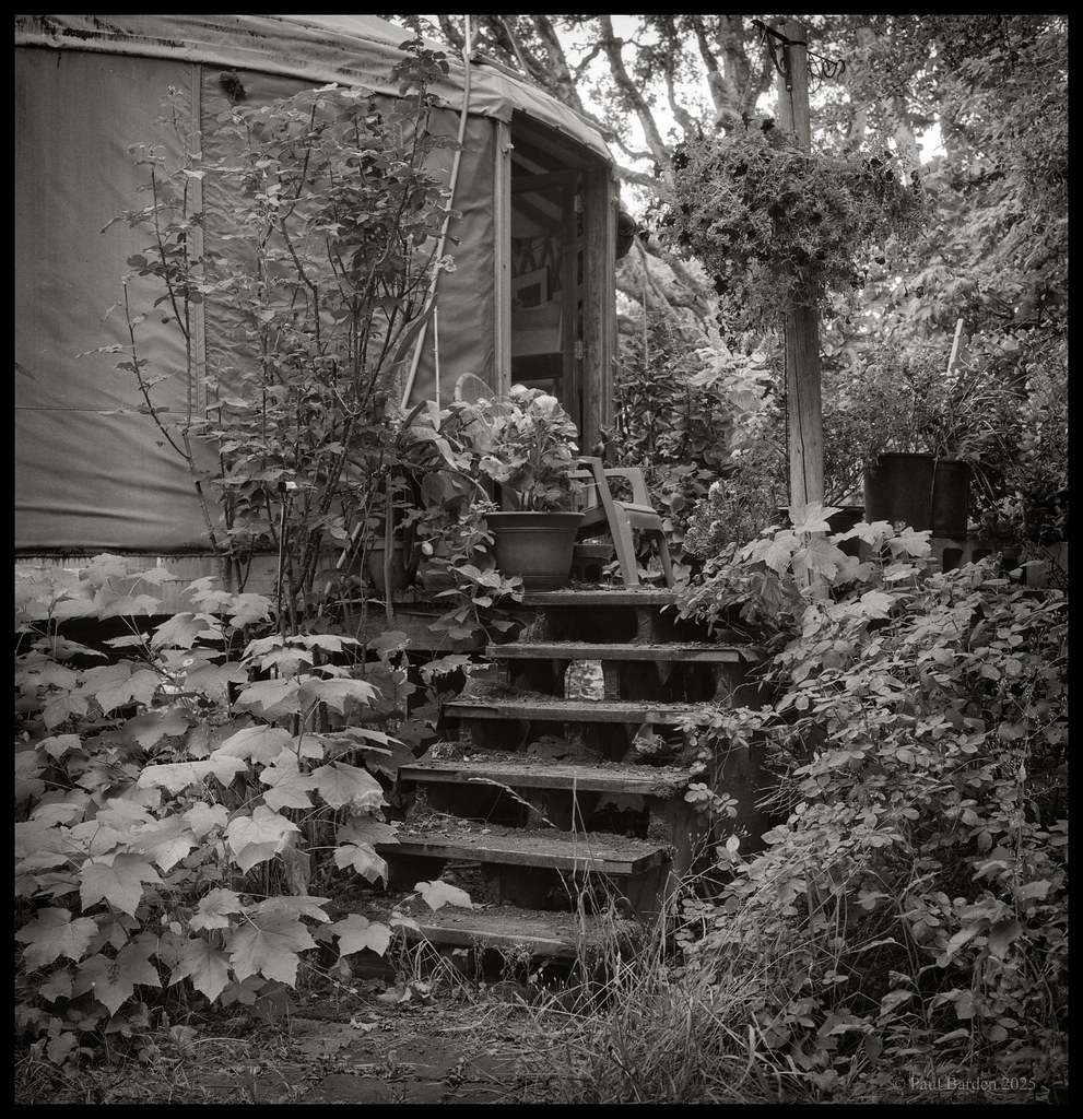

And I will say it: Kentmere 100 is inferior to Fomapan 100, based on my personal experience, yes. Fomapan 100 has better value separation, better sharpness and a better spectral response, and it also has better anti-halation properties.
I like both Fomapan 100 and Kentmere Pan 100. Have shot a lot of both. But usually have gotten better results with Kentmere in the last few years. This is Fotoimpex’s relabeled Kentmere 100 and I think the tonal separation is quite good throughout. Personally. And it’s typical of my results with it. I’m not arguing with any one, just expressing my appreciation for this film.
Kentmere Pan 400:
