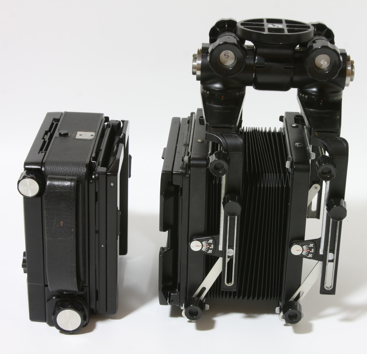

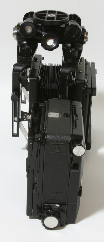

There are some monorail cameras that can be reasonably compact - the Toyo D45M & VX125, Linhof Technikardan and Arca Swiss Oschwald type cameras come to mind.
For example, here are two photos showing the relative sizes of the Toyo D45M and 45A cameras.
