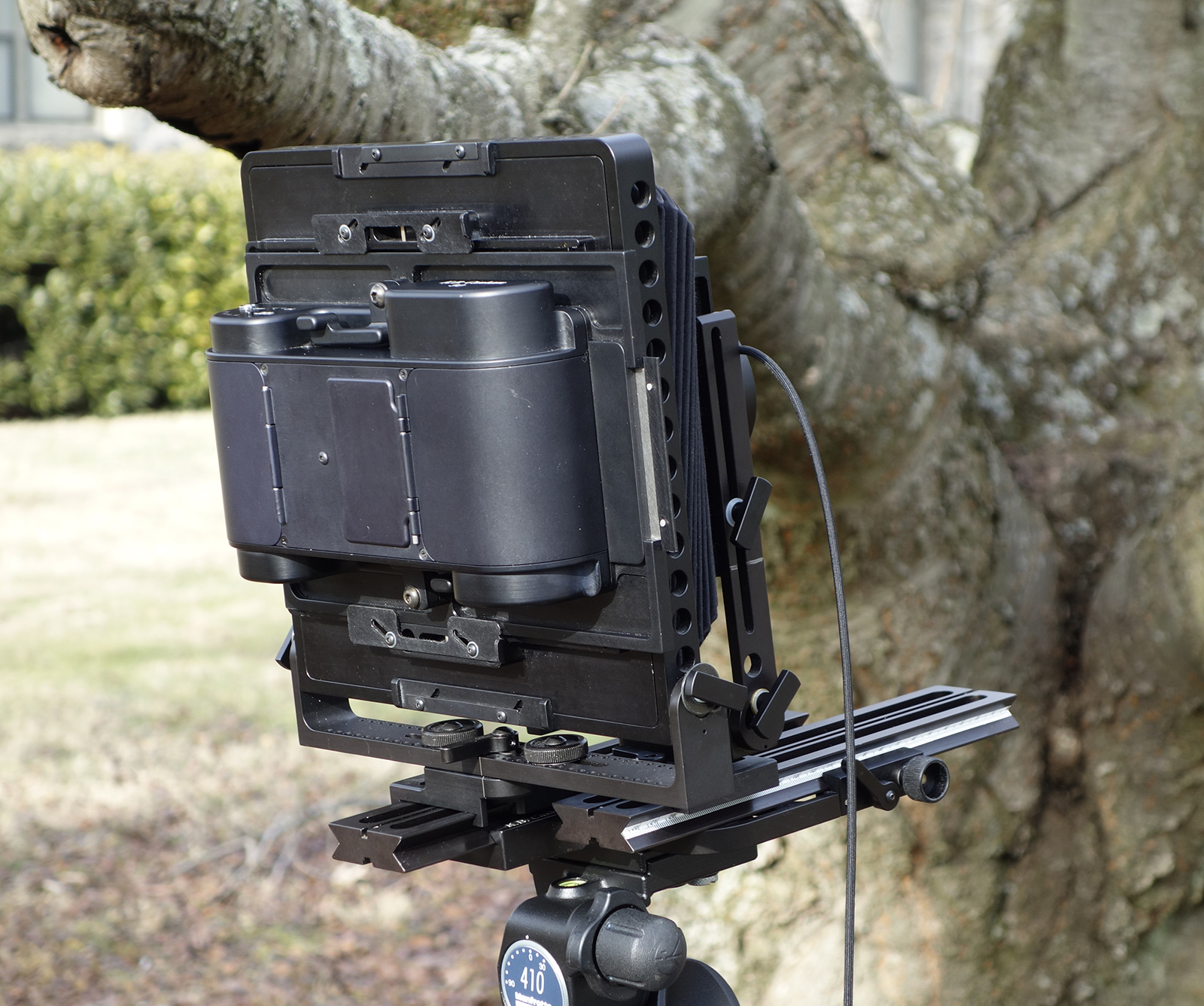

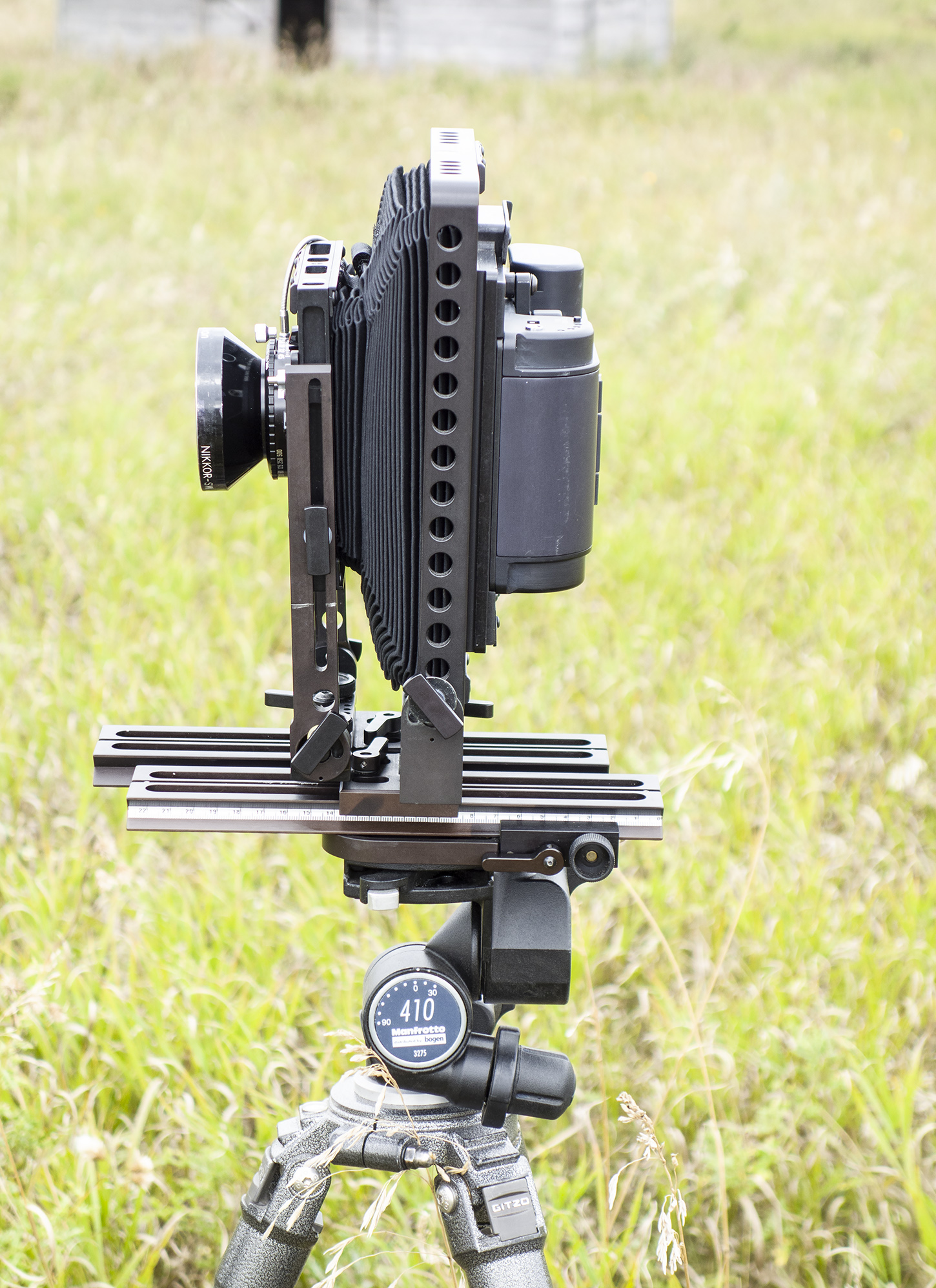

If someone tells you these aren't "field" cameras, but studio only, despite the "F" stipulation, well, I've backpacked with these at least 15,000 miles of rugged terrain.

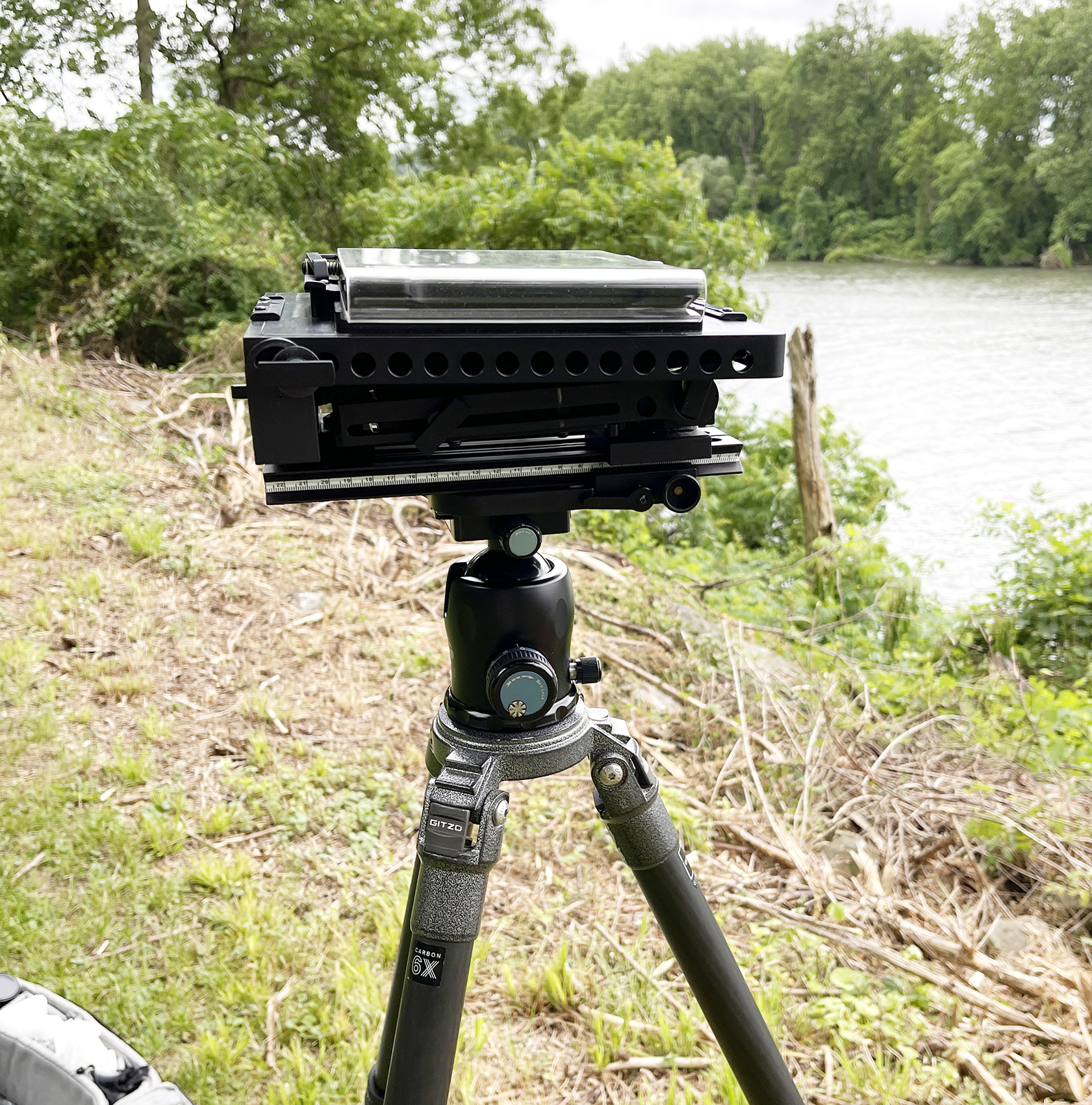

The Canham cameras (both wood and metal) are indeed folding field cameras. Here is the metal 5x7 MQC mounted on the tripod before unfolding...

That's what the Toyo View VX125 (and others) tried to be -- a Lightweight MONORAIL camera that you could take into the field -- for $6,000.
You be the judge. I'm not going to lug that puppy (SIX POUNDS!!!) up a 14-er!!!
P.S. That looks like a Gitzo Reporter Performance!!! Great choice for "FIELD" work, however that is defined.
