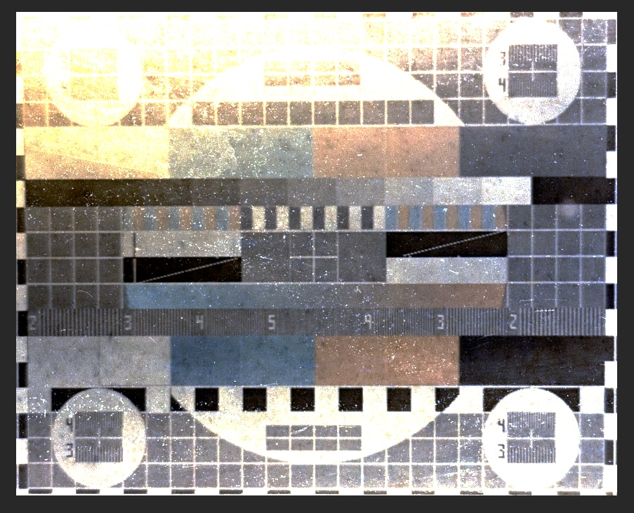

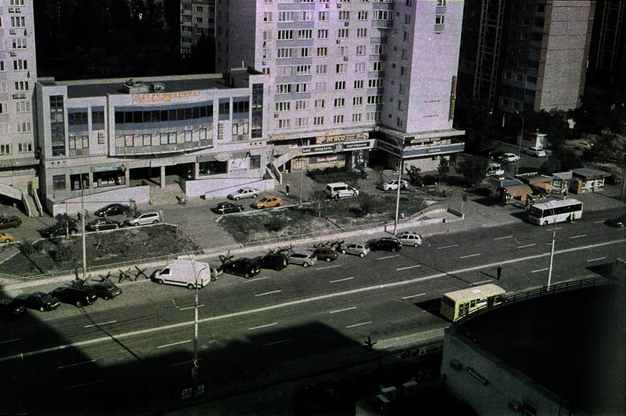

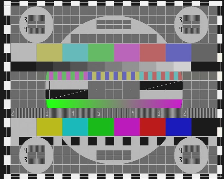

Parodinal+hair dye, to be precise, but anyways.
I was able to go from pic 1 and 2 results to pic 3, but while tweaking the process I made an observation that I'm not sure is true. It seems like this color developer gives more color at Ph≈8, lower than normal. Could this be true?
The final goal is ersatz-E6 made only with components that can be easily bought in a pharmacy or a local shop, and unlike in case with color negative, slide can't be repeatedly bleached and developed to achieve better color, and according to PE hydrogen peroxide will ruin slide film, so I'll need to get as much color as possible in one go.

More or less, yes. I did several re-developments while ph was 10-11(hard to tell, because the indicator paper turns black) and when I snipped a small piece and blixed it, there was almost no dye. Then I brought the ph down with sulfuric acid and just after one dev cycle there was more dye than after previous 3.
How should I compensate for activity? Increase the concentration?
All the color developers I know of are single-agent types.

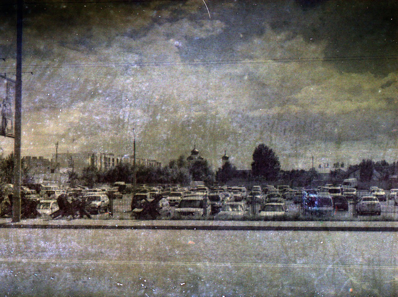

You see, PPD produces only cyan and yellow dyes, and 4-aminophenol produces mostly magenta and some yellow. So in order to get a more or less full color palette you need both.

You may get better results than I did with color print film, but there is some useful comment from others:

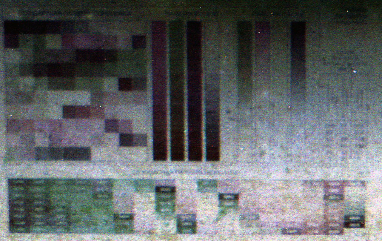

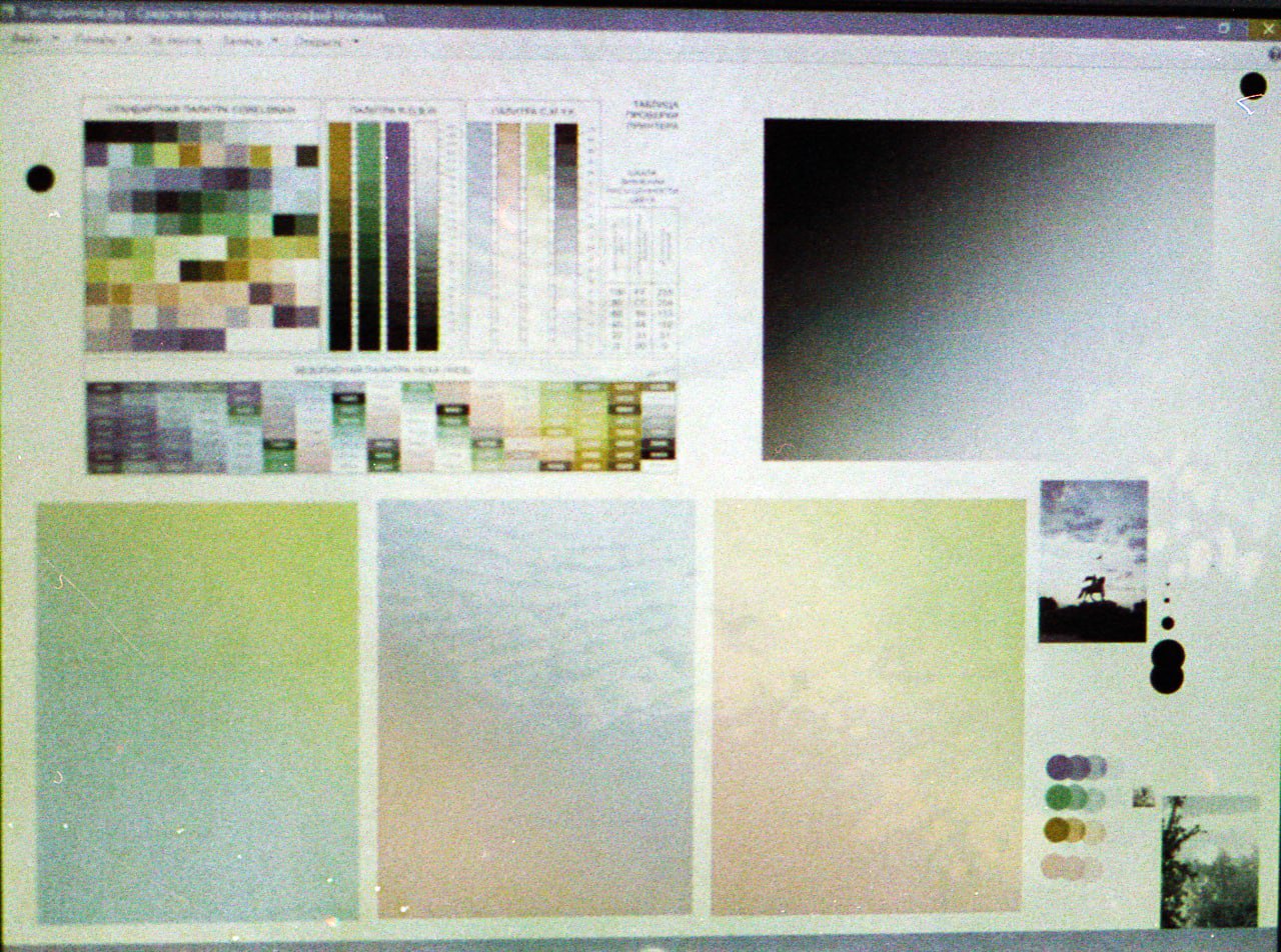

Yup. I'll need to add much more 4-aminophenol, because photos are too magenta, but I'll do it later. This process is too time-consuming. I tried developing one frame at ph 8 today tho, and it kinda looks like Lomo Metropolis when color-corrected.
