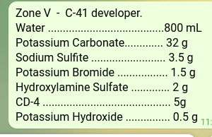

This is the simplified C41 recipe that I use, I find it the best recipe (in my opinion) as it is simple and the results are very consistent and very good.
This is the starting point for me.
You should tell me
What should I add to or exclude from that formula, so that I can follow your method?
This is what I understand..
I want this recipe to be the logical starting point and the beginning of the beginning.
Please modify this formula to suit your experience. Then you write the modified formula for you (according to your vision) by adding the other elements (PPD) and (4-aminophenol)
And I will prepare your recipe and make tests according to your suggested recipe.
You should tell me
And I will prepare your recipe and make tests according to your suggested recipe.View attachment 310955
You should exclude hydroxylamine, since it acts as a bw developer and lowers dye yield.
The recipe is
Potassium carbonate- 32g
Sodium sulfite- 1g
Potassium bromide- 1.5g
PPD- 6g
4-aminophenol- 3g
Water, bring up to 1L
You will need several color re developments to get a good density, so the first, black and white development is very important. What b&w developers do you have or can prepare?

Well, dye formation in our case is so poor that I think it's necessary to do whatever possible to improve it. In soviet books it is advised to exclude the hydroxylamine if dev. will be used one time.

Black and white developers available to me. They (Rodinal, Kalogen)
I can use either of them. I am waiting for your advice on choosing the developer that you created to comply with this process.
I think there are some things I got confused.
Allow me to ask some questions.
1- this process ,,
2- The films available to me are Kodak Gold only, will this work in that process?
3- Will this process produce a positive slide (E6), or will a negative film be produced?
4- Can this process be used instead of (C41) to develop Kodak Gold films to produce normal color negatives?
5-Is it necessary to use the re-exposure step?

I'd use Rodinal, 1+50, 9min, 20C. It will produce small amount of dye too, and we need everything :smile:
The films you've listed will work, yes.
This process will produce a negative
Well, the negatives will not be "normal" because the color rendition will be very different from standard C41. Thebcolor palette can be seen in the first post.
Yes, you need to re-expose the film, but several seconds under the sunlight will be more than enough.
You will have to use separate bleach and fix.
I don't know what "the great copper bleach is", but if it is a rehal bleach, it should work. Ferric sodium/ammonium edta bleach should work too.
1. BW dev. Rodinal 1+50 9min. 20°C
2. Fix (must be non-hardening, time will depend on what you use)
3. Bleach (time will depend in what you use)
4. Re-exposure
5. Color dev 5min. 20°C
Repeat steps 3 through 5 for 4 times, then
6. Bleach
7. Fix
Blix can be used instead of steps 6 and 7.
8. Base solution(sodium carbonate, for example, or weak NaOH ) for 5 min at 20°C
Then wash with clean water and dry.
