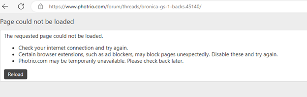

EDIT: Before someone comments, be advised, searched and got the message in the image... thus why the post. Thanks!

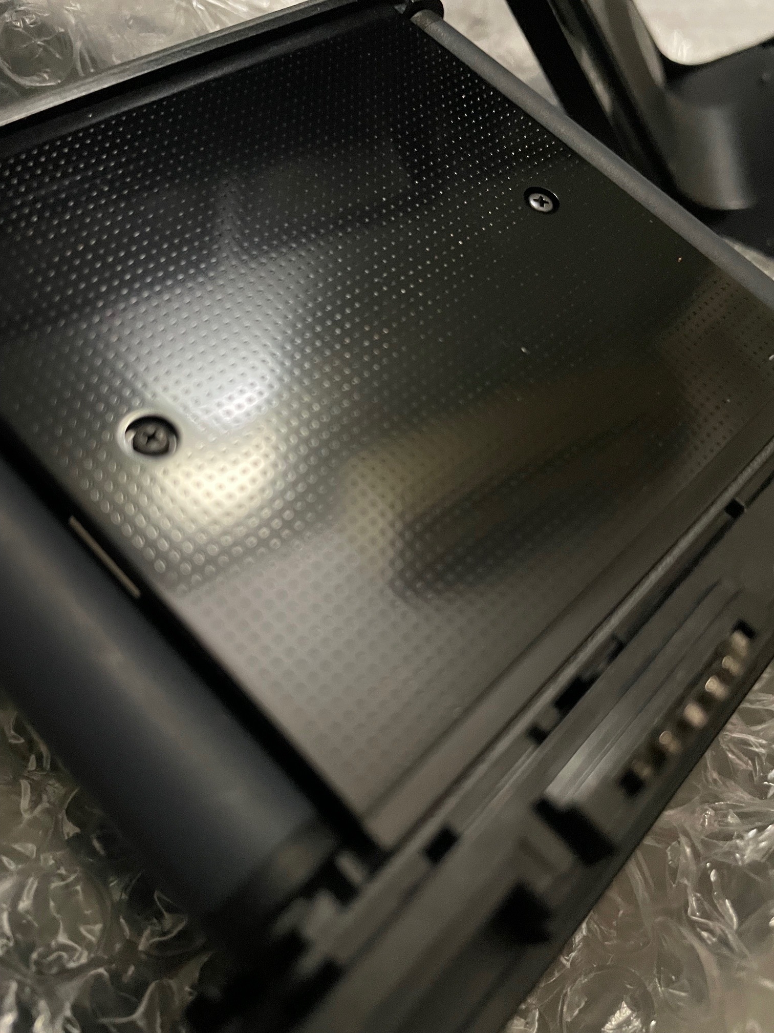

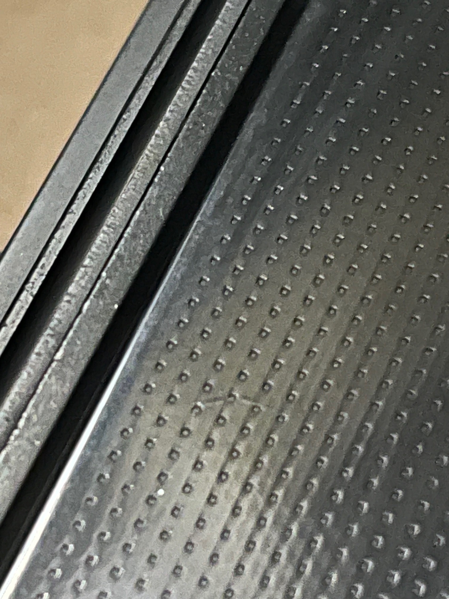

Hello Gents!
Image on the left is the 120 Film Back… flush all the way.
Image on the right is the 220…. Definitely a mill / step on the top and bottom of the plate.
So those two little steps are the ones that would require a small strip of masking tape applied? Thinking of using a painters blue tape, unless any other is recommended.

I'd be cautious about adding anything, given that it may interact with the backing leader and trailer papers - particularly the leader.
There is a theoretical difference in the location of the film plane because of the backing paper. This is probably about 0.1mm, which is roughly the thickness of backing paper. For average sharpness and a circle of confusion of 0.05mm, this would be covered by depth of focus for an f/2 lens. For critical sharpness one might want to do a little better.
However, there aren't any really fast lenses for the GS-1 system (due to the modest size leaf shutters it used). The fastest lens is f/3.5. And people often stop down in medium format anyway to get more depth of field.
So IMO you should spend your effort testing the frame spacing, which may be a little irregular, before spending time putting tape on the pressure plate, which is probably going to be near unnoticeable unless it comes off and gets stuck to your film.

What I said was confusing. The theoretical difference is because the center of the pressure plate on the 220 back is raised (raised beyond the edge that contacts the outer rails). It is raised by roughly the thickness of the absent backing paper. Which is 0.1mm, and likely difficult to detect in practice in terms of focus offset. Other issues such as film transport can be experimented with by the user.

The tape would be in the milled channels of the pressure plate. That section butts against the outer rails, there is no film or backing paper at that location. And given that the pressure plate is stationary, I don't think there is a risk of the tape coming off.
Because of the milled section, there will be 1) an additional strain on the winding system caused by the thicker film (maybe insignificant); 2) a potential bulge in the film: not at the film rails where it is constrained but everywhere else.

I'll revise my prior statement. As @MattKing pointed out there should be no difference in the film plane location due to the milled pressure plate. Most likely the plate will lose contact with the outer rails due to the thicker film. The only effect is added drag, with potentially better film flatness?
