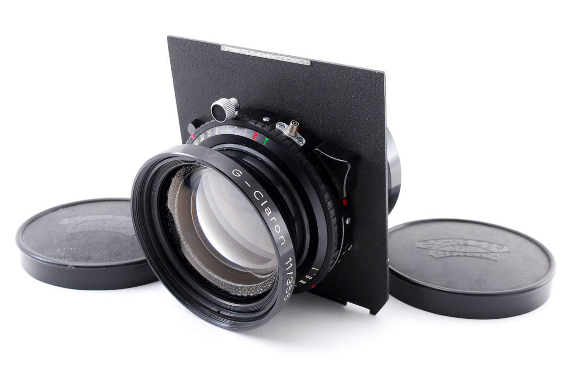

I know there are some that aren't on that list, so I'm not doubting the existance of a 250mm. I still kick myself for not buying a 355mm ƒ11 on eBay a couple years ago. You lose 2/3 a stop of light compared to the 355mm ƒ9 but you get a much smaller lens in a Copal #1 shutter.

355 in a smaller shutter? Never heard of that. It must be a private modification. The Fuji 360/10 A series lens is very similar, except multicoated and in a no. 1 Copal shutter standard - ample 8x10 coverage, but dicey for 11X14. It has always been my opinion that the significantly greater coverage of the 355GC is probably due to its avoidance of mechanical vignetting due to its larger no. 3 shutter. But what is the image quality in those nether regions of the image circle? It's hard to say, because people who use that degree of coverage seem to all be contact printers, who don't need high resolution for the print to look great.
No they're real. the front lens element on the outside says 355mm ƒ11. There was some discussion on LFF. Then I came across one on eBay from a japanese seller, and it was definitely designed fro that size. I'd definitely take a smaller 355.
EDIT: Here is an image:
But is it the same optical configuration as the standard model? - or different, as in the dual option 270 case? That would be my concern. The standard 355 simply won't fit into a smaller shutter (I have the schematics); it would have to be different from the get go. So, unless someone here owns one, we have no idea of its real-world coverage. An intriguing question, for sure; but since I already use and love the 360 Fuji A, I'm not a candidate for purchase even if one of those mystery GC's does show up again.
The posted example sure has its fair share of "Schneideritis", but that's rather common with well-used GC's, and nothing to worry about performance-wise.
Yeah, I would assume that the IC would be reduced, but for 8x10 purposes it would be more than sufficient. I've never used one. The weird 270 I'm aware of was marked as a WA G-Claron, but this one doesn't seem to be, so I expect it is a normal plasmat version, but they are uncommon enough that its hard to say without one in hand. As I mentioned--there was a thread on LFF about the 355/11. Anyway, this is a huge digression from 210 lenses, for which a G-Claron is still a good (and still affordable) option along with some of those hard to find Graphic Kowa or Computar lenses if you can afford one. The early Fuji W lenses will work as well with about 3cm of movement total at infinity (15mm up and 15mm down from center)--at least based on the spec sheet.
