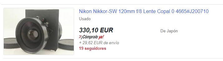

Let me go a bit Out Of Topic, for the future...
There is a lens still I don't own but I would when I deserve it enough... I'm to get:
The Nikon SW 120 barely covers 8x10, being a really short focal for 8x10, I don't understand how such marvels can be that cheap... the SW 150 would be better for 8x10 but they are very scarce and expensive.

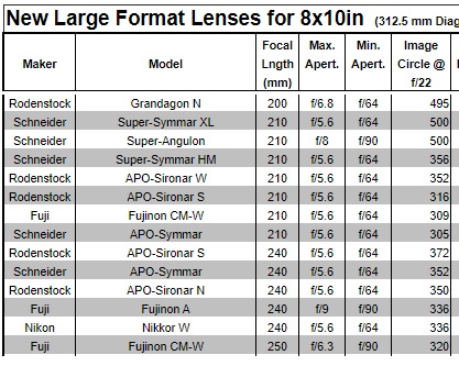

Many 210mm lenses available for use on 8x10 format and of course, no other focal length used on 8x10 film gives the same angle of view at infinity as a 210mm lens.
This is a list I compiled about ten years ago. I don't know of any new ones designed since then.
