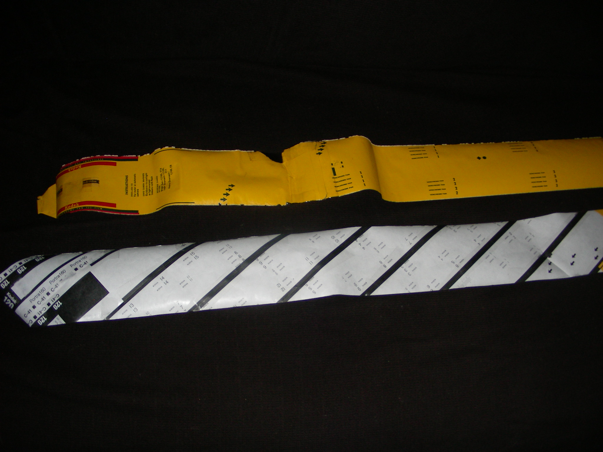

Biggest issue is re-rolling backing paper. It's degrading fast, I wish ilford was able to make 127/116 backing paper rolls...
Or you could do this.
Top = Kodak's; bottom = mine.
Just gotta make sure you cover the gaps between the slices with opaque tape (or skinnier slices of backing paper). Helps to have a local lab who saves it for me. Not sure how I'm gonna get the frame numbers in the right places yet.
In any case, 127 is unnecessary, you can just slit down 120.
(edit: kind of looks like a necktie, doesn't it?)
