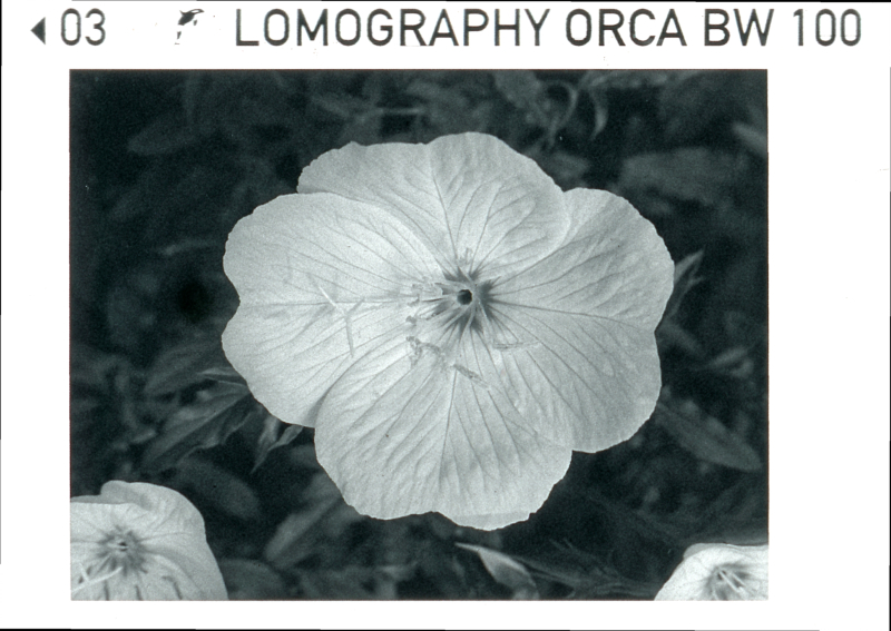

I'm still getting those pinholes on Tiger and Orca. Of course random in occurrence and size/# but still happening.
Fyi my Lomo Purple was actually Lomo Mistaken Identity where due to some mfg mixup, the film is either Purple or Metropolis, no matter what the film rebate says.
So maybe this one was Metropolis even though it said Purple?
Oh great. I'm probably going to actually get the Purple knowing my luck.
For reference, the Tiger 200 I've got at the moment is a 3-pack with a production date of 9/2021 and expiry of 9/2024. I'm not sure what the provenance of that spotty Orca was, but I wonder if it has anything to do with the fact that Orca is only available in individual cassettes. Perhaps to mitigate the odds of all the films in the pack being effected.. but more likely just some baseless internet speculation on a Monday afternoon.

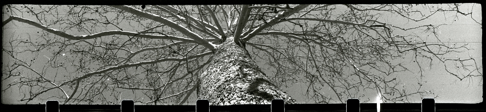

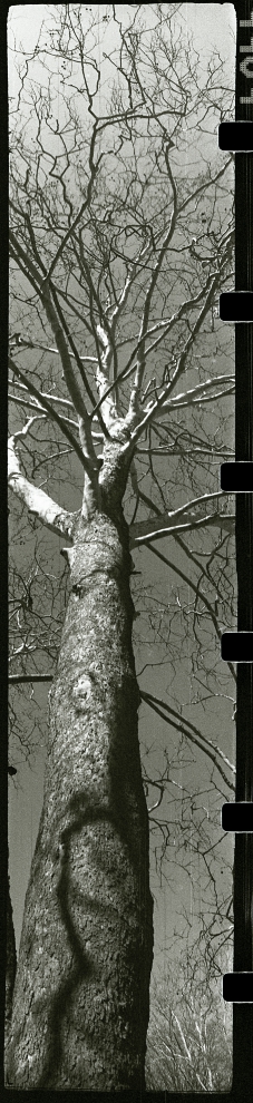

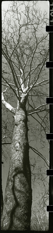

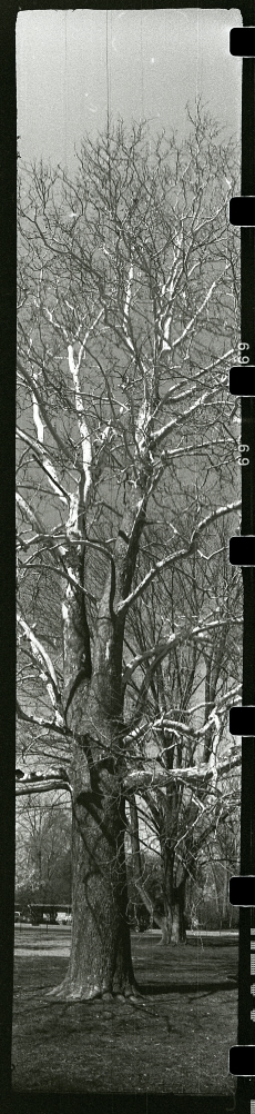

I exposed the last of my preloaded Double-X cassettes this morning in the two most ornery subminis I've got: the Steky & Viscawide.
Viscawide 16 ST-D, f/16 'H'
Double-X, D-96 stock 8'
The camera feels a bit chintzy, is an ergonomic nightmare and scratches the hell out of film, but the glass is legit... not to mention the novel format. I've just got to try to break myself of the bad habit of using it portrait orientation.

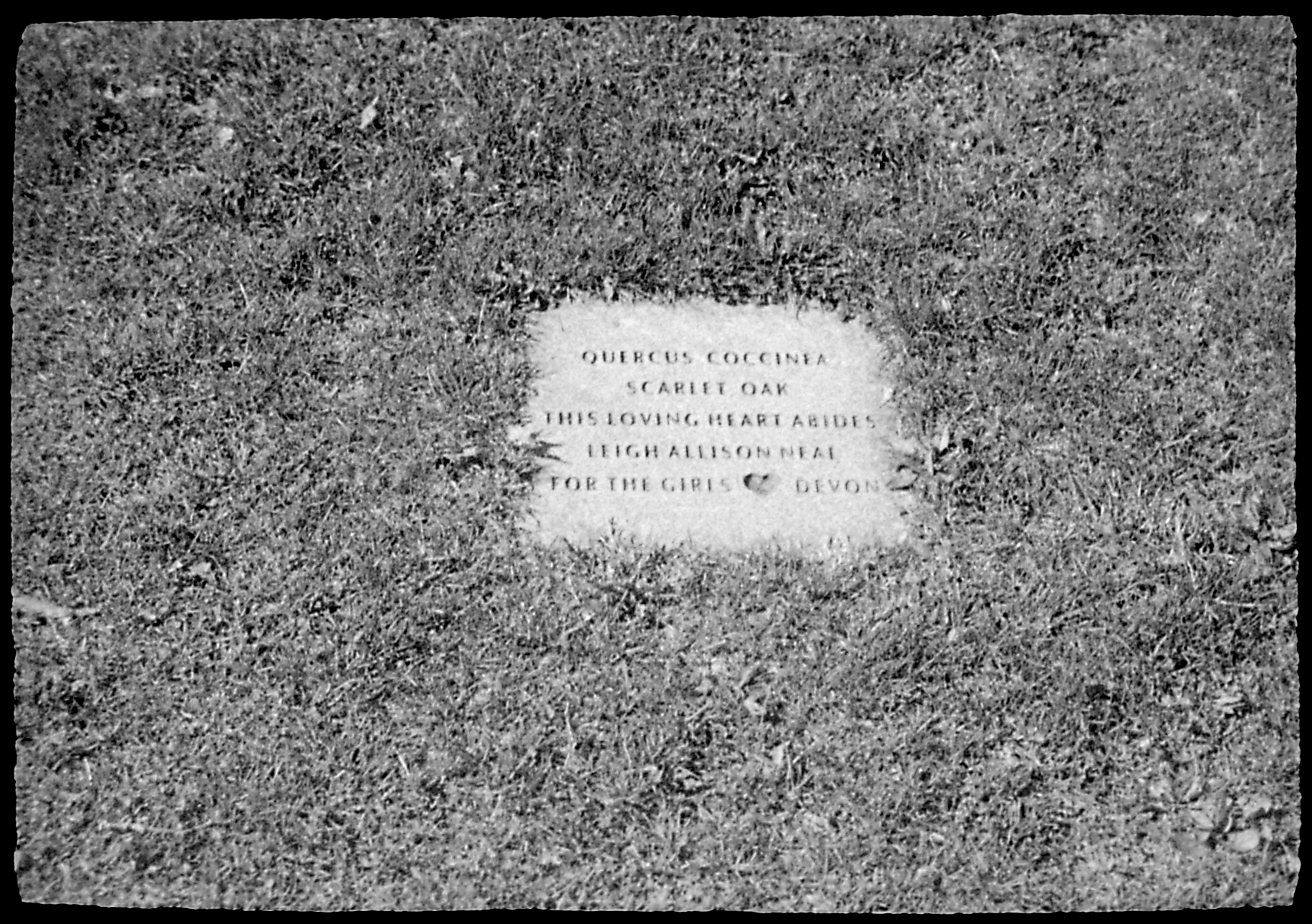

I shot the Steky at the same time, metering, film, and development (f/16, 1/100s with yellow filter) and the negatives came out cooked. Serviceable results, but between the density and significant bowing of the negatives its gonna take more than a quick scan to get a fair representation to post here. Stay tuned.
Edit: I had to bust out the 110 lomo digitaliza holder to keep the Steky's film flat and (mostly) unbowed. The Steky cassettes introduce substantial curl if you leave the film in them for any significant period of time.
Steky II, f/16 "1/100s" with yellow filter
View attachment 335516View attachment 335517

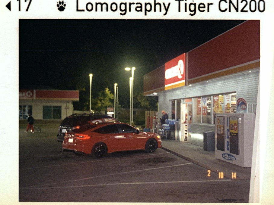

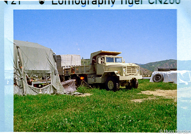

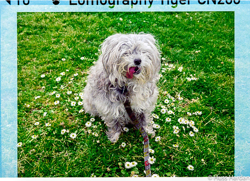

Pentax Auto 110 and 23 year old Superia 200 vs fresh Lomo Tiger. Pics taken at the same place, w/in 10 minutes of each other.

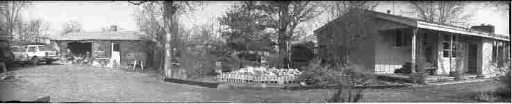

Here's a shot I took with a Viscawide:
The unfortunately named Viscawide STD

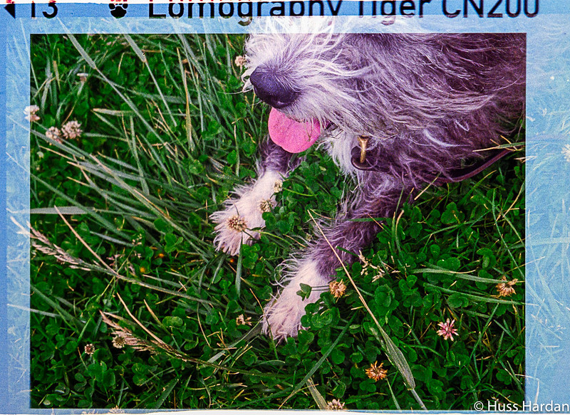

Great shots of the dogg-o. 110 SLRs are a thing of beauty.
