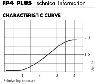

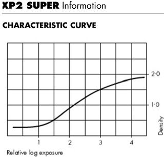

Might as well keep shooting FP4 if he is going to develop in B&W chemistry.
This is XP2 in C-41 though.
But not miles off from FP4.
