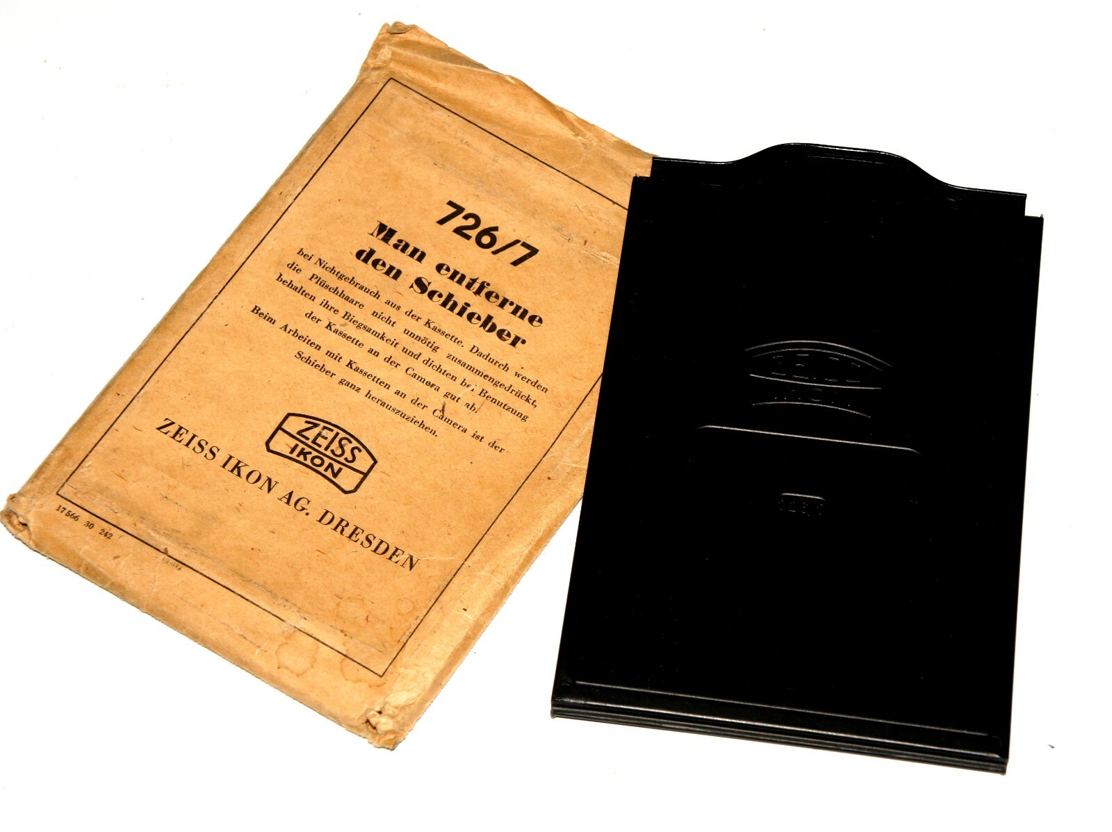

The number behind the / indicates the size, i.e.: 3 = 6x9, 7=9x12, 9=10x15 and 11=13x18 - the numbers 6 and 12 and 13 I don't know.

During the long production period Zeiss Ikon changed the naming convention of the Ideal (and other types of folding camera's). The last range of camera's had the following numbers (these camera's had more rivited parts in stead of screws/bolts):
camera > plateholder
250/3 (6.5 x 9cm),
250/7 (9 x 12cm), > 726/7
250/9 (10 x 15cm) and
250/11 (13 x 18cm).
The earlier models (just after the merger with ICA in 1926/27) had a different numbering taken from ICA:
111 > 726/3 (6.5 x 9cm),
246 > 726/6 (9 x 12cm),
225 > 726/6 (9 x 12cm), older model camera: 205
325 > 737/12 (10 x 15cm),
385 > 737/13 (13 x 18cm),
651 > 726/4 (6x13cm stereo) and
650 > 726/10 (9x18cm stereo).
(the Ica catalogue from 1919 mentions plateholders with the number 727/6 for the Ideal 9x12 cameras (the 205 and 246), but this seems a misprint since the pages with the different holders only mention nr. 726/6.)
The 225 and 246 series for 9x12 format take the 726/6 plateholders (728/6 for filmpacks)
I don't know whether the 250 serie takes the same format plateholders as the early series, but to go safe I would opt for the 726/7 holders.

It is secure for sure 726/7 and 728/7 but more seldom.

Better do not buy filmpackholders, since filmpacks are not made anymore and they can not contain sheetfilm.
Btw the filmpack holder for your camera has number 728/6 or 728/7. Your camera does not take slide in holders :-(

Better not start with glass plates (at least I wouldn't advise to use them at all - the ones now made are not very sensitive and might not have even filmlayers; and further are very pricy). Better start using sheet film; you can buy them quite easily. Please note that for sheet film you have to use metal film inlays (sheats) in your filmholders that will hold the sheet film (see below pic) and try FOMAPAN film.

Do you know which holder's code number can use FOMAPAN? Because I think Ikon was giving an adaptor (like your photo726/7 to make it suitable for film use.
So maybe you mean 726/7 with the seat inside...

The metal inlays are very thin and are a compensation for the thickness of the glass plate. Plateholder 726/7 takes inlays for 9x12 film and FOMAPAN will fit the inlays.
I have an Ica 225 and a Zeiss 250/7, and a dozen plate holders (don't recall offhand if they even have Zeiss or Ica number on them) that all fit both cameras, as does the one ground glass panel I have with glass in it. As far as I've been able to tell, the mounts on the cameras are dimensionally and operationally identical.
