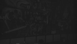

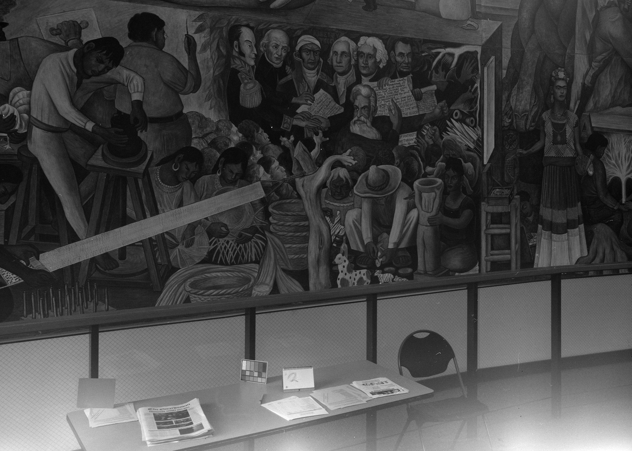

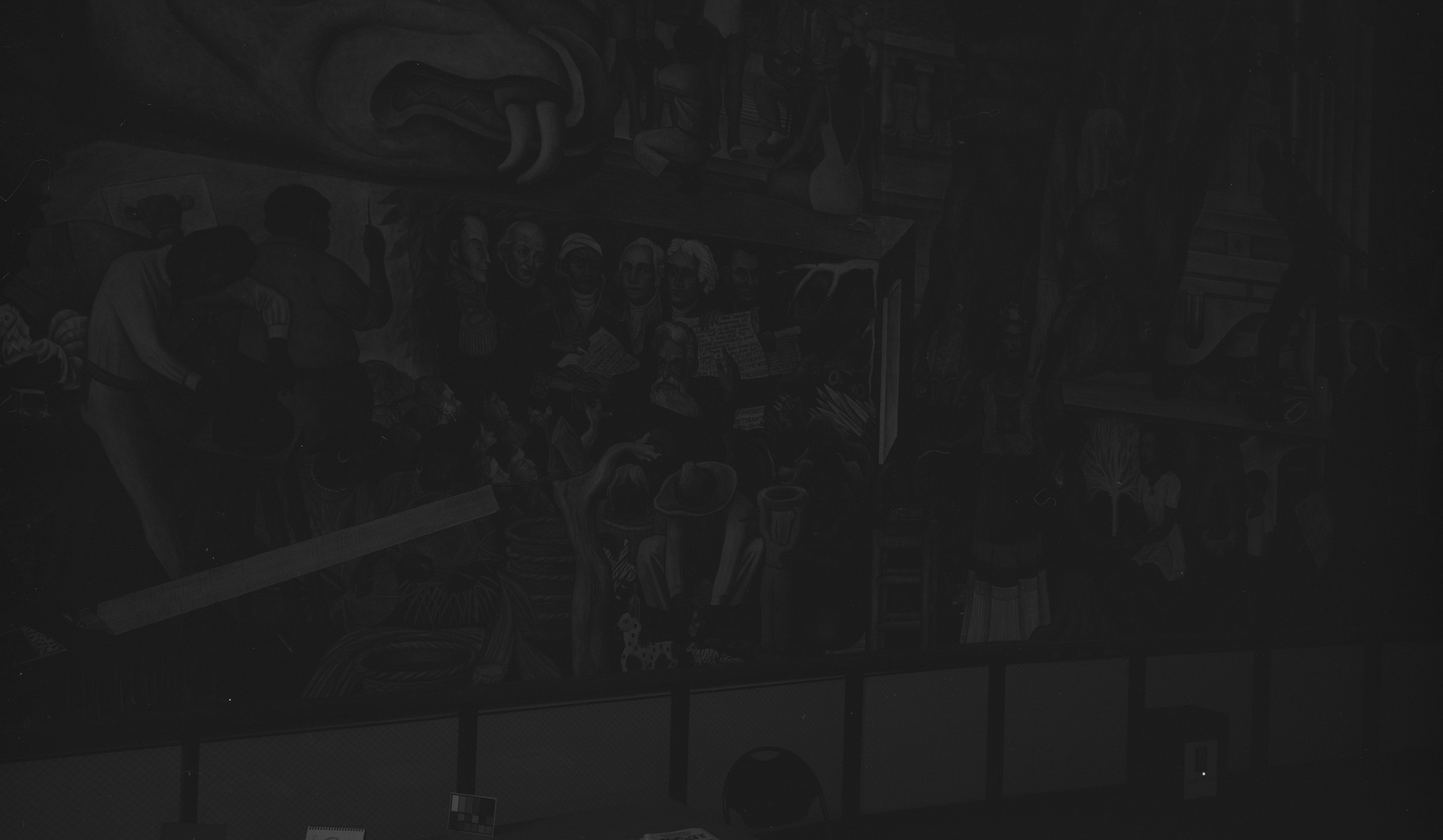

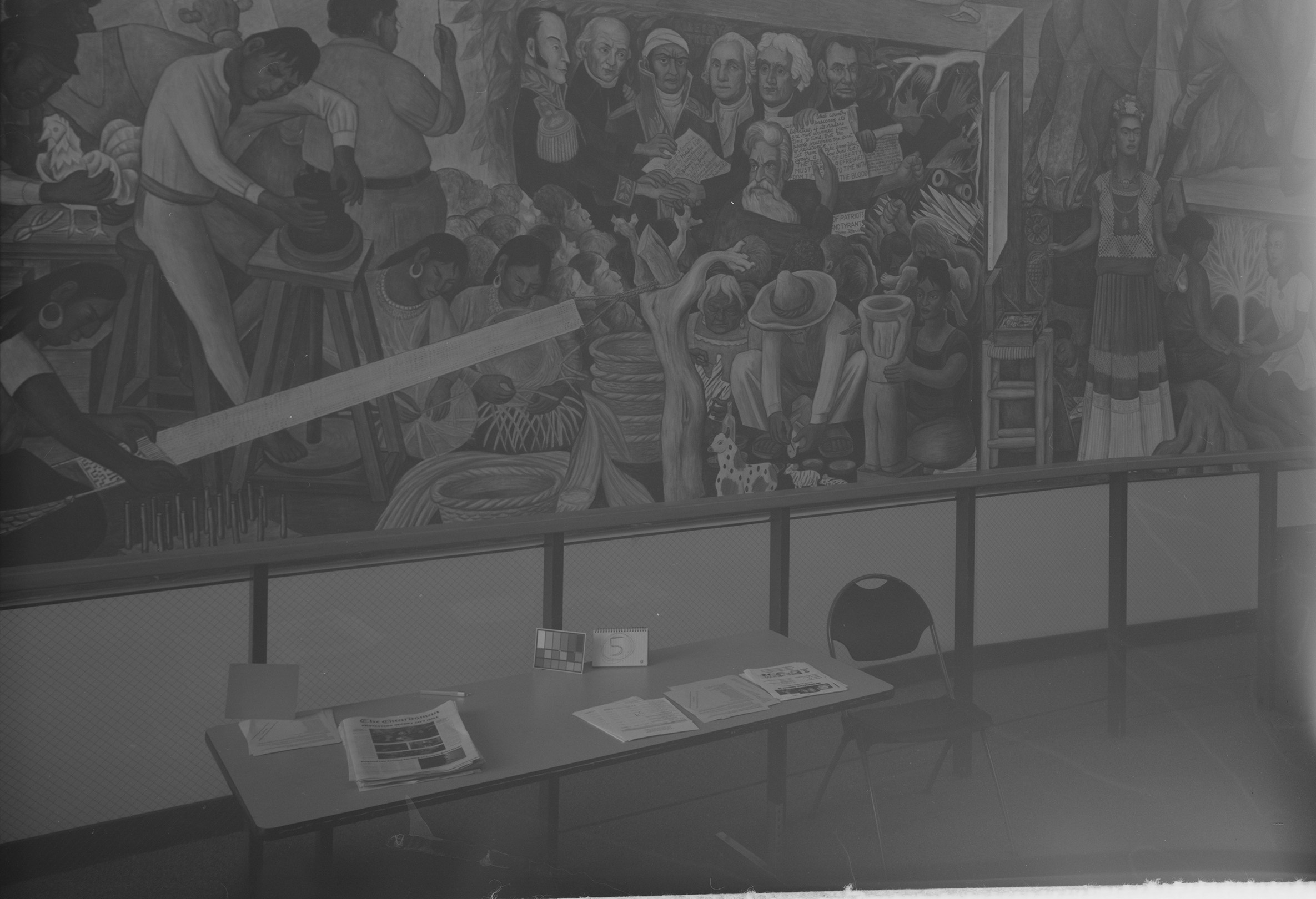

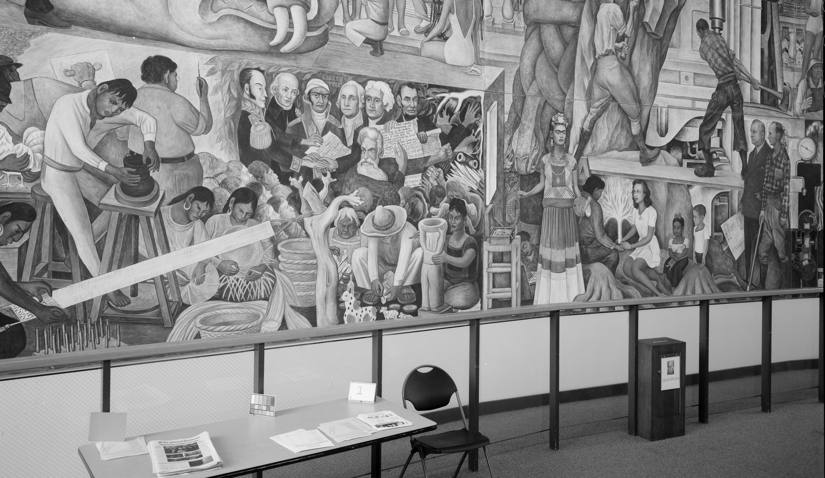

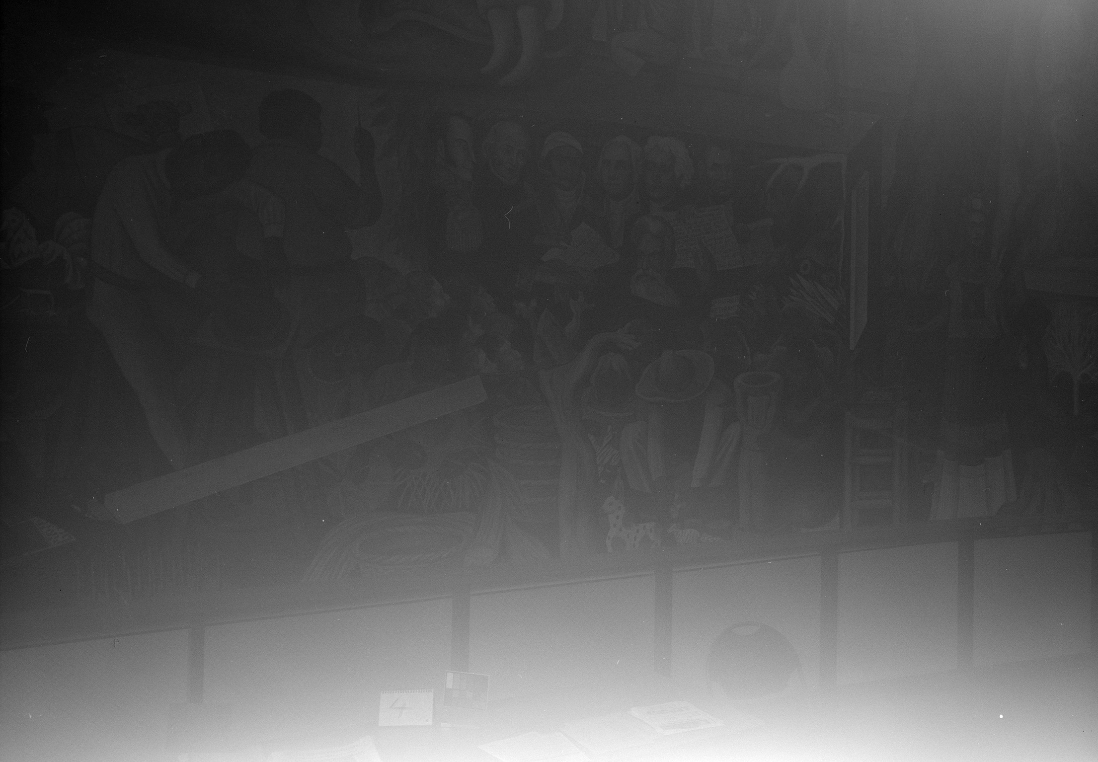

OK I ran a series of tests. I had 6 sheet of Delta 100 I exposed using technique described by @David Allen using my press camera and 90mm lens, because it has the newest and probably most reliable shutter, a Seiko from the '80s. I had 12 shots remaining with the same film in my Leica IIIf nickel elmar so I conducted Ansel's version with those (it requires more exposures). Also Fred Picker's book just arrived; I have 2 more camera systems to test. Will post once I have some results to share!

OK so I've completed the Zone 1 exposure and development on 4 camera systems.
Picker & Adams agree at this point that you check these tests with a densitometer. Ansel says "the net density value closest to 0.10 represents the desired Zone I exposure." Picker says "find the negative with a density of .08 to .10 above film base and fog or send the film to me if you can't locate a densitometer."
Everybody agrees not to bother to proceed with the rest of the tests without nailing down zone I. So, I'm kinda stuck. There are a number of labs in the area who have densitometers but not many people around who know how to use them! My best lead is a photographer who took a zone system class and frequents the same darkroom space.
From what I'm reading, there are just way too many variables when trying to use a scanner, so plan B is out.
I kind of feel visual inspection of both proof sheets and flatbed scans suggest it *seems* to be somewhere around 5 1/3 stops under what the film is rated at (Delta 100 developed 6m in HC110, proofs using #2 contrast filter following picker's method of determining pure black print off film base+fog). That is, I can make just make out enough on the gray card that it's clearly distinguishable from true black but not sure where that is on the density scale without a reading. They do both roughly agree on that point. Caveat: it may be a tad lower still, my proofs were on RC paper, whereas I usually print FB.
Optimum = the negative which requires the least dancing around in the darkroom... I want the negative to print easily on paper which has a contrast of around grade 2, more or less.
Thanks Doc W and markbardendt for that clarity. This gives me hope that a visual method will be viable.

@David Allen Yes in fact, I have been following your method. With some caveats
1. Find a scene with with a good range of tones
2. Using the box speed, meter the darkest area in which you wish to retain shadow detail
3. Move the camera so that you are only photographing this shadow area
4. From the meter's reading close down the aperture by 2 stops or increase the shutter speed by two stops and then expose 6 frames at: the given exposure then +1 stop, +2 stops, -1 stop, -2 stops and -3 stops less than the meter has indicated
5. Process the film
So right away I'm confused as to why "meter the darkest area in which you wish to retain shadow detail" - isn't the purpose of the test to determine how much shadow detail you can get (rather than a precondition)? Seems like Adams and Picker suggest using constant tone wall or gray card. Any case, I'd hope to be as little as possible at the mercy of variances in the subject matter and would probably want both - gray card as control, as well as range.
Image 1: box iso 100 at meter 1/2 f/11
Image 2: close down 4 stops, still f/11 now 1/30
Image 3: 1/60
Image 4: 1/125
Image 5: 1/15
Image 6: 1/8
I did some light photoshop to adjust levels. Also I seem to be having some camera problems on these images I won't go into... may be better to show sets of images from rolls.
