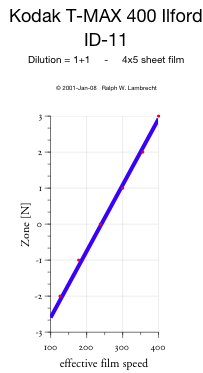

The EI changes with the development for the film. Attached is a sample table I use for Tmax-400 in ID-11. Check out the graph in the bottom right-hand corner.
  • Tmax400 ID11.pdf
After rereading the above posts and thinking about the way I use Fred Pickers process, I guess I use the EI I found from testing and place values where I want them to fall in the final print. Sometimes this requires expansion (N+).
N+ tests let me know what a tone will look like in the print with the expansion through increased development. If I'm reading your chart right, you indicating I've effectively changed the EI by increasing the development time to reach N+1?

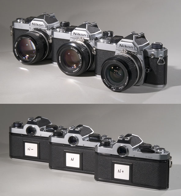

The idea of exposing for the shadows and developing for the highlights is good for large format, but is there away to accomplish this with 35mm, where you have 24 or 36 exposures that are all different?
Sound crazy at first, but I have three Nikon FM bodies for that, nicely labeled N-, N and N+. A used 35mm body is cheaper than a MF film back!
I just wanted to add my NikonFM Zone System line-up, which ended up being cheaper than a single Hasselblad back (comparing used vs used).
