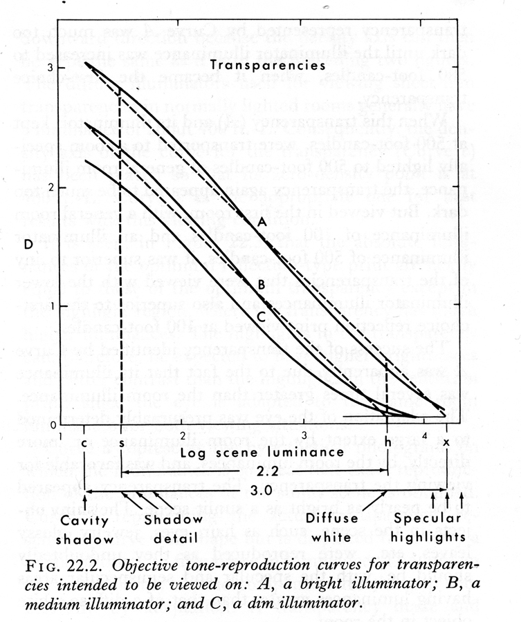

Stephen, I am suspicious that the scale marked "reflectance" covers a range of 100%. I've always assumed the scale of subject luminance range exceeds 100% by at least 2 stops because it represents subject in main light and subject in shade. Is that scale "reflectance" on the print?
Bill, the range covers the statistically average log 2.20 range. Like Holm wrote, it is from diffuse highlight to shadow detail and not specular highlight and accent black (which do exist). The idea is to fit the 2.20 subject luminance range into the paper's LER.
OK that's fine. I'll interpret it as the lower Zones being in shade. So reflection density over 2.0 and percentage under 1% is possible, when you know that the thing isn't really something with super-black ability in main light reflecting 1%... it's more like something that reflects an ordinary 5% but being situated in the shade... the amount of light measured can work out to be the equivalent of something reflecting less than 1% of the main light.
It's also Reflectance which involves a Lambertian surface and pi.

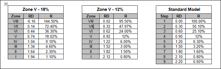

Ran across this the other day. There are three exposure models showing reflection density and Reflectance. The first is keyed off 18% Reflectance. The second is keyed off 12% Reflectance, and the third is keyed off the diffused highlight of 100% Reflectance. The third model is the one that works best with exposure theory math.
Interesting.
It looks like the zones are listed in backwards order in the Standard Model. By the way, the term "Standard Model" sounds like something from particle physics.
faberryman
Jun 4, 2016
6,047
Wherever
How can Zone V be 18%, 12% and 6% reflectance? They all can't be middle gray.
alanrockwood
Oct 11, 2006
2,193
I think it partly a manifestation of my point that the zone system is mathematically inconsistent, together with a dose of ill-defined parameters.
As far as the 6% us concerned, it looks like the zones are counting backwards in the standard model.
Stephen Benskin
Jan 7, 2005
2,745
Los Angeles

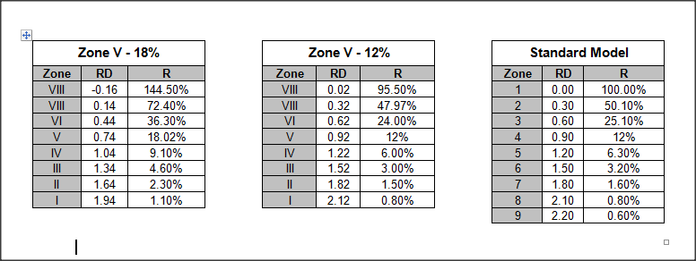

Good catch. My bad. The header should just be "Step." Exposure theory doesn't normally use Zone nomenclature.
I did steal the term "standard model" from quantum physics. Technically, it's the statistical average model.
