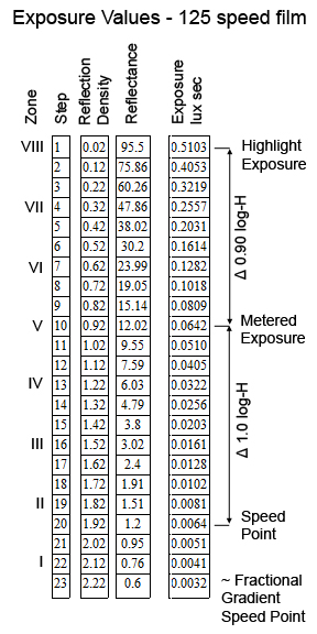

According to Jack Holm in Exposure Speed Relations and Tone Reproduction, “Two significant assumptions which are often neglected in exposure determination concern the scene range and mean reflectance. They are as follows:
That the luminance range of a statistically average scene is 160:1 (log range 2.20), and the resulting exposure range on the image capture medium is 80:1 (log range 1.90), corresponding to a camera flare actor of 2.
That the mean log luminance of a statistically average scene is approximately 0.95 log units below the highlight log luminance (edge of detail in white) and 1.25 log units above the shadow log luminance (edge of detail in black), and that this mean luminance is assumed to be the luminance metered, directly or indirectly for exposure determination. These values result in the mean luminance correlating with a Lambertian scene reflectance of 12% for 100% highlight reflactance…Flare results in the mean log exposure being halfway between the highlight and shadow log exposures.” Subtract the 0.30 value for flare from 1.25 and you get shadow falling 0.95 below metered camera exposure and highlight falling 0.95 above.
Attached is a numerical breakdown that comes close to the conditions outlined by Holm.

That is one of the most informative discussions I have ever read on this topic. I will have to get a copy of the paper you referenced.
