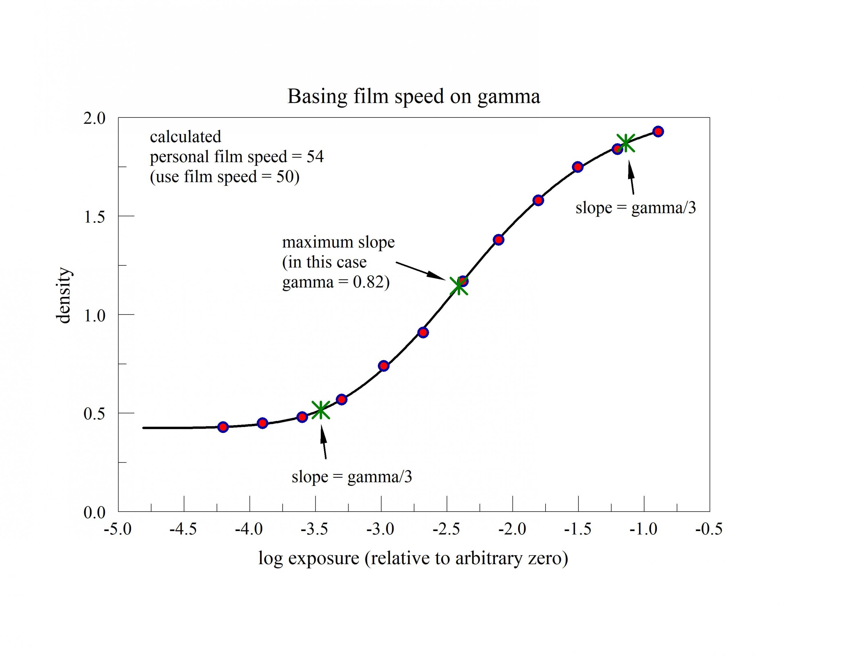

Here is an example of how this would work. This figure is from some actual film/developer testing I did.
In this case, if I could set my meter at an iso of 54 it would give the same density that the graph is showing at the gamma point (density = 1.145, gamma = 0.820). Therefore, I would classify this film as having an exposure index of 50.
The lower point on the graph marked as slope = gamma/3 has a density of 0.516, which as luck would have it is very close to the ideal speed point of 0.525 (base plus fog was 0.425), and that point is 3.5 exposure stops below the gamma point. The upper point with a slope of gamma/3 has a density of 1.870 and is 4.3 exposure stops above the gamma point. Thus, in this case, the curve is not quite symmetrical, but that detail is not too important from a practical point of view.
Interestingly, the parameters for this curve are very close to the iso definition (average slope of 0.64 for my curve vs. slope of 0.62 at a density of 0.8 units above the iso-defined speed point), and in this case I also get a predicted exposure index close to half way between 50 and 64, which is almost the same as what I get from my proposed method.
One could say, "since they give essentially the same result, why use your proposed method instead of the iso method?" That would be a good point. However, I think that if one is interested in recording the widest tonal range on film then my conceptual starting point and method is more defensible than the iso method, which takes as its conceptual starting point to achieve an adequate level of shadow detail. I guess one could summarize the philosophical difference as saying that my method emphasizes the main subject whereas the iso method emphasizes the shadows. In this particular example they end up at about the same end point, even though their conceptual starting points were different. For other film/developer combinations the two approaches might not give a similar recommended exposure index.
Please note that one advantage of my proposed method is that if two film/developer combinations are set up for the same gamma then, regardless of whether or not the same exposure indexes are recommended for the two film/developer combinations, if the recommended exposure indexes for the two film/developer combinations are followed they will give essentially the same tonal separation for the main subject of the photograph.
By the way, I would call this particular film/developer combination as long-toe. What do you think?
One last point: If one wants to emphasize the shadows a bit more one could shift the effective film speed down a little bit without greatly affecting the tonal separation at of the main subject, provided the one doesn't go too far in that direction. Conversely, one could shift the effective film speed up a little if one wants to give more tonal separation to the highlights without greatly affecting the tonal range of the main subject, provided one doesn't go too far in that direction.

One additional point to add to what I wrote in my last post. I have not said what gamma one should shoot for. That is something to be left up to the shooter. This is where one could bring zone system concepts back into the discussion in a slightly different way. If one has a scene with a wide tonal range then one might want to decrease development so as to reduce the gamma, thereby bringing in a wider tonal range from the scene. Conversely, of one has a narrow tonal range then more development might be recommended in order to get better tonal separation.
One could summarize this by changing the old saying "expose for the shadows and develop for the highlights" to something more like "expose for the main subject and develop for the tonal range of the scene" though there might be some subtleties not captured in such a short slogan.

And how do you meter a scene for gamma 0.82?
You first do some background work, i.e. testing to set up your film/developer combination for your preferred gamma. That gives you a recommended exposure index for that film/developer combination at the selected gamma. When you are going to shoot a photo (which could be years after you have set up your preferred gamma and your effective film speed) you set your meter to the recommended "iso" for that film/developer combination and meter the main subject of interest in the photo.
There is nothing sacred about a gamma of 0.82. It is simply the value I got when testing this film developer combination.
