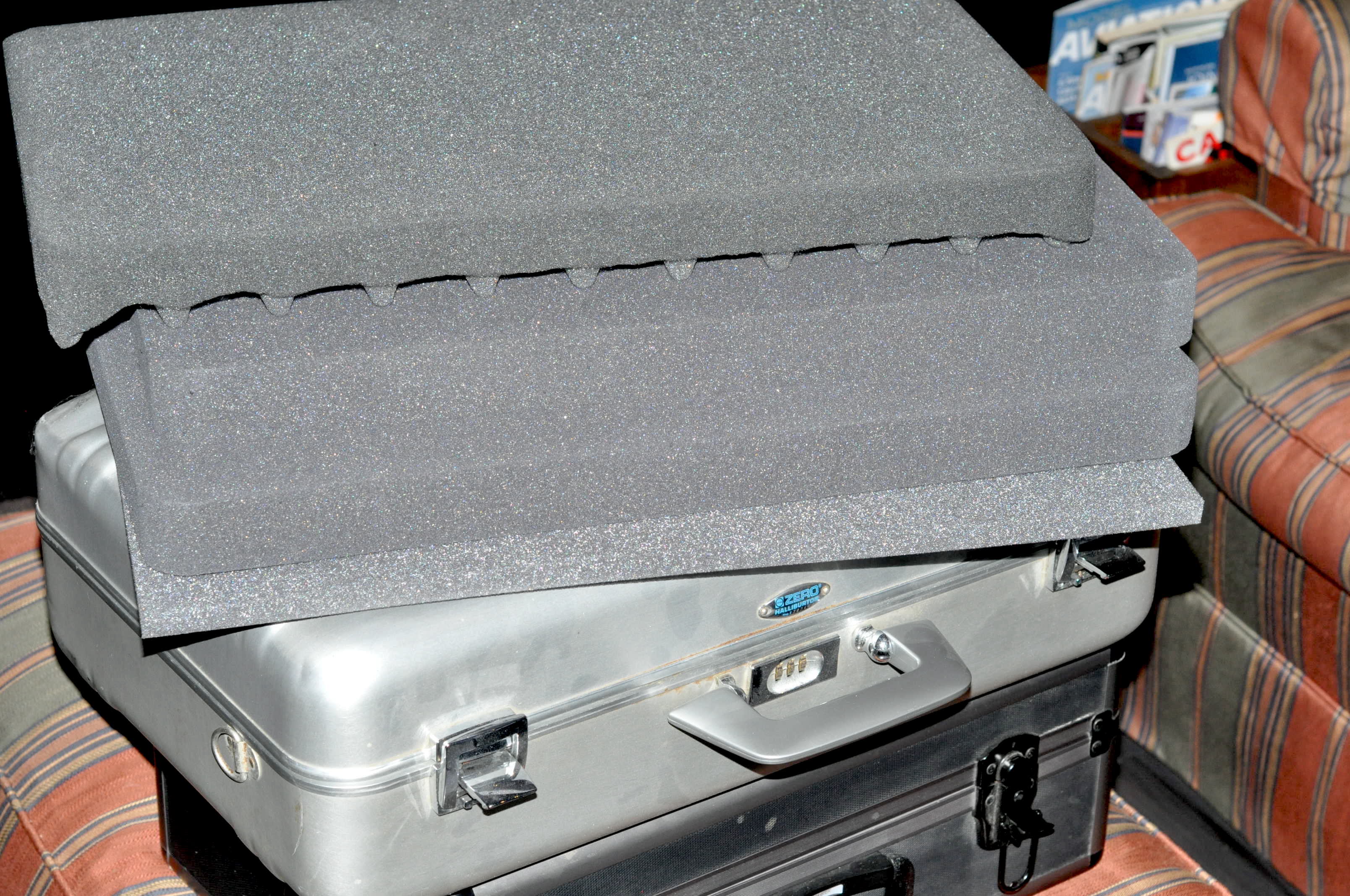

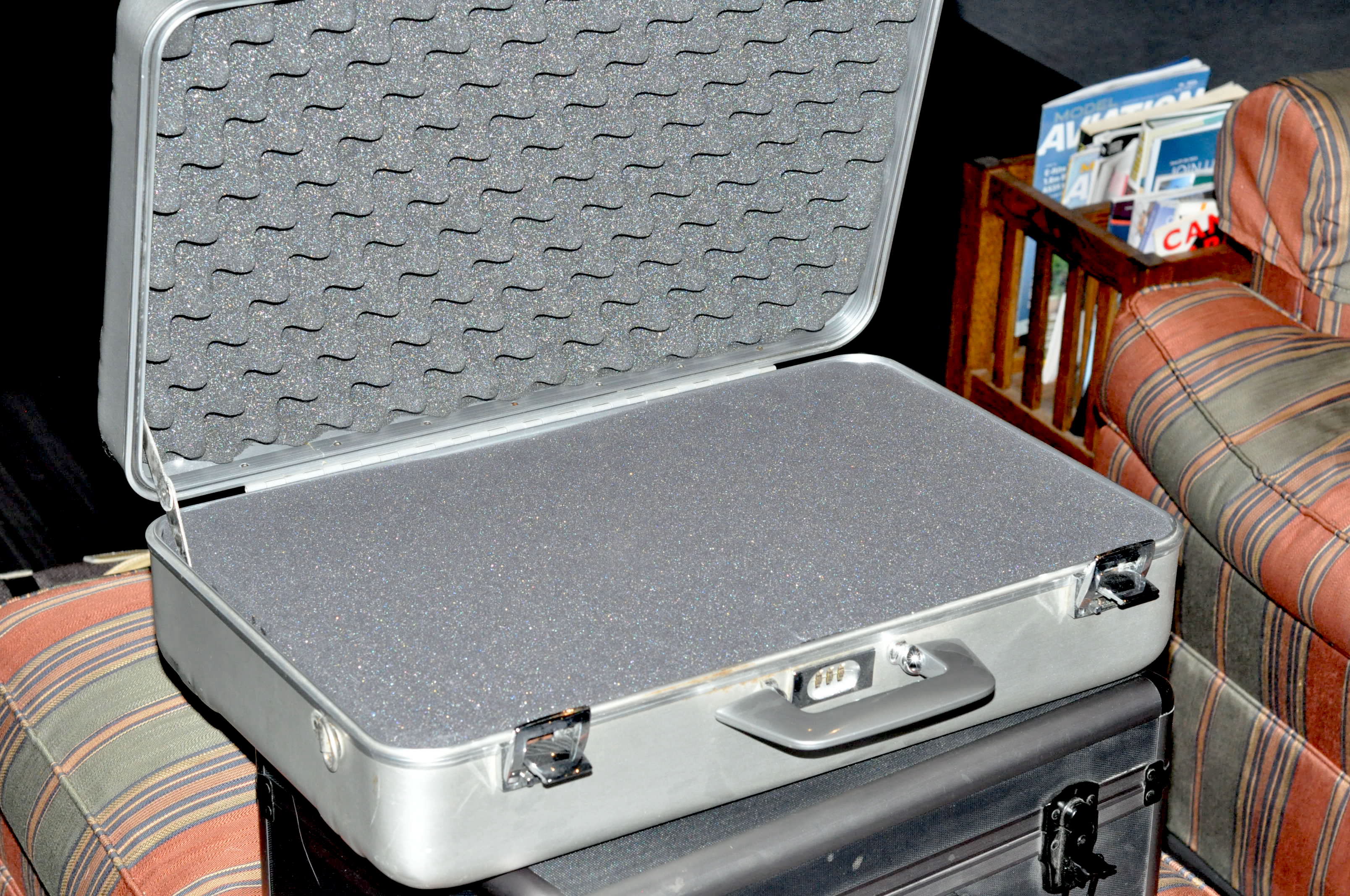

I got this Zero Halliburton aluminum case in 1985 and have replaced the foam 3 times. Last time I went to use it the foam had fallen apart.
The last three times I used a long knife to cut the foam. It never came out too well.
This time I thought I'd try to cut the foam with a hot wire.
I got the replacement foam from www.cobrafoaminserts.com. They sell exact replacement for the four original pieces of foam that came in the case when it was new. The foam was a perfect fit.
View attachment 371514View attachment 371515
this gray foam looks like polyurethane foam. PU foam will deteriorate over time, will get brittle,crumbel,turn to dust and will make a mess. The better foam to use is polypropylene foam. PPfoam is far more stable than PU foam but needs to be kept away from sunlight because it issensitive to UV radiation, which is rarely a problem with closed storage and protection cases.
