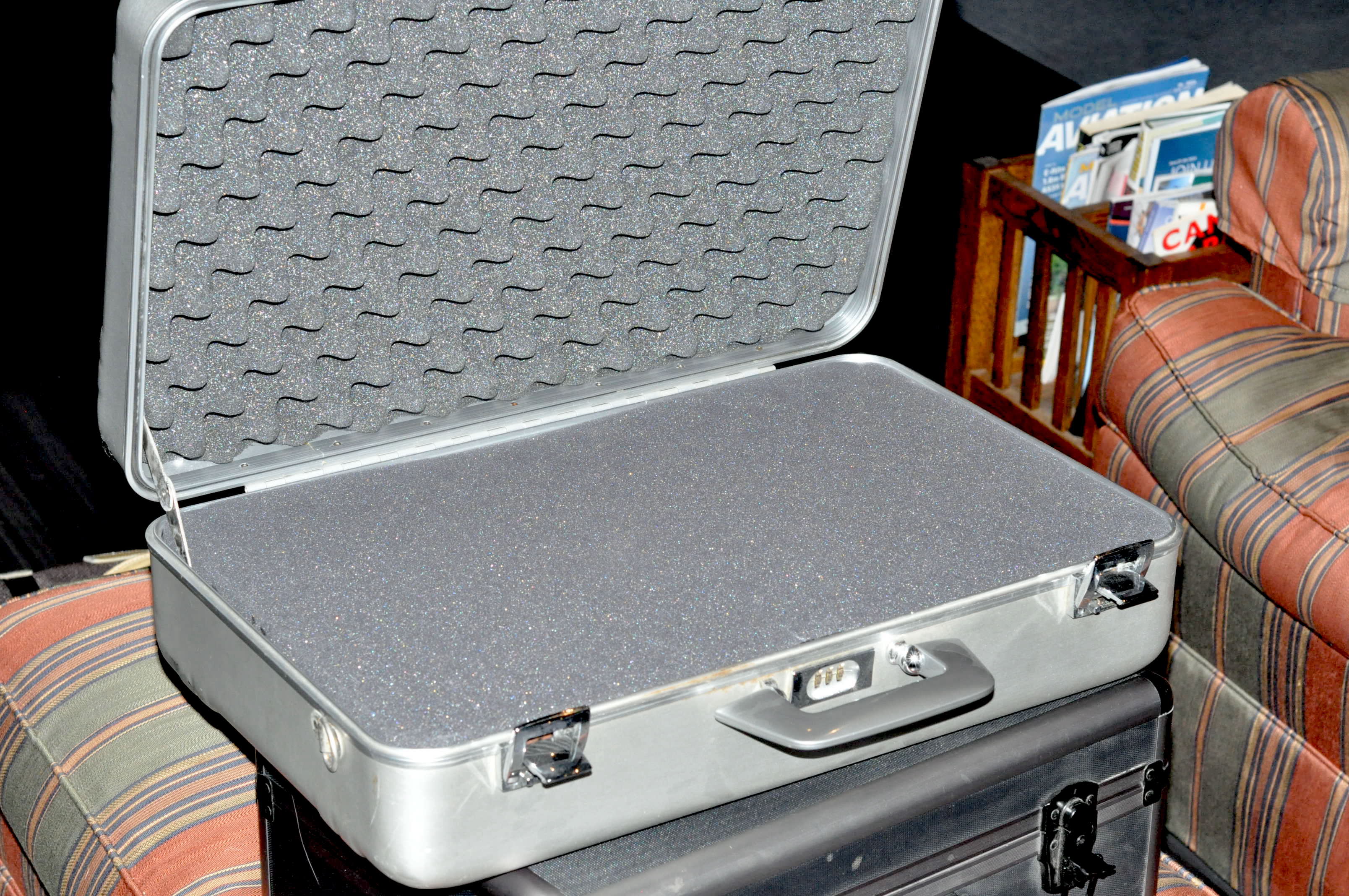

I got this Zero Halliburton aluminum case in 1985 and have replaced the foam 3 times. Last time I went to use it the foam had fallen apart.
The last three times I used a long knife to cut the foam. It never came out too well.
This time I thought I'd try to cut the foam with a hot wire.

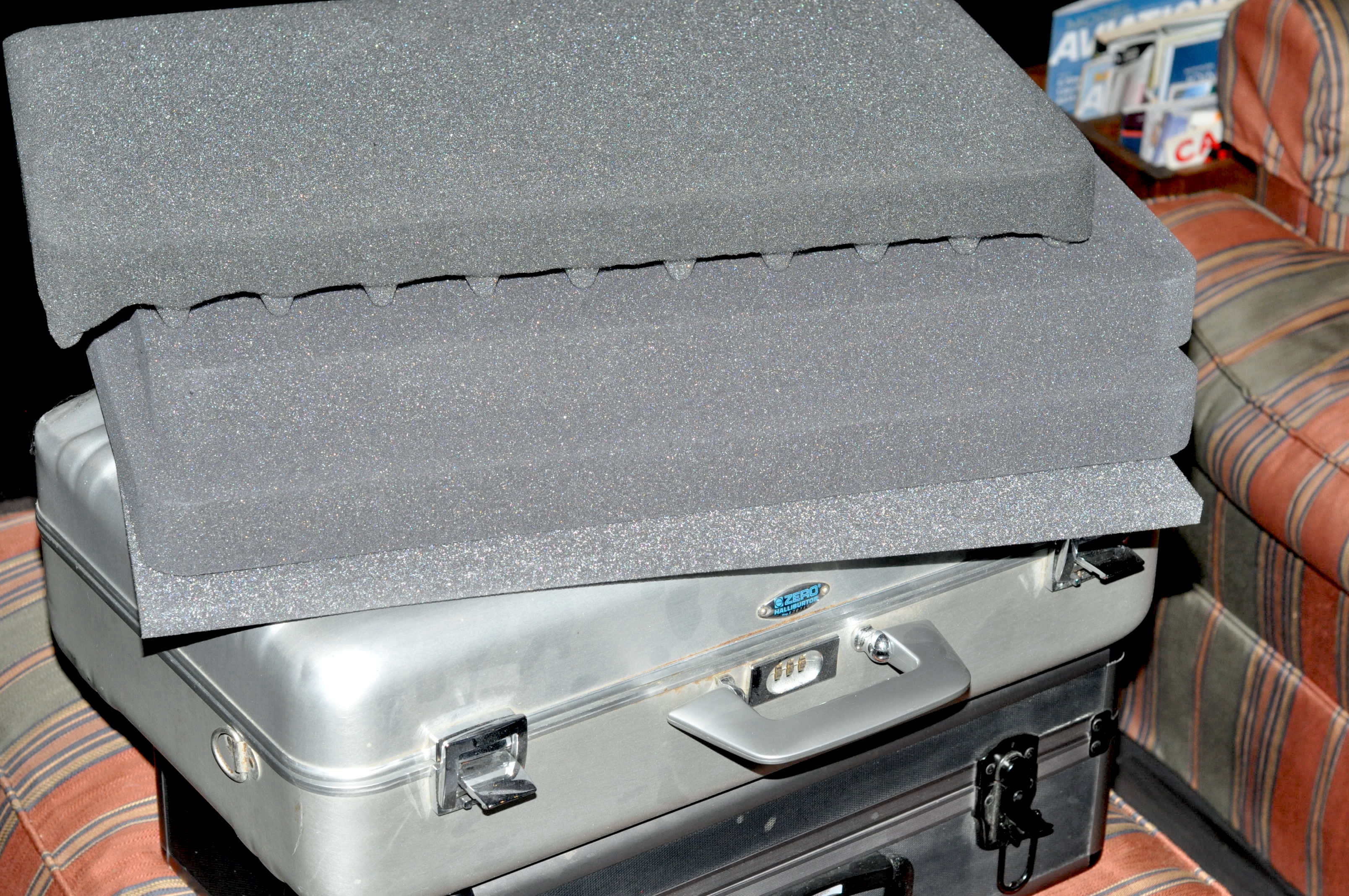

I got the replacement foam from www.cobrafoaminserts.com. They sell exact replacement for the four original pieces of foam that came in the case when it was new. The foam was a perfect fit.

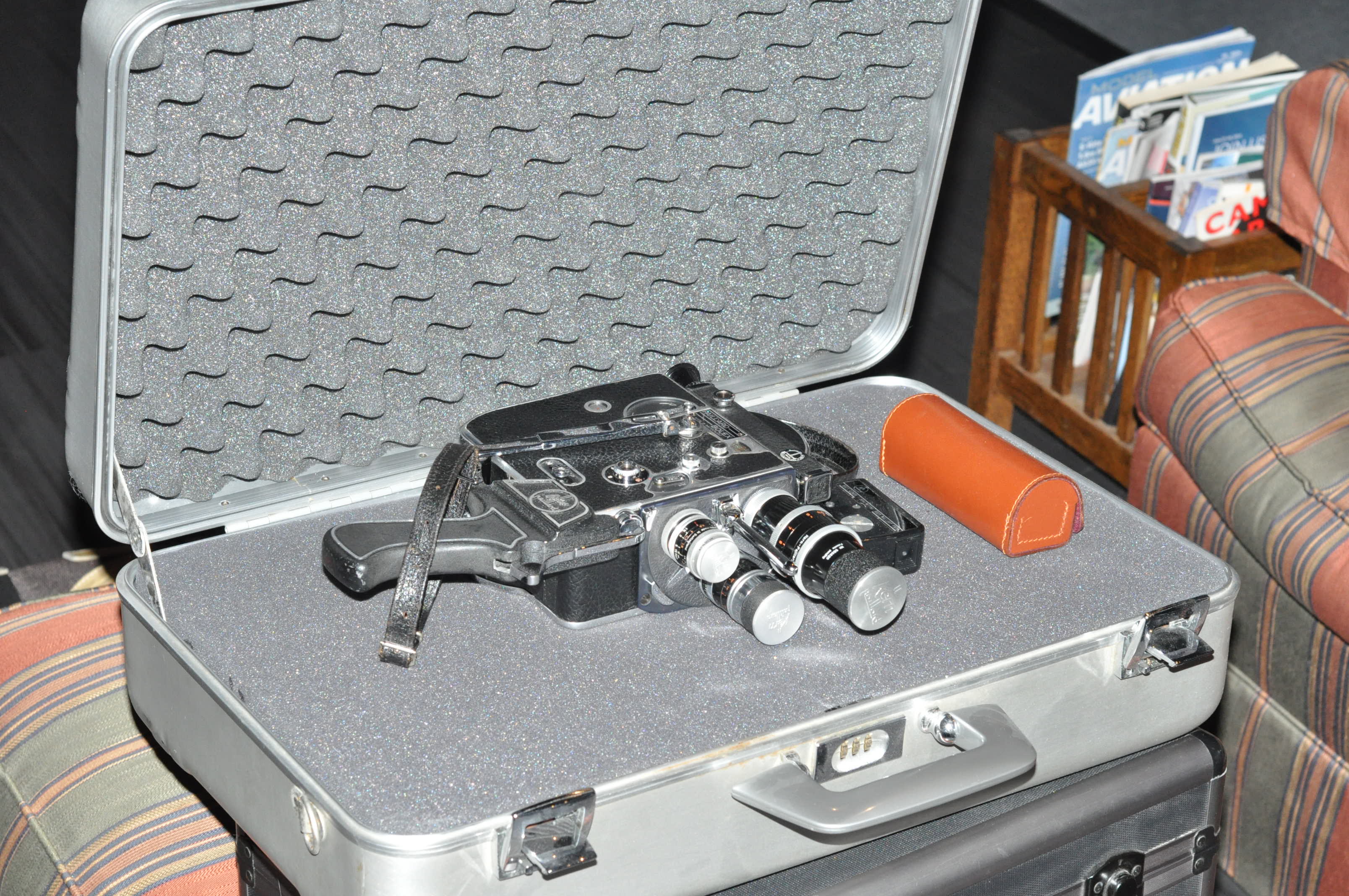

Test fitting the equipment on the new foam.

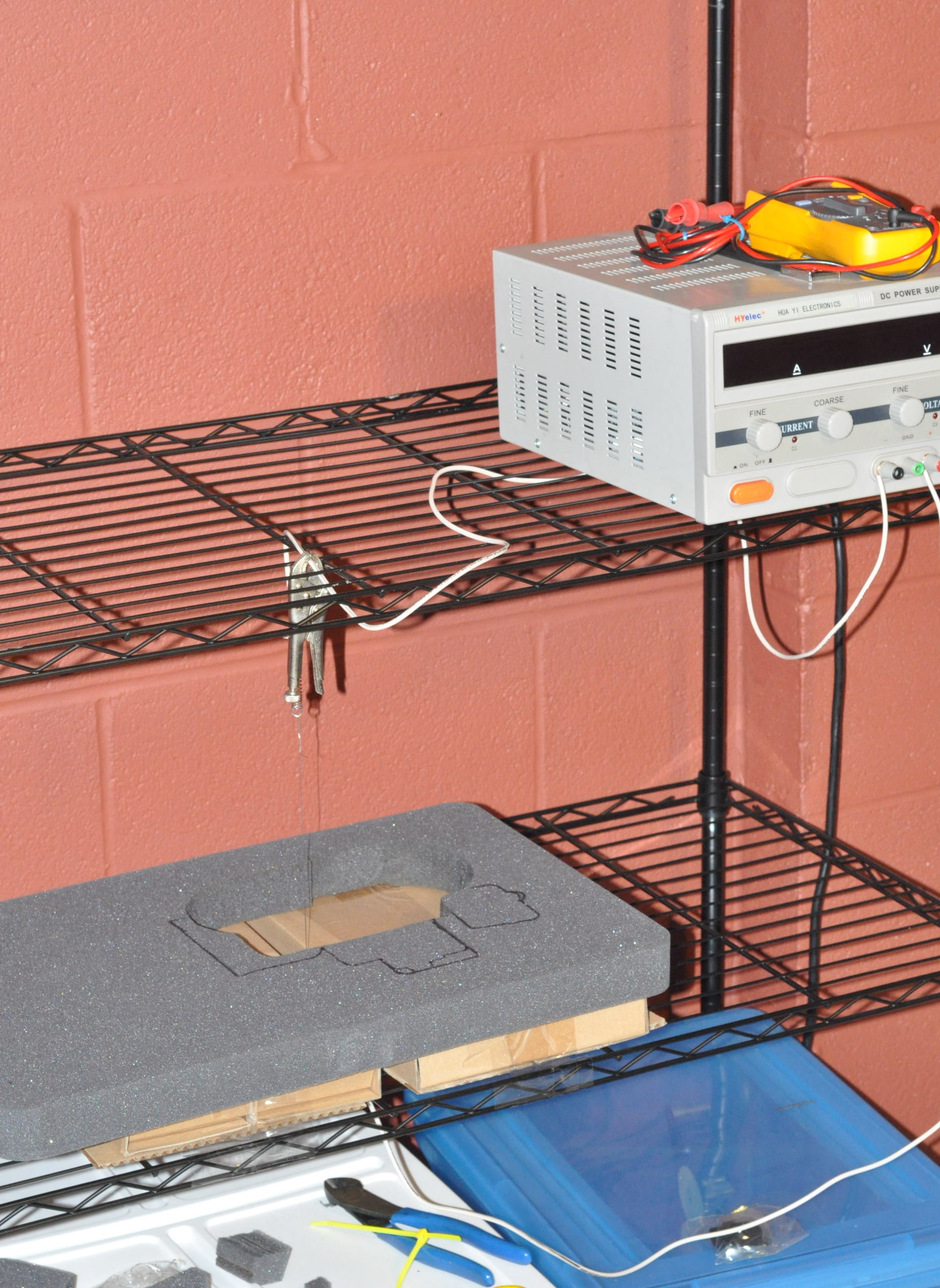

This is the setup. A power supply and guitar string stretched tight. The little ViceGrip holds the wire tight. Below the guitar wire is looped around a wooden dowel with a wood screw holding the power wire and the guitar string tight together.
The two one-inch boxes are needed because the wire does not cut at the end, only near the middle (because the end cools at the attatchemnt point).
Trial and error was needed on the power supply (5 to 9 v depending on the wire). Hot enough to cut, but not so hot to become red (otherwise the wire breaks).
I tried a .010", 0.012" and 0.016" wire. (E, B and G). The 0.012" worked best for me.

The center two pices of foam are pretty dense, Shore A of 40 or so, just as I remember the original. More dense than the squishy top and bottom pieces and more dense than typical segmented pluck' foam. So, this was almost like cutting styrofoam.

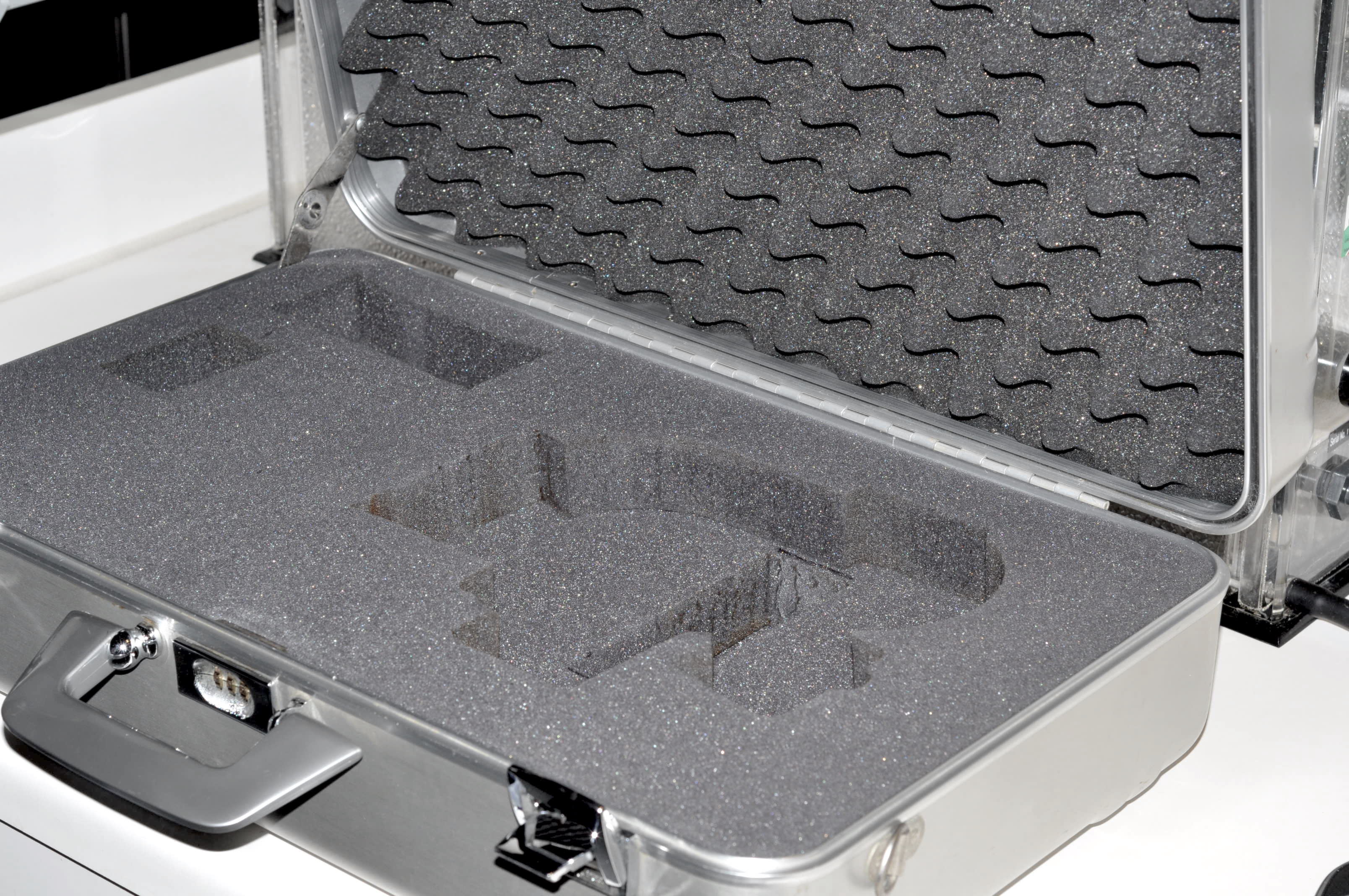

Yes, electric meat carving knife works too. I used one on the little rectangular openings (evident by no burn marks). But I find it harder to make a perpendicular cut, or, as pointed out, a curved cut.
How are you making rectangular or free-form cuts in that foam?
If the pieces to cut are smaller than 10x10 inches I put them in my laser engraver. These pages outline the laser process:
In the past i have used a bread knife. I have not gotten to the rectangular holes yet and the case inserts I am now making are way too big to fit in the laser. I have an electric carving knife coming tomorrow...

The carving knife works very well. I have it cleaned up and ready to carve the home corned beef we are having for dinner tonight. (twofer)

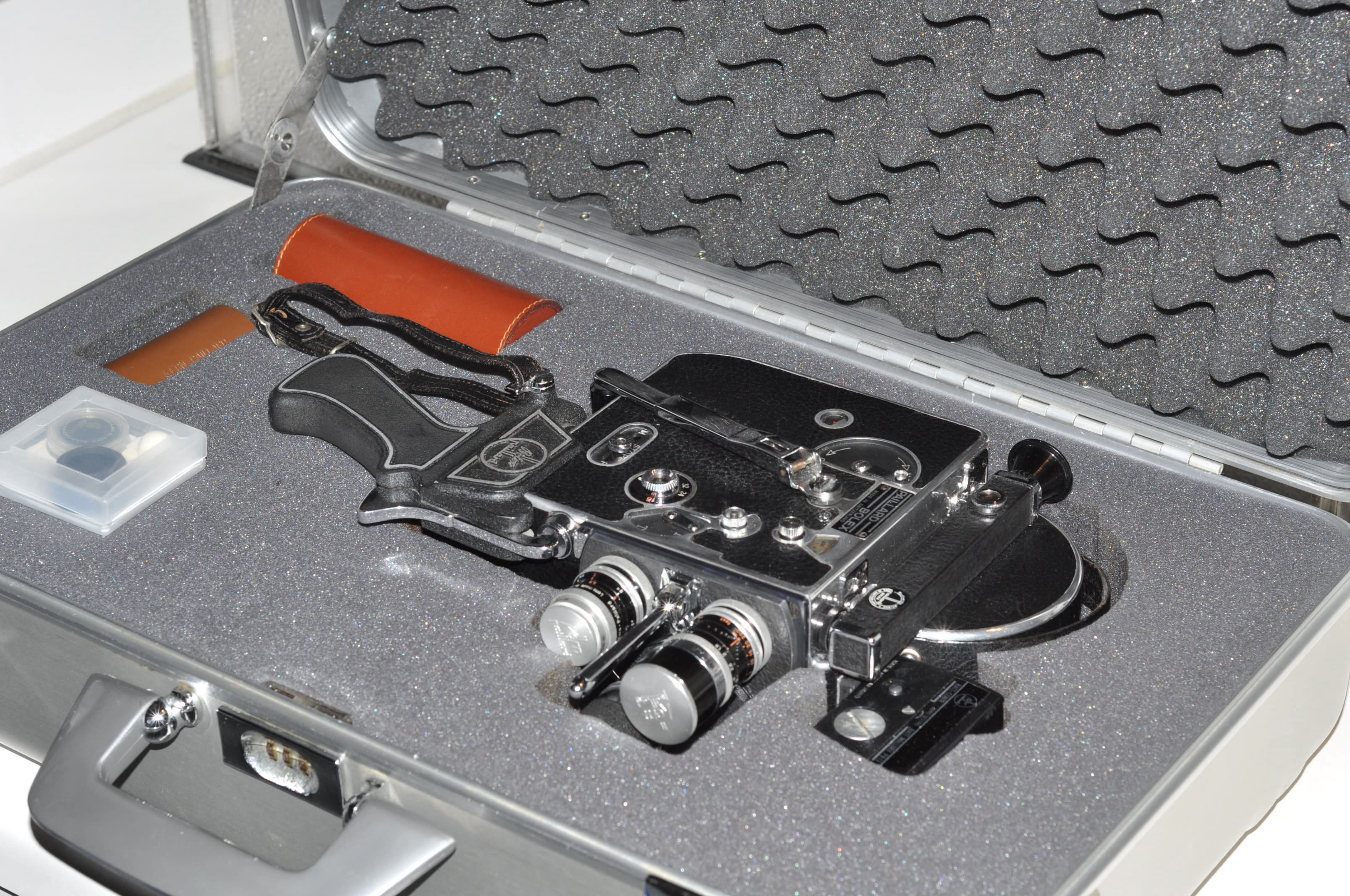

Here are the results of my case for the Pentax 6X7: https://www.beevo.org/Photography/PhotographicEquipment/Pentaximus/index.htm
