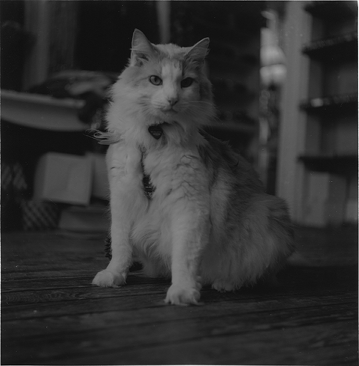

Yesterday I starting printing this image. Its a good negative, perhaps slightly under exposed. I missed the focus on this one slightly, as the tuft of fur sticking out of the neck on the left is more in focus than the eyes. This is the very first roll that I put through the Yashica 635, and this was about the 4th photo I had taken on a roll of TMAX100 - 120. The exposure was around 1/60th at 5.6 if I remember correctly.
I did my normal filter 2 exposure and came up with this. I think this is like 15 secs. Its muddy, gray, and just kinda blah.

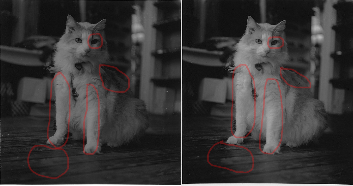

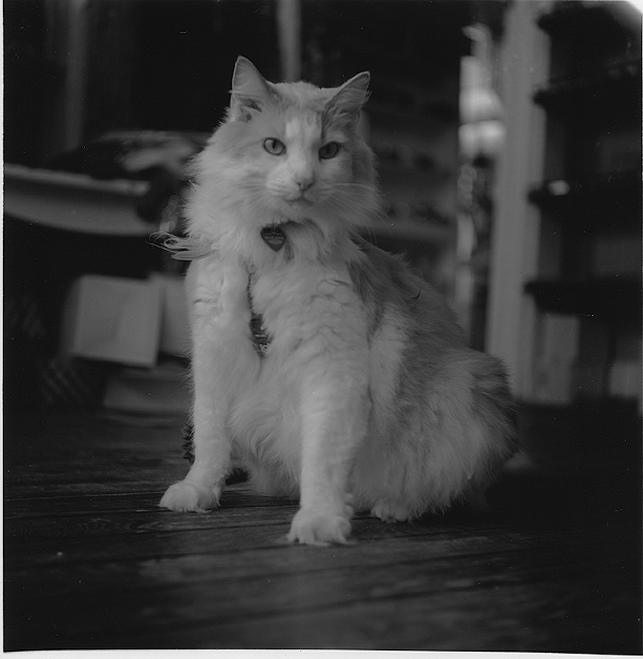

I used Les' method, and I ended up with this. This is a 'soft' exposure of 8 seconds with filter 0, and a hard exposure of 6 seconds with filter 5. It also has and extra 10 seconds of vignetting on the edges.
So far, this is what I've learned. There is a noticeable difference in the right (cats left) eye, the split grade version is opened up and not so 'dead'. The highlights on the legs are cleaner and not so muddy. The shadow on the back is opened WAY up, which is nice because the cat is actually orange and white. And the grain in the wood on the floor is not so flat.

Moniters are always a question, but I suggest you continue to shorten your soft time, until you feel that you are seeing a clear paper white somewhere. Keep your grade 5 exposure and by shortening the grade 0 you will increase contrast. It is well to go beyond what you might in the end, choose; particularily when starting out.
yeah. these scanned a little darker then they appear in person. I'll try shortening the soft time.
Ignore the contrast and experiment with exposure time.

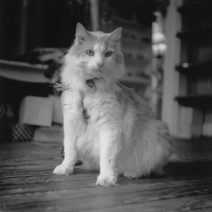

Ok. So this is where I am now.
4secs with the 00 filter, 6 secs with the 5 filter, and then 4 secs added to the edges for vignette. I also had to dodge the cats left eye during the #5 filter to keep it from going 'dead'.
