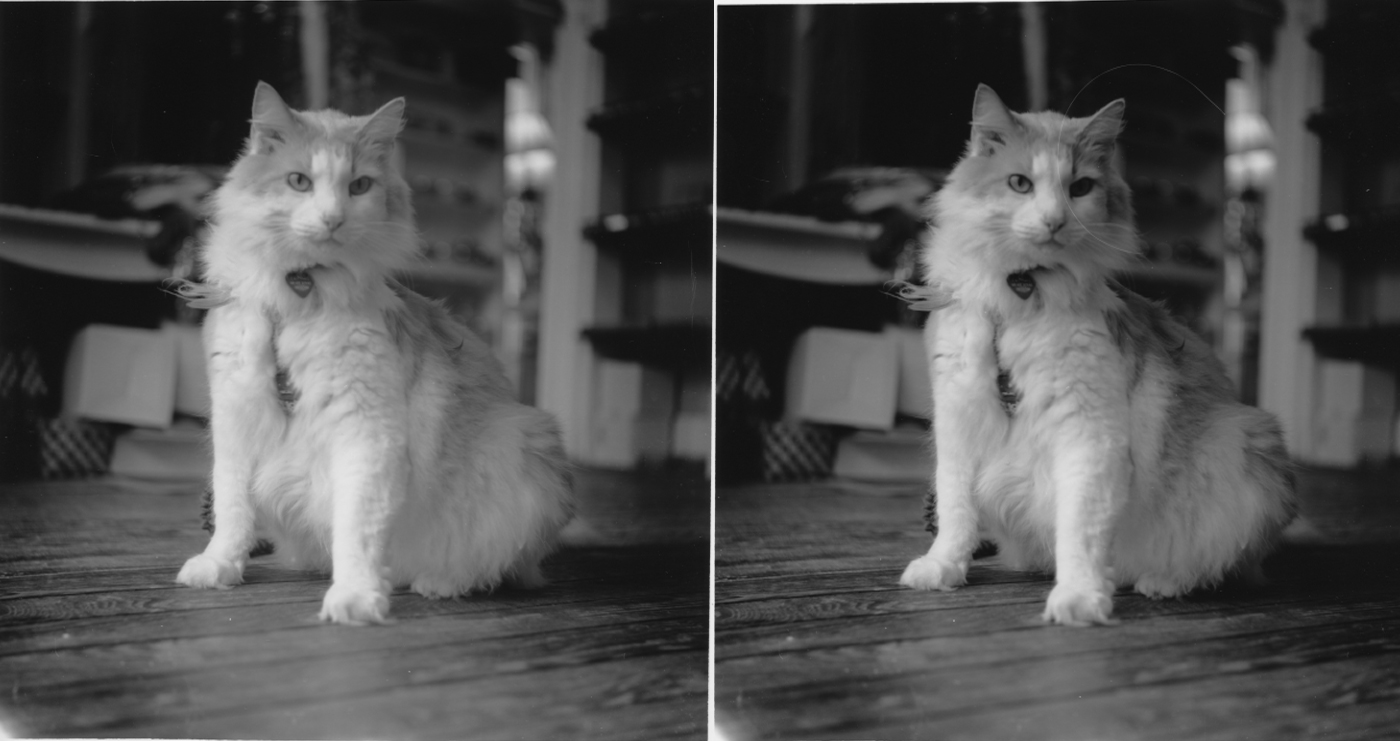

Your Thoughts? 1st time trying split grade...
Chiaro o scuro?
Chiaro o scuro?

What I asked was, "what do you suggest I could do better or different to improve my print." I didn't ask, "how can I completely change the process that I've just learned to understand because my fellow photographic geniuses think I'm complicating things." Someone suggested that I cut down the soft exposure, and whaddaya know, it worked and I understand it.
I'm not discounting any of the advice thats been posted, its all good advice. But telling me that using two filters is the same as using one and I should be doing it a certain way isn't going to help me.

Matt, you got my post card. That was printed at 12 secs with a 1 filter. I started at 2 but the shadows were too dark.
Is that image a good example where SG would be better suited?
Christopher:
It may very well be an example where split grade techniques would add controls that would benefit you.
But those extra controls would be ones that allow you to use different contrast behaviours for different parts of the image.
Something like doing a lighter print at grade 2, and then adding a burn at grade 1 in the highlighted areas only.
That would give you better definition in the shadows.
To repeat myself, if you are just adding a low contrast, overall exposure to a high contrast, overall exposure, you aren't getting anything different than a single, mid contrast exposure. So it would be a really good idea if you can get yourself directly to that single mid contrast exposure. Then add split contrast tools to customize further your result.
If thinking about contrast grades in split grade terms helps you visualize how to proceed, and you find it difficult to think instead in terms of single, intermediate contrast terms, then feel free to continuing to use the technique. Most of us here just think that if you don't understand how both approaches work, then the extra complexity of split grade may end up tripping you up.

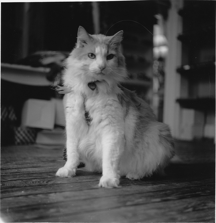

Christopher, well done so far.
And yes it appears to be a bit of a Raw vs Jpeg argument (or maybe Betty or Veronica, Betty is simpler but Veronica's wealth has more potential; neither is a bad date)
I have three enlargers; two are colour heads and are typically used with "combined filter" settings, but the blue/green enlarger that I have must be used as a split grade enlarger.
The split grade technique involves changing the time only of each of the components based on what the highlights or what the shadows look like.
The single filter approach more often leaves me wandering between changing contrast or changing exposure. I.e. do I want whiter whites by increasing grade or decreasing exposure?
I realize that experience at reading a test print will eventually lead one to choose which path to take.
but you have chosen a path and are doing very well, the third print is a great improvement.

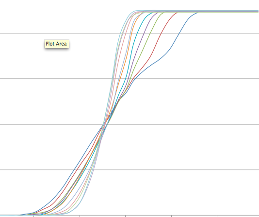

Variable contrast paper basically has two emulsions, a low contrast layer sensitive to green light, and a high contrast layer sensitive to blue light. When light hits the paper, the more blue there is in the light relative to green, the more the paper's high contrast emulsion is exposed relative to the low contrast emulsion. This produces a higher contrast image. The reverse is true when there is more green light relative to blue light.
Michael, while I follow your statement, I wonder if you would agree that there is a more detailed explanation of how VC papers work? I would humbly observe that it seems, based on their characteristic curves, that the component emulsions are differently sensitised to the blue and green light and that it is their additive result that creates the actual, observed contrast. Further, modern VC papers, like Ilford (or like Polymax used to) seem to have three emulsions, with the third one being sensitive to both green and blue.
Unfortunately, this can also lead to some odd behaviours at extreme low grades, such as 00. See Nicholas Lindan short paper: "The Workings of Variable Contrast Papers and Local Gamma". For that reason, split-grade technique can be a little easier to use with filters a little harder, such as 1 and 5, rather than 00 and 5. I believe that is what Bob Carnie practices. The effect will be the same, but the observed changes will seem more logical when using 1 rather than 00 for certain mid-tones.
Steve Smith
May 3, 2006
9,110
Ryde, Isle o
According to Ilford's data sheet, all of their emulsion layers are sensitive to blue with varying sensitivities to green added.
I wonder if this demonstates a difference between the subtractive system of using white light and the additive system of a Blue/Green system.
Otherwise I have a hard time understanding how using a 1 setting of this much green and this much blue (plus this much blue for the #5 exposure) is different from this much green and (this much blue plus this much blue for the #5 exposure). Moving the brackets does not change the total quantity of green and blue. Comments?
Feb 23, 2006
789
Wicklow, Ireland
Cowanw, I believe there is no difference in the final result, whether you use 00 or 1, with a 4 or a 5, when split-printing, except for the inability to reach the extreme grade of 00 or 5 if those filters are not used. The difference, however, is in the seemingly illogical relationship of the midtones affected by the discontinuity in the emulsion overlap, and the remaining tones, when moving from grade 00 to 0 and onwards. To put it in other words, as you move up a grade, from 00 to 0, and then towards 1, some midtones will immediately print denser at 00, than they would at 0, before they resume their march towards increased density at higher grades. I think this is what leads to a "solarised" look, that Bob Carnie mentioned when describing his 00 experience, see post 43 of this LFPP thread. You can see this in the two jumps of the 00 and 0 grade curves, which I have, rather poorly, plotted below—disregard my error of a non-speed matched system, which lead to the curves not intersecting, as they should, at 0.60 logD. Notice the overall shape, and those almost 1 f/stop jumps, of the 00 curve:
Thank you, Steve, for correcting me.
cowanw
Aug 29, 2006
2,236
Hamilton, On
Yes, I have followed these threads and seen these graphs. I think they are based on white light and the subtractive system.
I am wondering if there is a distinction to be made that the definition of grade in the subtractive system is what you get with the provided numbered filter, and with regard to those discontinuities, the filter is not, in fact, correct for that paper at that desired grade. There is, after all, a set of yellow/magenta settings (i.e. colour head) that will give a smooth curve, just not with preset filters
The blue green system however forces you to find your grade by using the settngs on the enlarger with respect to the paper you are using. Again a smooth curve can be created with the appropriate settings.
Bob describes solarization or muddiness in the shadows. Other discrepancies are seen at midtone. I am not sure the two observations are related.
I think Bob's observations need more investigation for an understanding of what he is describing.

So, just for shits-n-giggles I went back in and printed this last night just before going to bed. This is Filter 3 @ 10secs.
And just as a comparison, on the left is the "split grade print" and on the right is the Filter 3 at 10secs. If I were to do this again, which I may do with the two last sheets I have, I would do a filter 3 and dodge the cats left eye, and on the second sheet I would do the split grade thing, but use a filter 4 and burn the fur a little more.
Bob Carnie
Apr 18, 2004
7,735
toronto
Med. Format RF
On either print, back off the density a bit , do everything the same, except burn in the highlighted cats fur with a #5 filter.. just for shits and giggles
