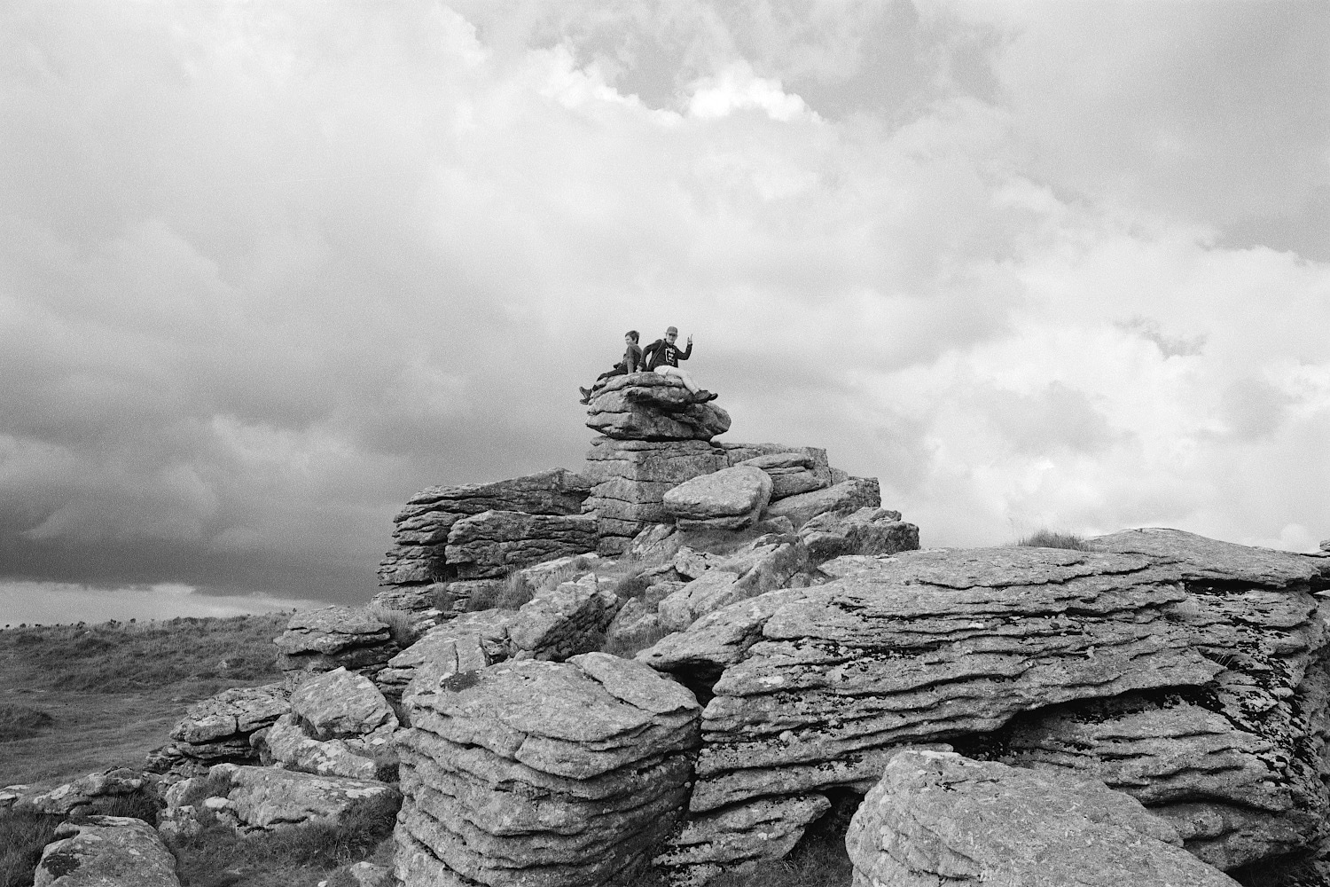

I’m one who brought back a photo (“Dad and the Twins” in the gallery) that convinced me that TMY2 doesn’t need a yellow filter because the clouds can be easily seen in the sky (and I didn’t use a filter).
The way I see it, this gives it a one stop speed advantage over a 400 speed film where you would need a yellow filter.

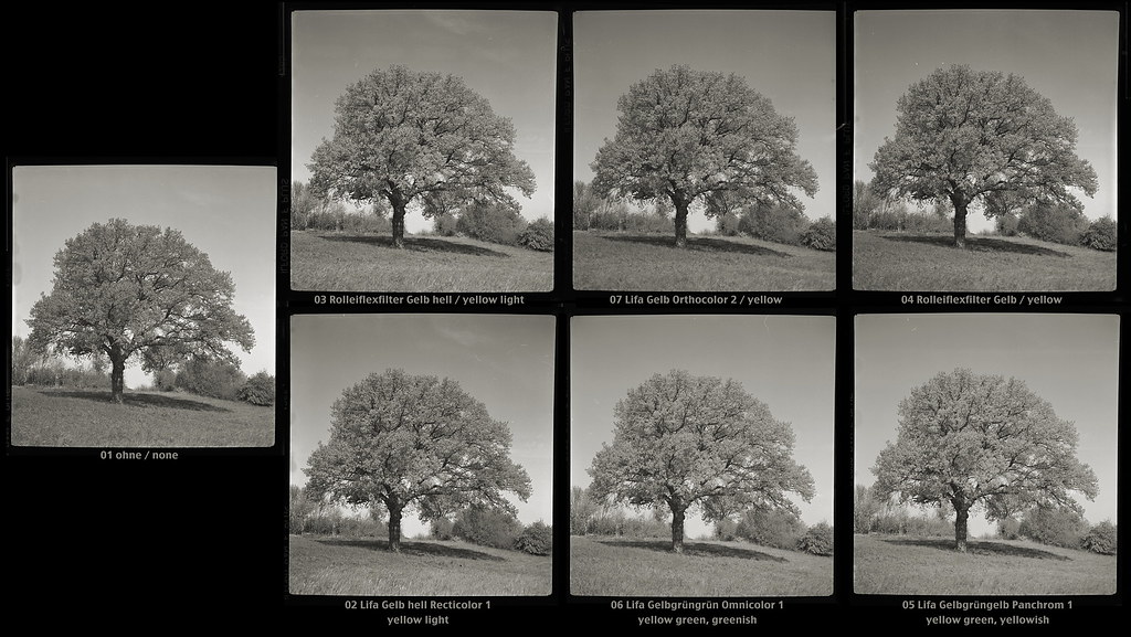

I found it helpful to take a couple of filters and make some test images of the same subject:
Filter_comparison_Oak by Jens Hallfeldt
My conclusion: My favourite is one of the yellow light filters, the darker yellows are fine.
The greenish filters let the tonal reproduction get a bit out of balance. The worst image is the one without filter.
Film: Ilford PanF Plus 120
Best
Jens
