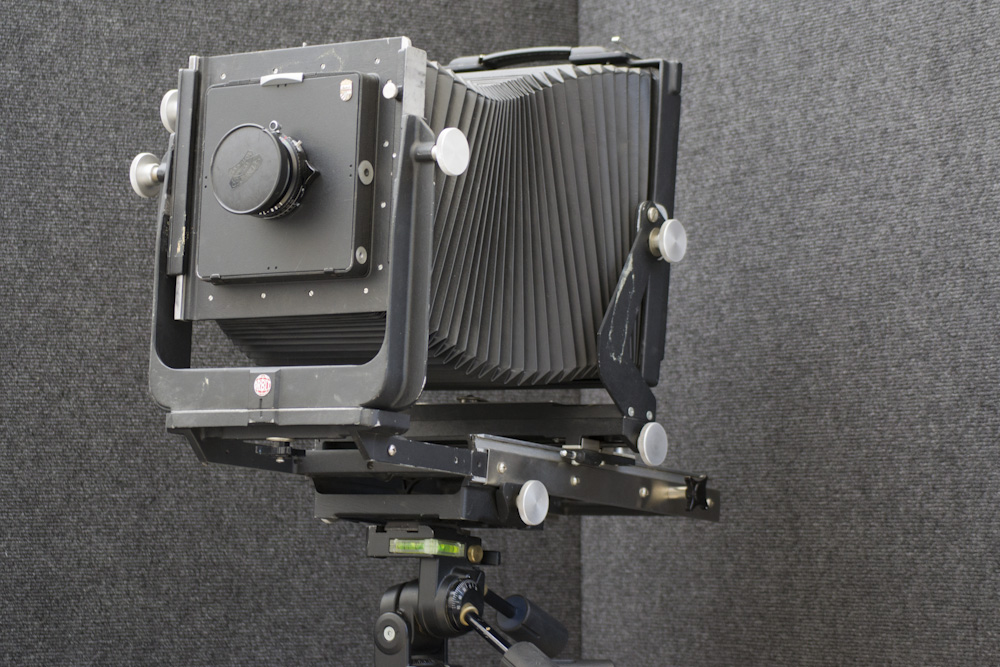

Hummm....not surprised the MF cameras are heavy.....I'm glad I lift as I don't think MF cameras were designed for little people :smile: I've only seen a big camera that I can remember once...a few weeks ago I went to an art fair and one of the fine art photographers brought his camera for people to see. I'm not sure what it is but I got an image of it that I included below.
