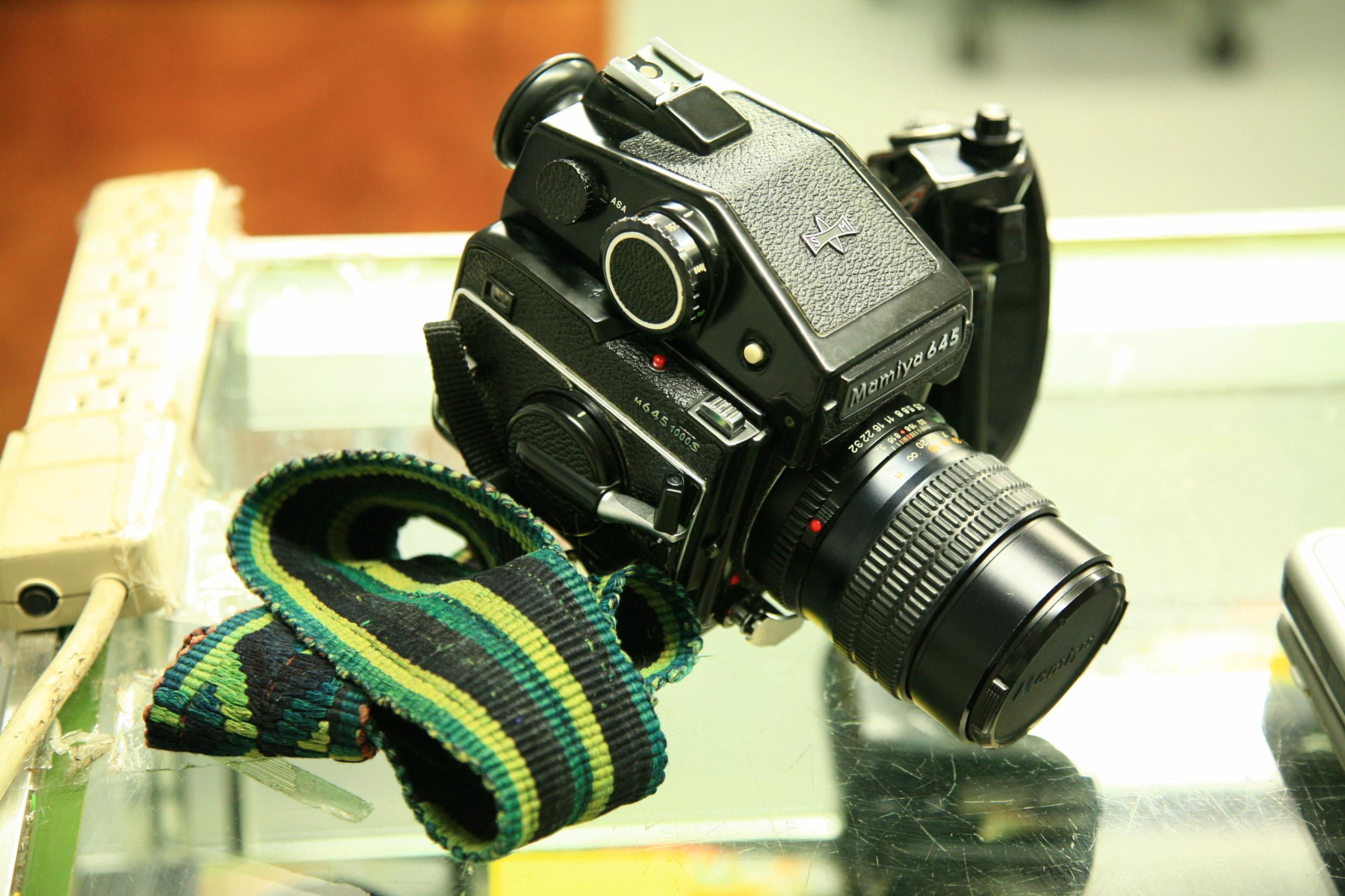

Got it.
The difference between 35mm and this is like the difference between some high-grade marijuana and doing lines of puro Columbian coke.
I'm pretty sure I will have my Nikkormat system for sale soon, as much as I love it, this thing is a hopped-up version of a Nikon FTn

Congratulations, Mr. Dogg !

Yeah I love this, I've already taken 4 shots with it and plan on finishing the roll this week.
Since this is my first time with MF, couple things. F$&%#$& it's heavy, it weighs about as much as my Nikkormat FTn with a Vivitar Series 1 70-210 f3.5 on it. It's HUGE. Makes my Canon 5D with battery grip look like a toy.
The left grip takes some time getting used to. I've shot SLR's in 135 for a long time and the business end is on the right side. Though it's MF I have a rough idea of their 35mm equivalents, the 150 I believe is close to about 90-93mm 35mm-equivalent.
How wide does the 35mm come out to be? I want to get a decent wide, the 80 1.9 (which is the 50mm equivalent) and maybe something with more reach like the 210 or 300. Not ruling out A glass, which seems to be their equivalent of Canon L glass (of which I own a few) the 150 2.8 looks like that could be great for portraits.
Also how accurate is the light meter? It seems to be close to my 5D which is dead-nuts on. And my noob MF question for the day....are the exposures supposed to be the same as 35mm? I find at 400 ISO a shot that should be a 1/60th is like 1/100 or 1/125 on my digital. I'll have to check it again, I know my digital Rebel has a smaller sensor and it's always running a higher shutter speed than my 5D which would make sense on the 120 if true.

Shot a little bit more, on a second look the exposure is spot on compared to my 5D, both would do ISO 400 1000th-sec @ f11 in the same FL and scene. Very solid feel, every shutter advance is like loading another clip on a .50 machine gun.
It really is a big beast, getting used to the left grip now, think I'll keep it. Definitely see an 80, 45 and a WLF in my near future, also scored some 20-year old B+W Kodak 120 pan-x.......not sure on the condition but hey free film.
Also the local camera shop has a nice Metz 45 with all the attachments, would look decent on this rig. Has the sync cord (and I can use it with my EOS system) might end up picking it up too. They gave me the film and the shutter cord that came with it free.
Bottom line is, this one is definitely a keeper and I may step up to a Pentax 67 and keep it as a sidearm, much as I do with my 5D full-frame digital and digital Rebel APS-C sidearm.
One more question I have, I want to get some more 120 backs for it, would it be safe to have like 3 120 backs, and pre-load 2 and keep them in the case they come in, then when it's time to exchange rolls I can just pull the old back out and put the new one in?
Also, can I get a Polaroid back for it and shoot Fuji FP?

By "backs" I take it you mean "inserts".
If you have the cases/boxes for the inserts, they are designed to be pre-loaded.
The only thing you have to watch is with respect to the exposed films. You need to be sure that the sealing tape goes on ASAP or some other step is taken to make sure that the backing paper and exposed film doesn't unravel.

Unfortunately, no. The 1000s does not use interchangable backs, so you can't get more backs and change mid-roll either. You CAN get additional inserts and pre-load them for quick film loads. Same with the Polaroid - you need to move up to the Pro or Pro-TL (but not the AF model - I got my Polaroid back free from someone who bought it not realizing it wouldn't work on his 645AF.)
I've been finding the Polaroid back fun, and it's useful for proofing, but the lack of one isn't a big thing. Bear in mind how small the image is. The print area is the size of a contact print from your negatives. It wastes a lot of the 3.25x4.25 Fuji film area.
I'd stick with the 1000s for now and build a system around some lenses and get some inserts. If mid roll film changes are really important, you can then add a Pro or Pro-TL body and some inserts, prism and winder too if you want, for not much money at all, and use both bodies with all your lenses.
