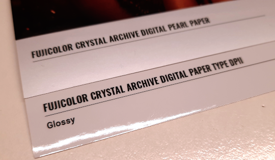

2. What in the heck is DPII pearl? Is it DPII or is it Pearl? I thought these were mutually exclusive, but I came across this that is supposedly 'Glossy' and 'Pearl'. I want the glossy, but I don't want the pearl...

IDK, but it wouldn't surprise me if DPII glossy and Pearl are technically the same paper with one notable difference: the 'Pearl' paper has a sort of opalescent/glittery shine to it. Its whites aren't really white, but kind of silvery. I suppose it has some kind of finely dispersed glittery particle stuff embedded in the protective topcoat, but that's just a guess on my behalf. In the sample kit I have, Pearl and DPII are both listed as 'Professional' papers.
Btw, this particular question should be answerable by contacting Fuji through this page: https://www.originalphotopaper.com/en/contact/
This snap gives a bit of an impression of the Pearl finish; it's kind of silvery if you look closely, much like metallic paint on a car. It's not exactly a 'finish' in the same sense as Silk, Matte etc. since it's evidently not made by a patterned calendering roll that impresses a texture onto the paper surface. The pearl thing must actually be embedded in the gelatin emulsion itself.
