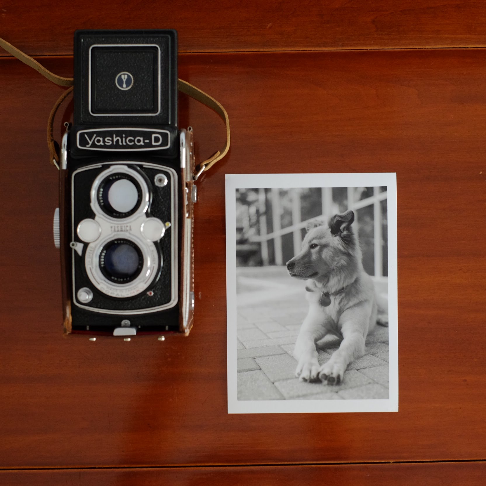

Big fan of my girlfriend’s Yashica D with the Yashikor. In fact, I was just printing a few negatives from it tonight and was absolutely blown away. I bought it for her knowing it had the “lesser” lens but after putting a few rolls of film through it (to test!) I really can’t see how the lens could be improved. It is sharp where it needs to be and renders everything else beautifully. It’s dreamy without being soft.
