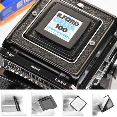

Oh, and for 10 bucks, you can buy one of these to remind you of what film you have loaded...

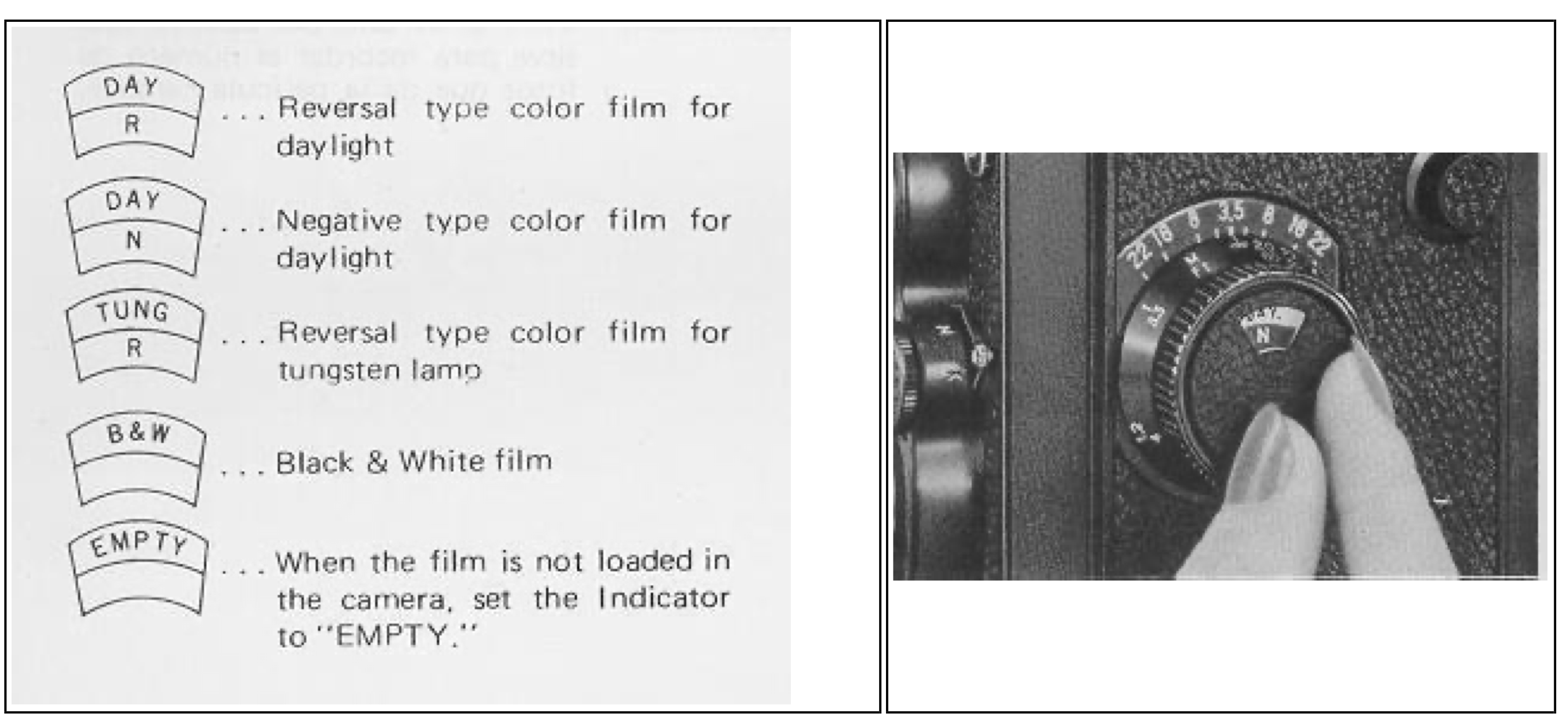

No need to 3d print anything there is a reminder built-in to the camera focus knob; maybe you can use it next time??

The meter on a 124G has an "ASA" setting also; that might provide a clue for what speed of film is loaded if you wanted to try and shoot the rest. I tend to use a little foldable strip of index stock stuck in the cold shoe with some hint as to what film I have loaded. (Since I seldom use flash or whatever one might stick in the shoe.)
Film reminder. For most of my cameras I write film type on blue painters tape.
Many films are no longer packaged in pasteboard box so there is no box end to use as reminder. Some cameras provide BW/color and asa indicator, but not brand and other details.
OH wow.....that painters tape!!
What a great idea.....won't leave marks on camera, etc.....I think I'll get a roll this weekend and start with that...economical and practical!!
I do this as it also lets me note the film type, the date the film was loaded and the ISO at which I was shooting it if different from the box speed.
