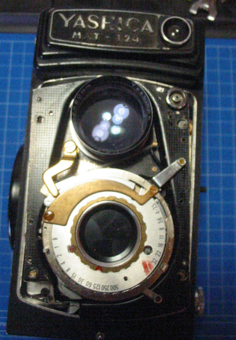

What I could see immediately :
  • missing screws (on the hood but not only)
  • meter « window » not in proper place
  • meter not working (see above…)
  • speed and aperture « window » missing
  • sticky shutter that would sometimes operate fine, but even in these cases winding it was necessary to have the leaves close fully.
  • Missing leatherette except on the back.
  • Focus was a bit stiff.
  • Somebody tried to do a paint job, I don’t know if they wanted it to look like a 124 « G » but they applied black paint in many places. I have no images of the initial status of the camera but this one gives you an idea...

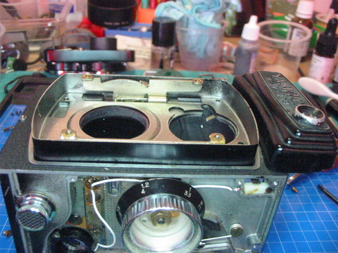

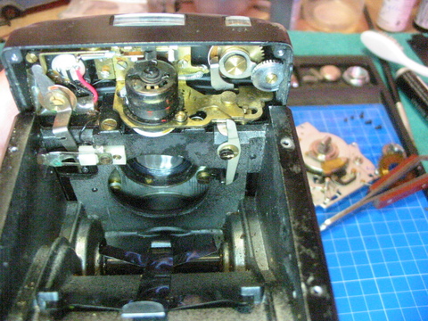

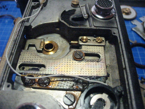

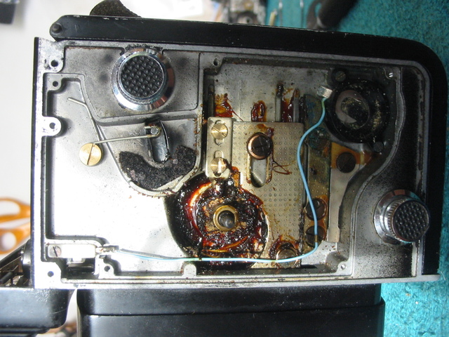

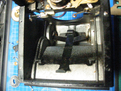

When I open the camera, I could see LOTS of grease, which seem way too much for me (I like mechanism lubricated just enough) so I plan to do a clean up, which may cure the stiff focusing in the mean time.

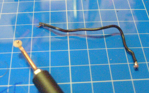

On the image below, notice I’ve already replaced the broken wire for the meter, which did not solve the issue (but the « window » is still in a wrong place).

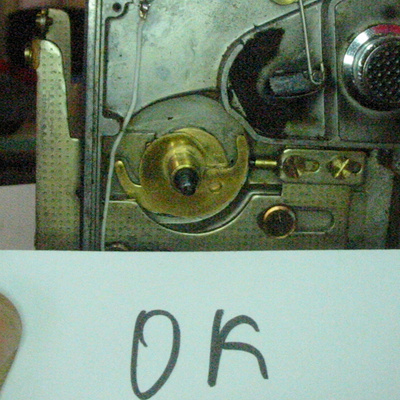

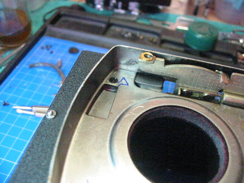

The first thing I did was to remove the meter assembly, and get the window back in place, held with some Pliobond (I hate this glue, as it smells awful, but it does the job) and… TADAAAA !!!* the meter works !
* ( I know, several exclamation marks are the indication of a deranged mind, according to St Terry, but well, I never pretended to be sane ! )
This is really encouraging as it shows the camera’s issues may be solved at home...

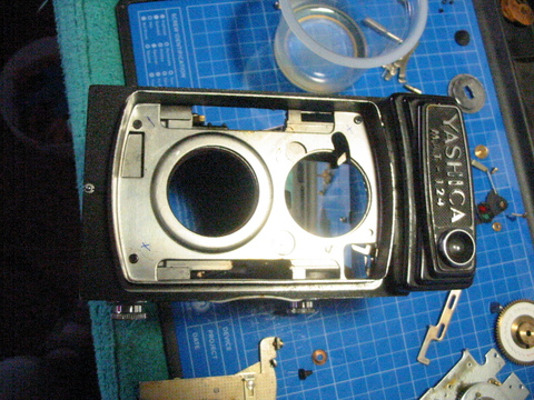

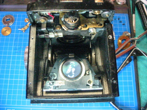

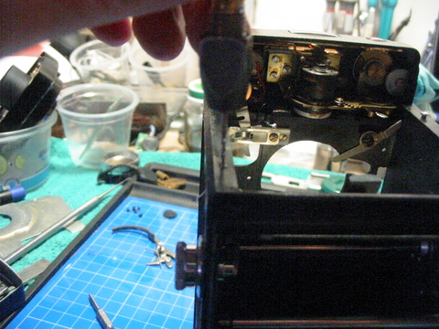

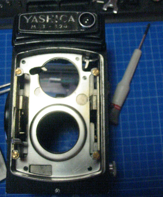

Removing the cover plate is easy, especially since there was no leatherette… Five screws and you’re done.

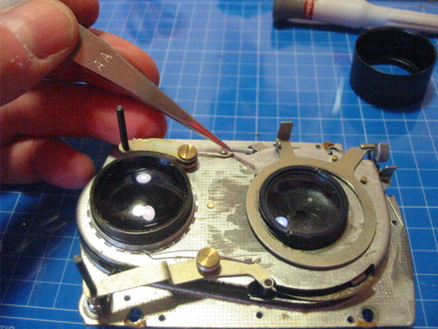

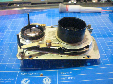

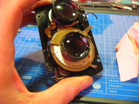

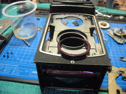

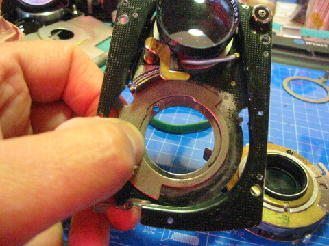

Next step is removing the lenses plate, which leaves you with an almost empty shell and the lenses and shutter on their plate.
Not show here : under the lens plate are some washers which manage the parallelism between the lens plate and the film plane… Make sure you do not lose them and you know where they go. The best way I found is that I put them back in place and screwed the screws back in place to hold them.

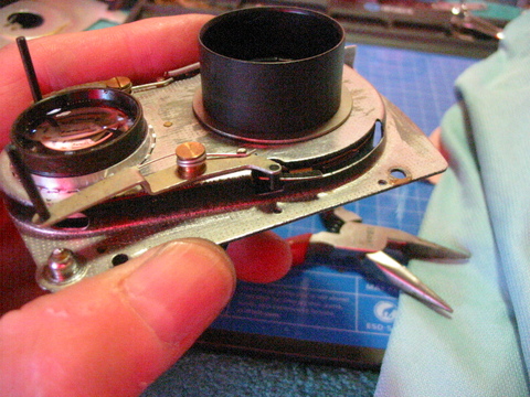

On the back of the plate, remove the ring that secures the shutter assembly and is used as a light baffle at the same time.
The ring you see there is part of the winding mechanism and is also used in the management of the triggering/winding process. Remove the tiny spring before you remove the ring.

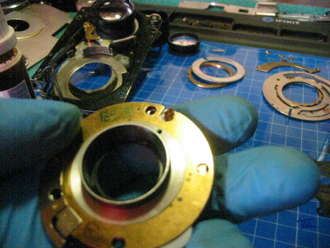

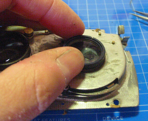

Or course, you will also remove the two parts of the lens. A spanner is indicated, my Mat shows sign of careless disassembly in this area.

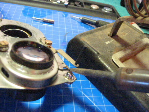

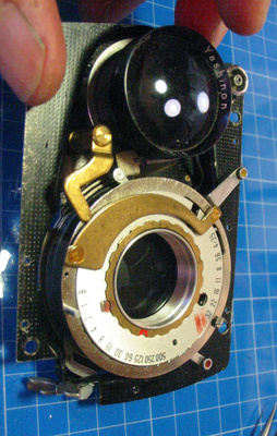

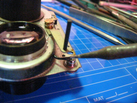

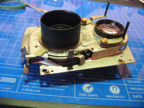

Next step is to remove the sync wire. My soldering iron is ugly and a bit big, but it does a good job as it’s powerful enough to unsolder in a second, which causes less damage than a weak iron that takes ages.
Note the viewing lens is still in place. I did not remove it so that I did not have to synchronize it again with the taking lens. YMMV…

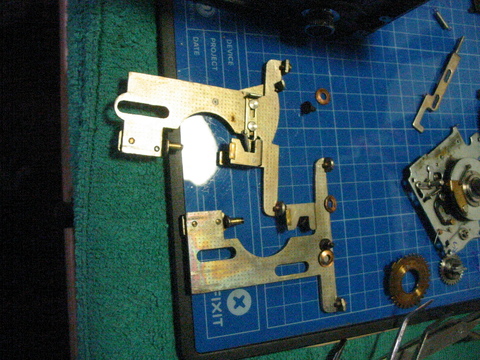

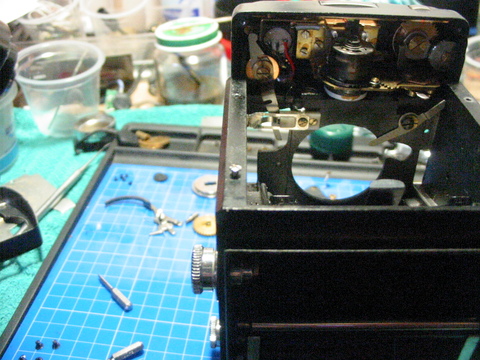

When the shutter is free, it’s time to remove everything until you can access the leaves for it and the aperture. This step is a bit scary, as one always wonders if they will be able to put everything back in place…

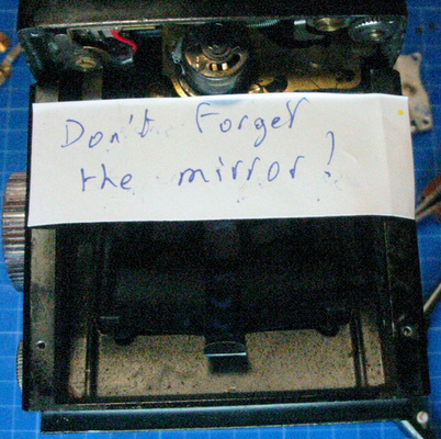

Important notice : take many pictures, and write down every f***ing step and every bloody detail you can imagine. You WILL miss some information at one moment, the goal is to miss as few as possible…
I followed the tutorial for this, so I won’t show everything. The reassembly will be covered with more details (but you still need to write everything down!)
At one moment, your work mat will look something like this :

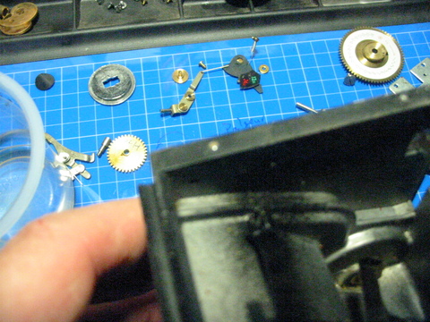

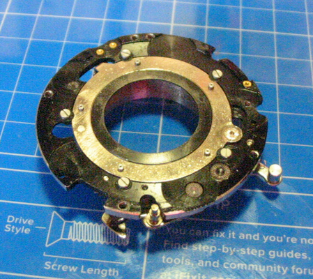

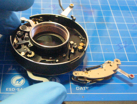

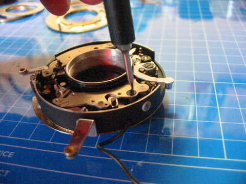

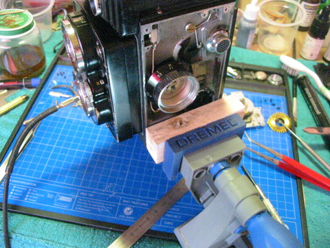

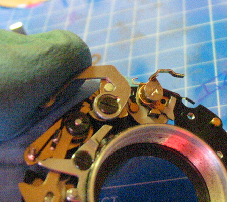

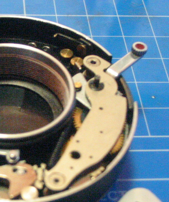

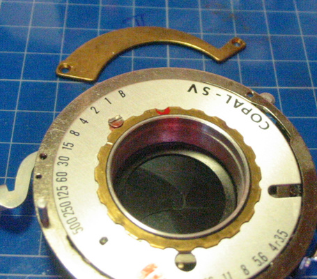

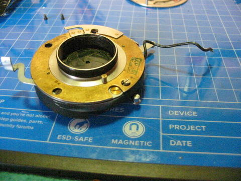

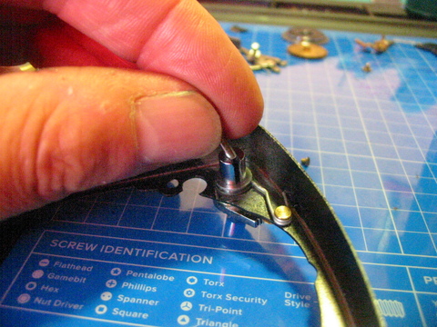

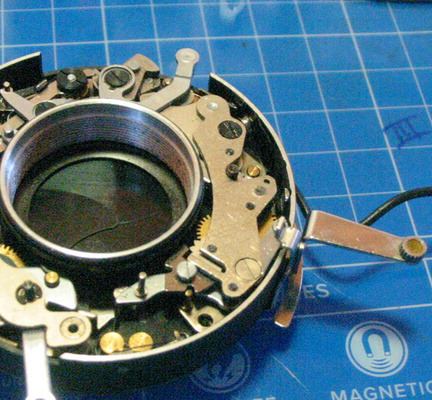

The shutter assembly is very modular, so it’s quite easy to remove almost everything.
The slow speeds governor is held by two screws, the self-timer by a E-ring (don’t let it fly away ! It’s very tiny)
I chose not to remove the shutter mechanism itself, as it did not seem necessary and is made of many individual parts. I’m not sure this was the best option, as there were some contorsions to remove the two mechanisms, but it was doable.
I removed the shutter trigger lever, it’s held by only a pivot screw (this is the large brass screw visible here). Freeing the shutter from its’ housing is done by removing 4 screws that appear when the aperture lever is in the right position (see the 4 holes in the back plate)

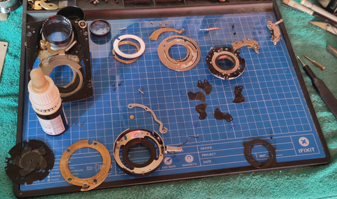

Surprise… when one removes the shutter from its’ housing, the leaves fall ! So now you know you HAVE to be able to put them back in place. It may be possible to separate the parts without letting the leaves get loose, but it’ll be tricky as the fit is very tight between the shutter and its’ home.
There will be smaller parts with the leaves, their rôle is not clear to me and I’ve read their place is critical. However, I was able to put the shutter together without knowing exactly how they were installed initially, with apparently zero issue… More on this later.

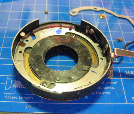

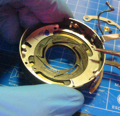

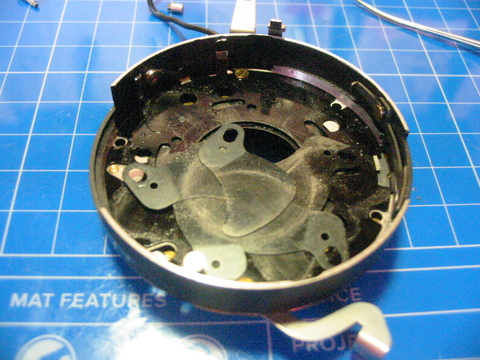

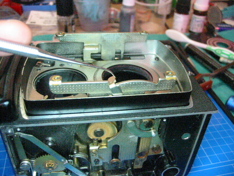

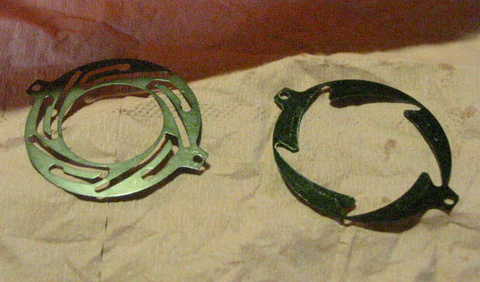

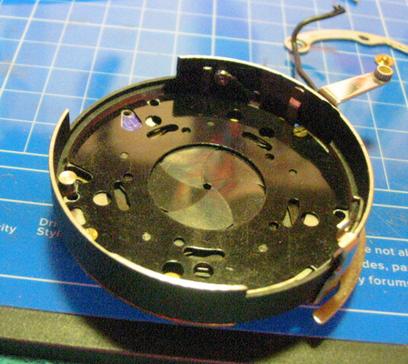

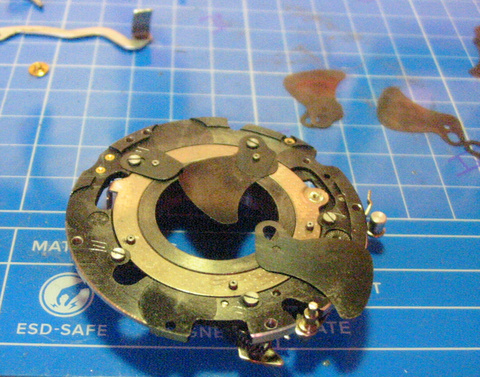

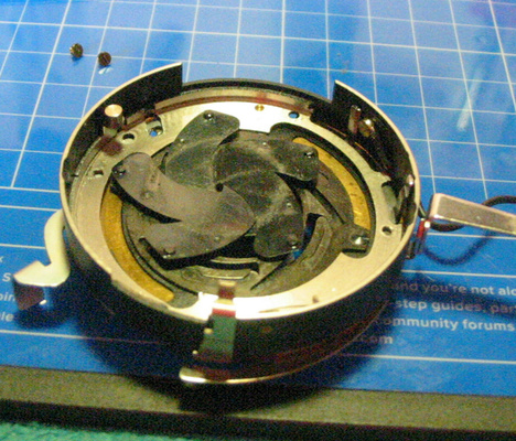

The aperture mechanism is below the shutter mechanism, in the same carter.
When you open it the leaves get loose and you will be able to clean them.
The blades are controlled by two discs that are connected to this bottom ring.
Notice the position of the two rings, there are many (wrong) ways of putting the back…

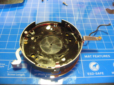

The rings are connected to the control ring by two tiny screws, and reassembling them can be tricky. I used « reverse tweezers » to keep everyting in place. (Yes it’s a very good idea to wear gloves, even when it’s hot ! It keeps your fingers « grippy » and saves the mechanism from getting some grease from your skin. The pictures when I do not wear them are usually from a dismounting phase)
This is not explicitly said in the tutorial, but the images show it clearly : putting the leaves back is much easier in the « wide open » position. In this position they are fully supported and will not fall.
Note the blue marks in the housing, they were used to remember the relative positions of the parts. The lines show the place for the axles, the « strange » shape at the top corresponds to an opening in the plate that covers the aperture mechanism.

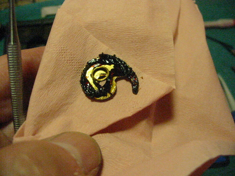

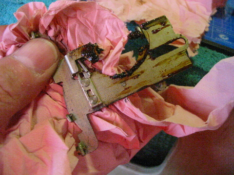

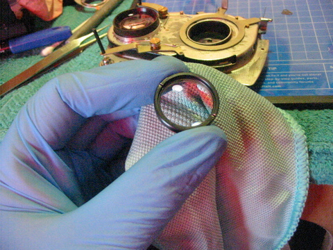

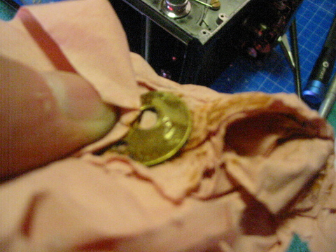

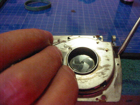

What is not shown here is that all parts were carefully cleaned, there was oil litteraly everywhere. I used IPA for this, and cleaning paper. I lubricated the pivots again with Nyoil (I used an oil-pick for this, what you want is the tiniest amount), and the leaves themselves with graphite.
When you are done properly, the blades should open and close smoothly. When fully open, they should disappear behind the plates.
Final comments for today:
- not shown here is that it took me several attempts to get the aperture back to a working status. Next time I'll be more cautious in writing every-effing-thing down.
- the tutorial says the remounting of these leaves and the shutter ones could be hours of fun...
- I can confirm, as this (including the shutter leaves) took me the best part of a day (think 4/5 hours on the bench)
See you later for the shutter part!

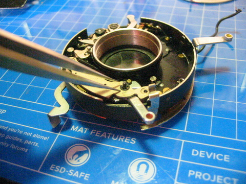

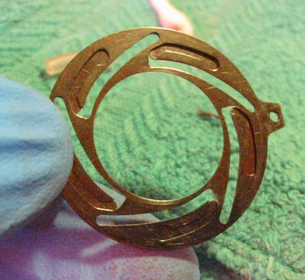

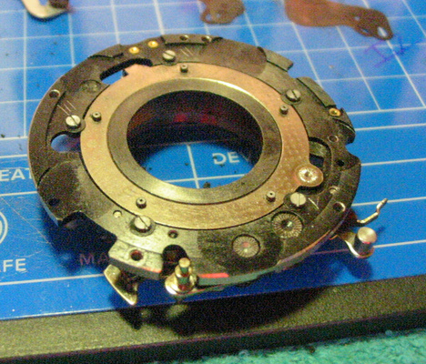

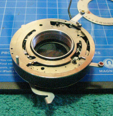

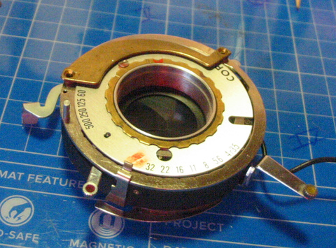

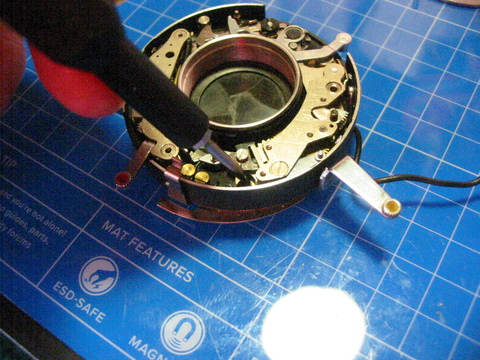

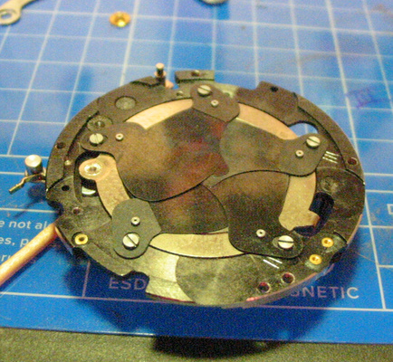

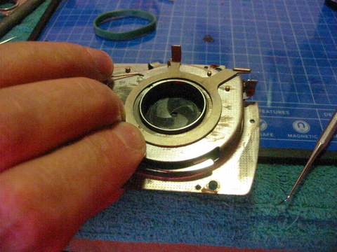

Now the REAL fun begins… let’s have a look at the shutter itself !
Of course, the leaves have been very carefully cleaned before attempting the reassembly.

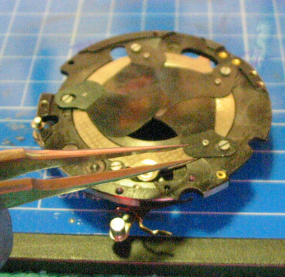

We are starting with the empty shutter plate, and will have to put the leaves back in place.
The general positioning is as shown below. The leaves have two holes of different sizes, so it’s quite obvious. Note the scribe lines (« I », « II » etc) on the plate, that help in identifying which blade goes where. You may notice similar markings on the work mat. Notice also that of of the spacers in is the wrong position (the one that sits alone on the « II » position)
The smaller blades act as spacers (at least this is my guess…) and I found that in my version I had to alternate, putting one spacer below the leave in a given place, then above next leave, etc. I’m not sure if I had 4 or 5 spacers to begin with, as I may have lost one (but I’m not sure and have no way of checking)
This is how it should look at the end.

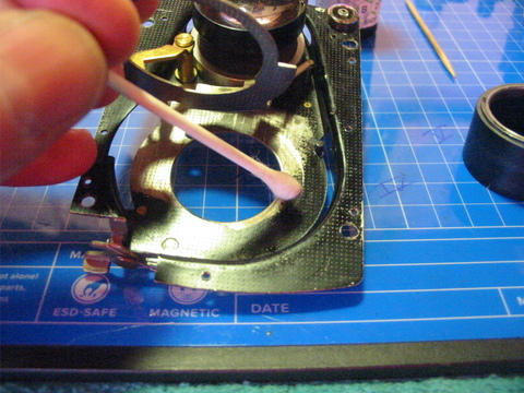

I applied some Nyoil on the pivots, again using an oil pick to put only piny drops in the right place.

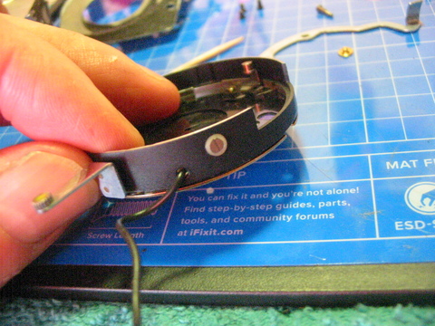

I found necessary to remove the flash sync contacts to have more room to put the mechanism back in place, so I did it at this stage. Note : I lost a small insulating part and am afraid Kapton tape does not do the job, so at the end I fear my sync plug is shorted. I did not try it yet.
I also removed the flash sync mechanism on the shutter main plate , as it was an additional protruding piece.
Putting the shutter plate in the housing is a matter of patience and profanities… You have to blindly put the plate in the housing without seeing it (it has to remain in the position where the blades are on the up side, otherwise you’re back to start again. Don’t ask me how many times it happened (the most stupid is when I wanted to see where I was stuck… You may want to tilt the housing a bit, as some of the remaining parts are obstacles to putting everything in place. I guess next time I’ll remove everything and will see if it’s easier.
When you are there, put the four screws holding the plate in the housing back in place (the four screws that appear when the aperture ring is in the right position) so that the shutter is secured.
NORMALLY at this stage, you should be able to arm and trigger the shutter, you will only have Bulb, but you’ll be able to check the shutter operates crisply both on opening and closing. This may be the right moment to apply some graphite on the blades, as a lubricant.

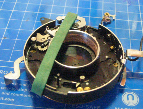

To put the flash mechanism back in place, a rubber band is used to keep the winding lever out of the way.

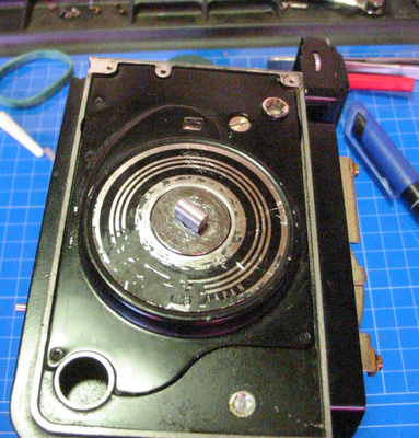

Next comes the self timer. It is held in place by the small E-Ring (I hope you did not lose it!) and « indexed » by a brass post.
Then comes the slow speeds mechanism, which is secured by two screws.
After these two parts are back in place, you can have the control ring on top of them. It should get back easily, and gives you a way to test different speeds.
If you are satisfied, you can then put the « nut » that secures it, and lock it in place by turning the « half screw » (not really a screw, but it has a slotted head). In my case it took a bit more than one turn to have it back in the same position. I’m not 100 % sure this is critical, but why take risks ?
Finally for this side, you can put the cam that transmits the speed information to the display on top of the camera. Two screws and two washers do the trick.
