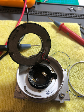

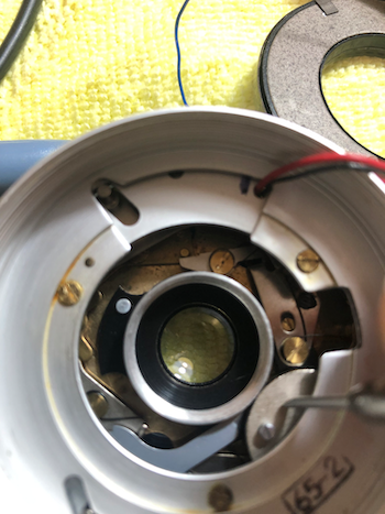

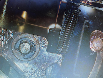

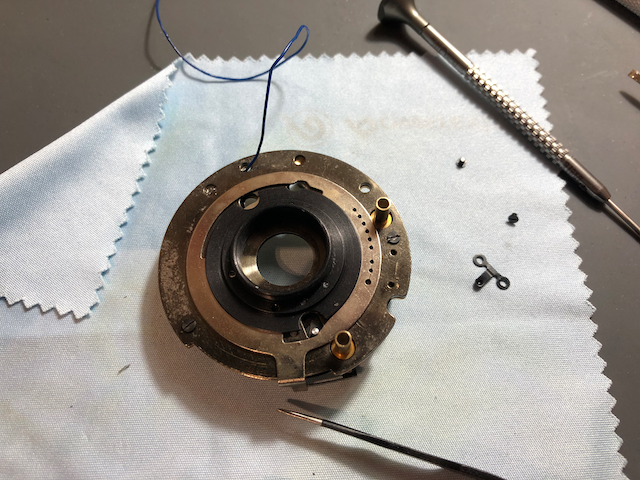

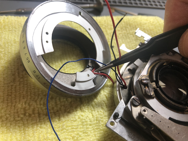

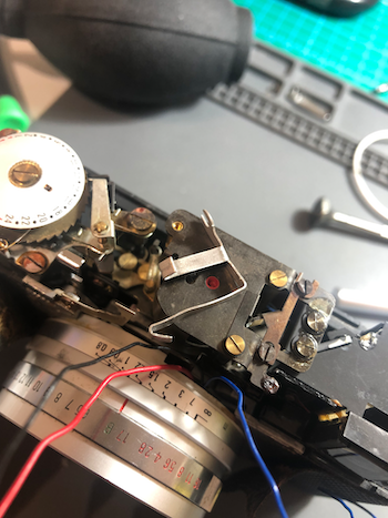

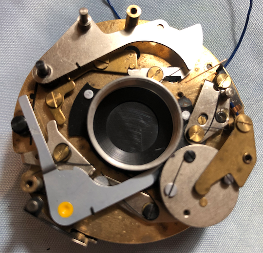

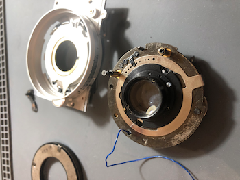

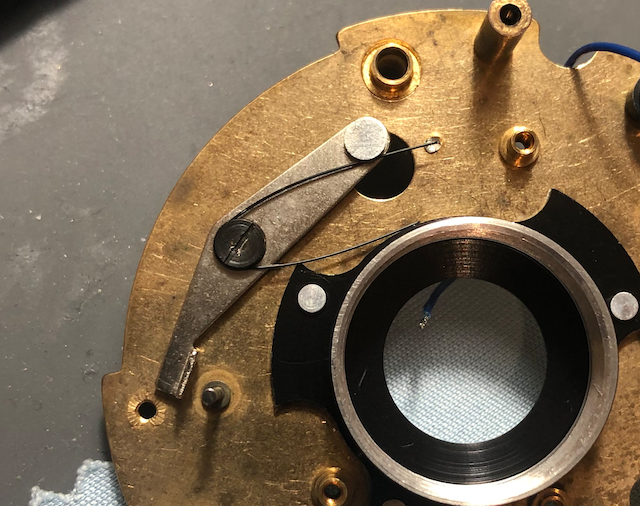

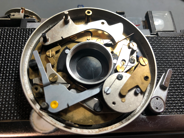

The mechanism as I found it
At this point I had removed the top rings of the lens, and de-soldered the red and black wires of the photocell.

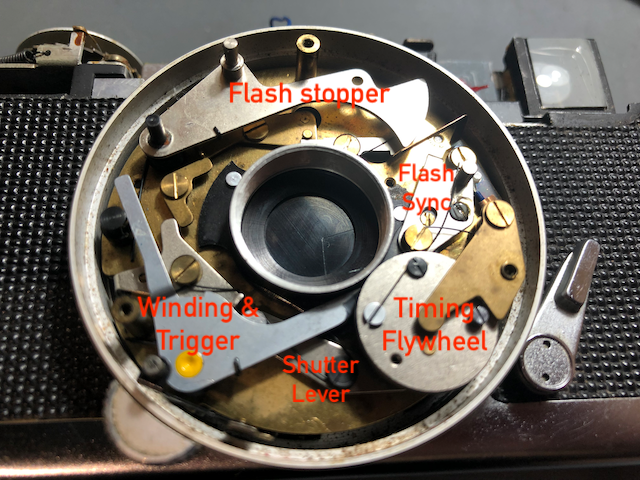

Immediately you can tell Japanese ingenuity and simplicity. Basically this is mostly the camera, self-contained in the lens!
These are the main components from the front. These are probably not the technical terms, feel free to correct my layman's language:

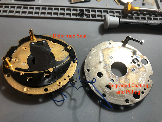

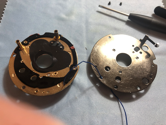

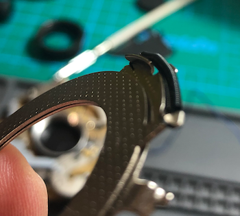

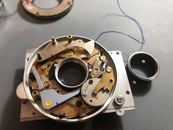

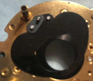

Why the shutter was stuck
The shutter is sandwiched in between two plates. The front plate holds the mechanisms shown above which are basically most of the trigger, timings and flash sync. The back plate holds the iris control/limiter or f-stop, and the shutter blades are sandwiched in between. By turning the iris control (not seen here but you will see in the rebuild pics), the shutter is forced to stop opening at a given setting. Maybe all early cameras worked this way and it's the origin of the term f-stop - please comment if you know more.
The blades rest on a brass plate, whilst the top plate is some kind of tin alloy, which seems to be coated with something that degraded over time, OR by some liquid used to try to un-stick the shutter. It may also be leftovers of some light lubricant coating, who knows. Comments welcome.
The Fix
I polished the brass and the allow plates with fine-grain car-paint rubbing compound used to remove light scratches. I figured it would leave a smoother finish than an aggressive metal polish compound like Brasso, etc. After that I washed both plates with dish soap and warm running water to make sure to remove all the rubbing compound that will find it's way everywhere, especially the iris control mechanism which I did not remove for this. Then I blow-dried both plates to make sure no water was left anywhere.
After that, I carefully cleaned every surface and the shutter blades with lighter fluid and a lens microfibre cloth. I also cut the deformed light seal and mended with some red putty used for crafts, for exterior use, which is very stable at wide temperature differences. It's the type of white putty you would use to stick paper or photo to a wall and then remove without damage, but for exterior use which is red.

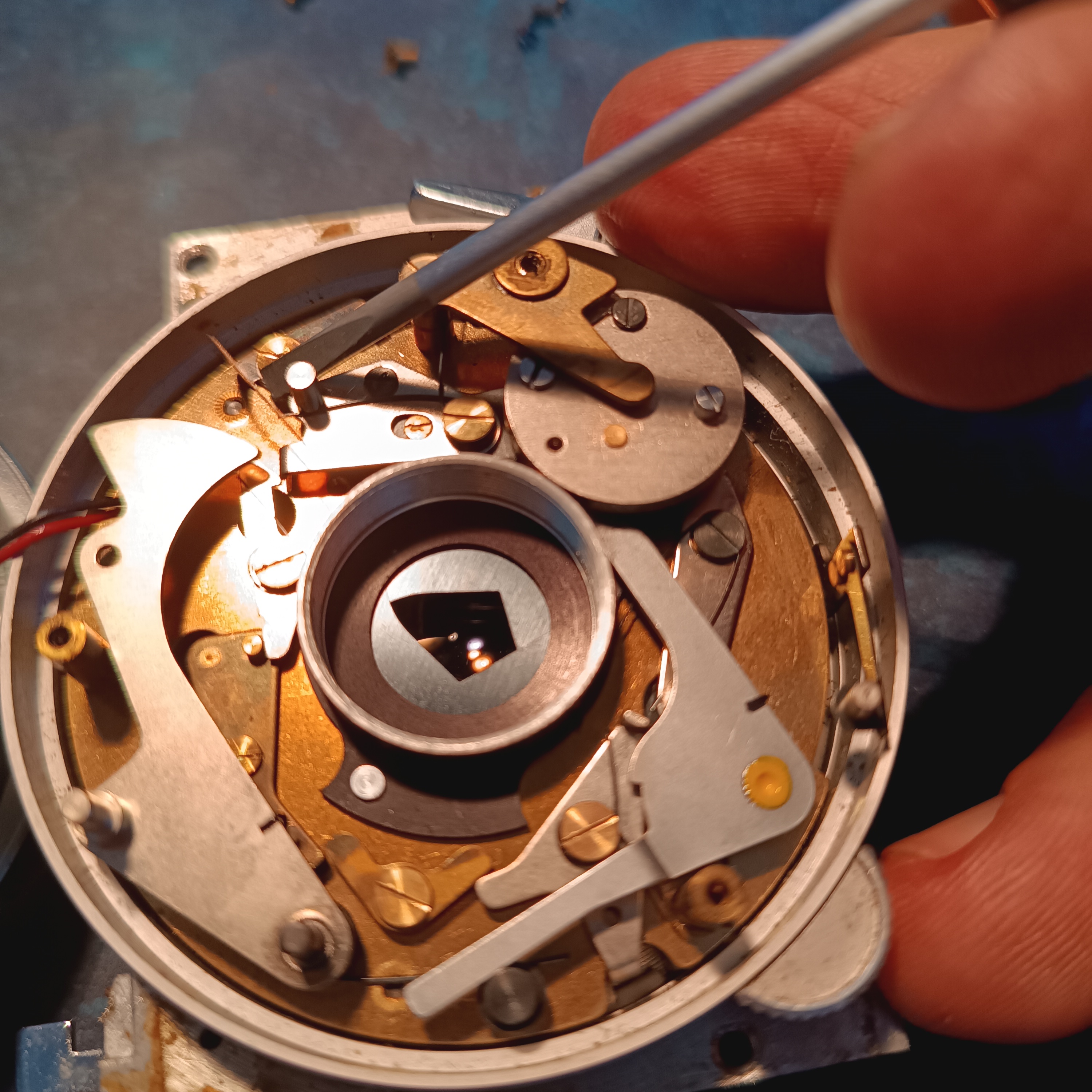

Step 1: Shutter Blade Assembly

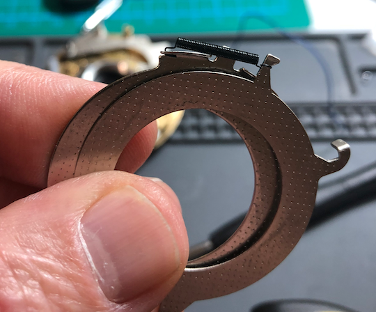

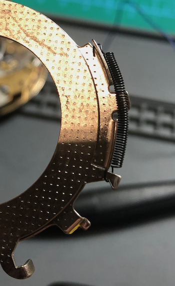

1a: Attach Shutter Lever and Spring
You need to re-attach the shutter lever in order to re-assemble the shutter blades.
NOTE: I made a mistake here which I later corrected. Note that the spring has a long leg and a shorter leg. The longer leg is the one that should lean agains the lens mount.
WARNING: Also, note that the black steel screws are VERY fragile, only tighten 1/16 of a turn after it stops! I actually broke this one and another black one which you will see a non-critical part I had to glue with resin. In this case I was lucky and I was able to remove the stub. You have been warned.

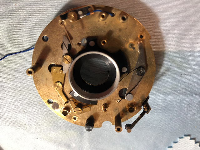

1c: Completed Shutter - Ready to Close
Here is the shutter assembly ready to be closed. Note the polished surfaces, the repaired and repositioned light seal, and most especially the position of the flash wire.

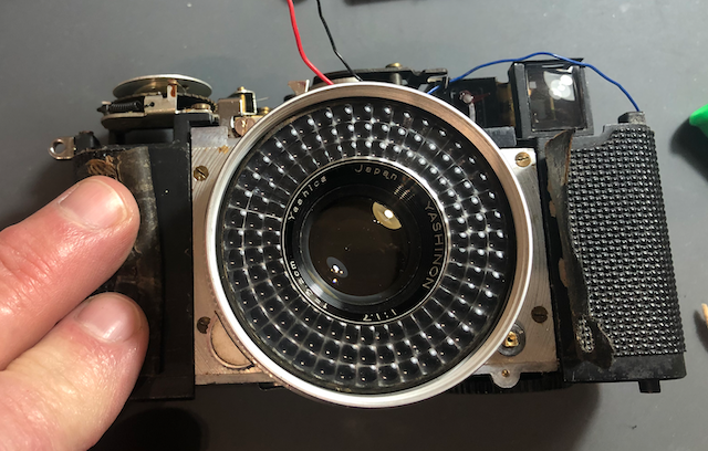

At this point the whole lens assembly is ready to marry the body.

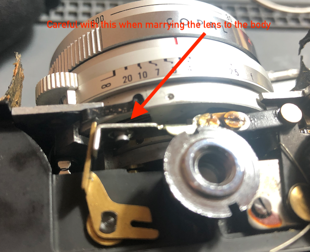

4b: Marry the Lens Assembly to the Body
The lens assembly should fit right in with almost zero effort. If not, carefully double check and don't force anything. There is a lever on the bottom which may get in the way, look the sequence below:

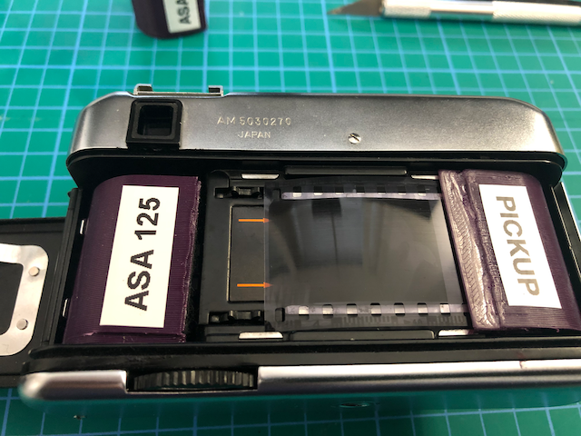

LOL, not at all, but thank you ! It's the first time I do any serious work on a camera, but I have worked in electro-mechanics, electronics and high tech in general for many years. I got back into photography recently to teach my kids this old forgotten art.
In the next thread I show how I 3D printed the Rapid cassettes to be able to load the film and shoot some actual pictures with the Half 17.
Stay tuned !! Here's the teaser:
Interesting...is that cassette to cassette?

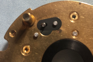

reviving an old thread on an even older camera: Yashica half 17 Rapid. Alexo has been kind enough to document his work on this camera. I am fortunate that mine has a happily clicking shutter. What puzzles me, is the shape of the aperture. It's created by the two shutter blades, but shouldn't it be more squarish?

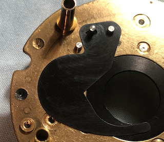

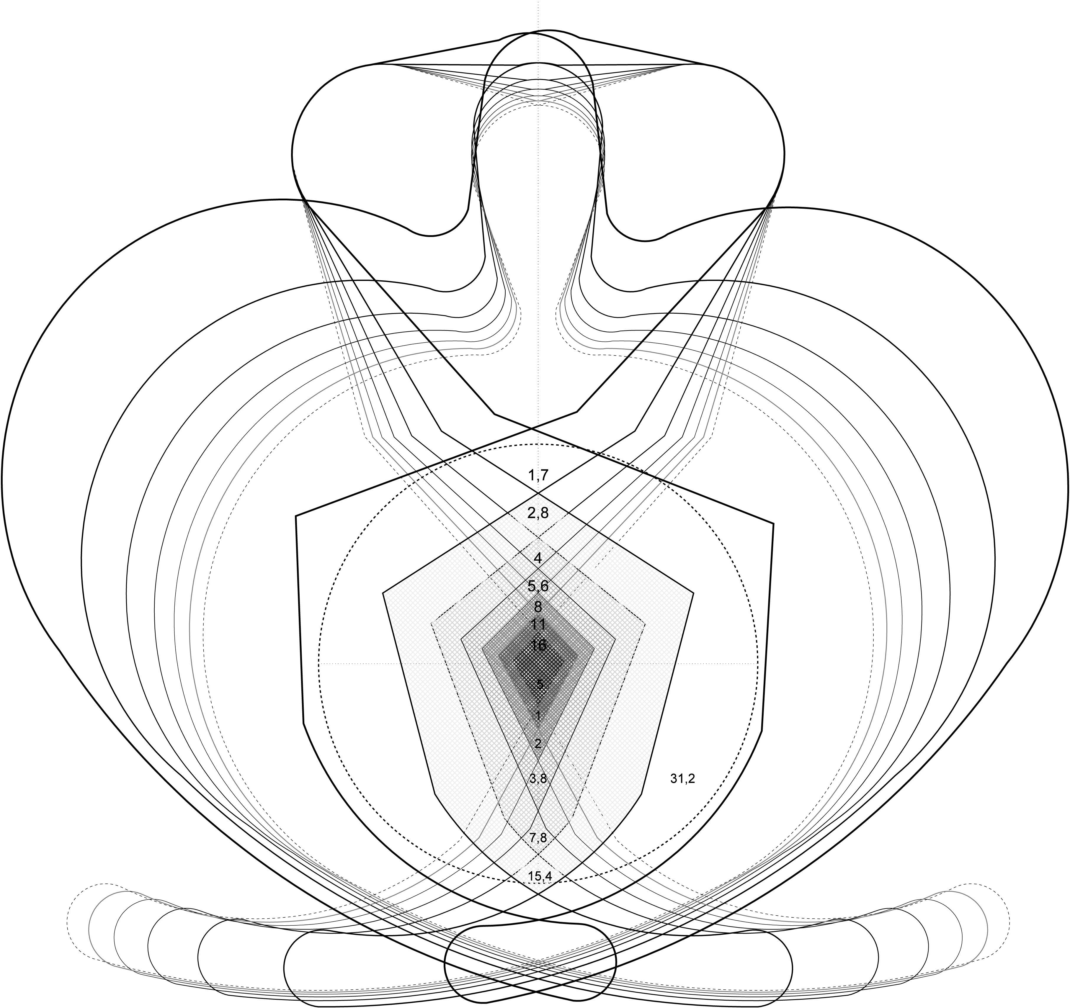

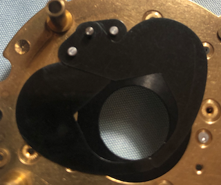

I figured it out. It's a very smart shutter/aperture system, just not photographically optimal. The shutter blades form the aperture. The speed of the blades is always the same for all stepless exposure time/aperture combinations. The exposure time for a small aperture is shorter, because it takes little time to cover the small aperture. Vice versa for wide open. It takes more time to cover the full opening, so the exposure time is longer. This means you can't choose the aperture independently from exposure time, since they are coupled.

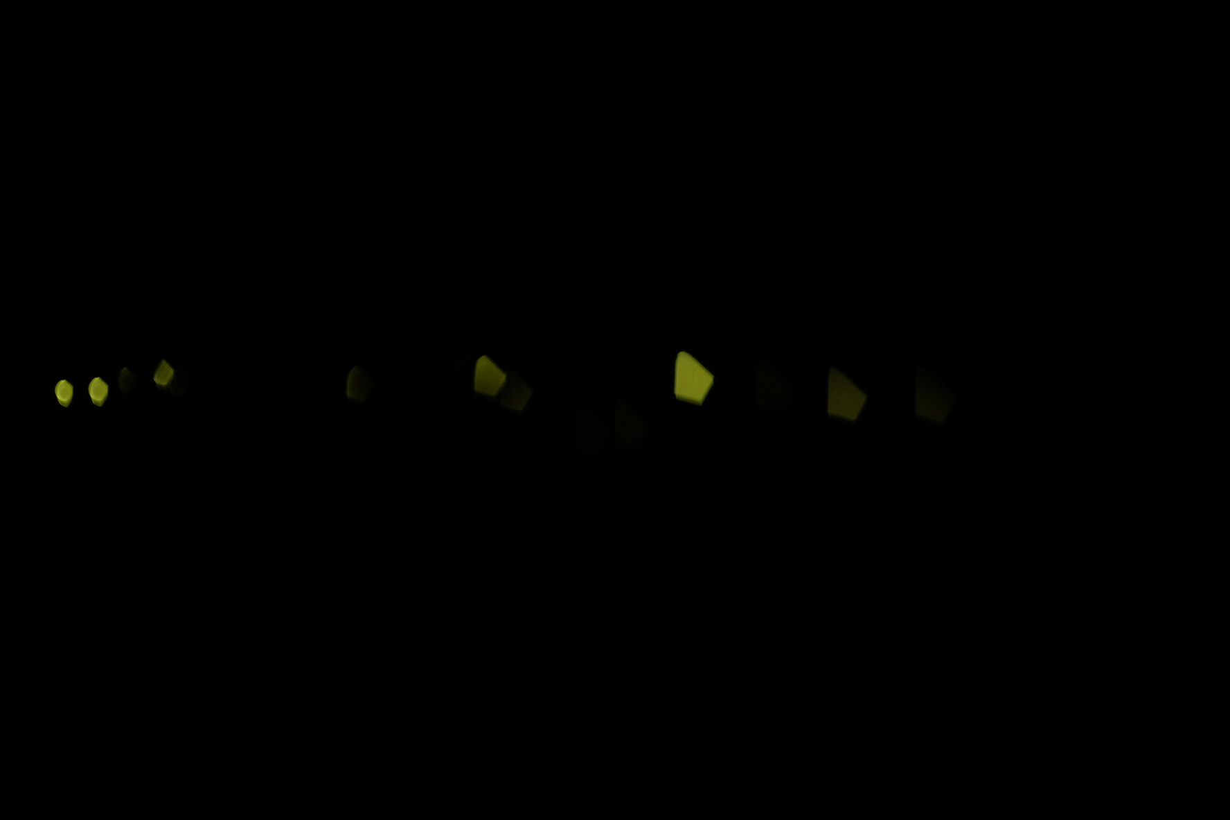

Using the shutter blades as aperture creates crazy bokeh shapes if not wide open:
This is the layout of the heart shaped shutter blades. Not quite centered, but mostly close. The darkest spot is the smallest aperture.
Being fully mechanical is the beauty of this half-automatic shutter system. The electric bit is only for the match-needle indication for the aperture/exposure choice.
