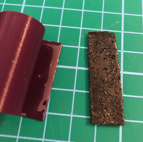

c) Glue a piece of felt on the inner lip of the cassette using contact cement. Make sure you don't saturate the felt but only speak glue thinly on the surface only.
NOTE: Although the felt worked OK, I need to find a better material than felt that doesn't release fibres and that doesn't absorb glue.

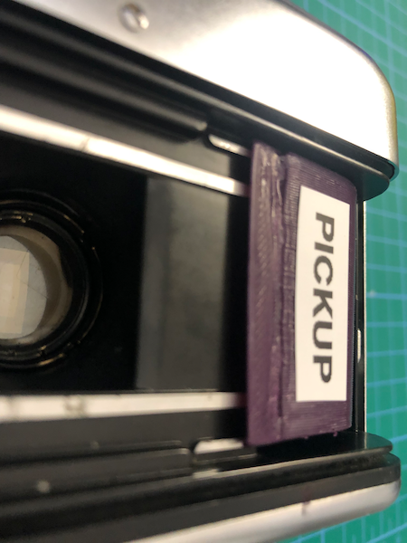

f) For the pickup cassette, follow the same procedure above as if making an ASA 400 (6mm tab) but without felt. Then glue the pickup lip as shown:

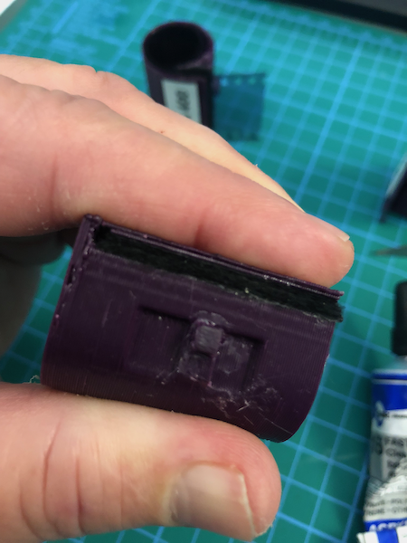

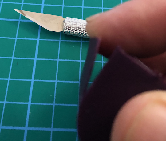

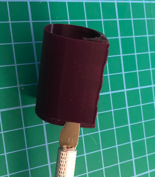

a) Cut and separate about 15mm of the upper lip from the shut side:
View attachment 357557View attachment 357558

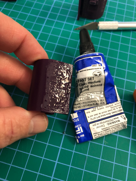

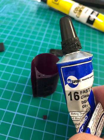

b) Glue the Tab using a good PLA glue. I use SciGrip 16 Acrylics because it's the only glue I have found that glues PLA like a steel weld.

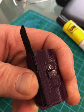

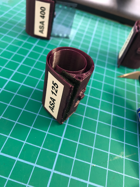

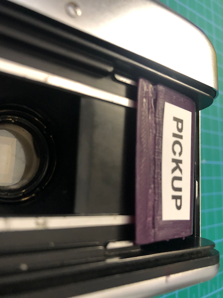

d) Glue a piece of felt to the inner film spring with contact cement. As in the previous step, you must wait at least 10 mins for the contact cement to fully dry before pressing on to the part.
e) Glue the spring to the main body of the cassette. Label the finished cassette according to the tab length you printed. In this case it's a 3.5mm tab corresponding to ASA 125
View attachment 357565View attachment 357566View attachment 357567
