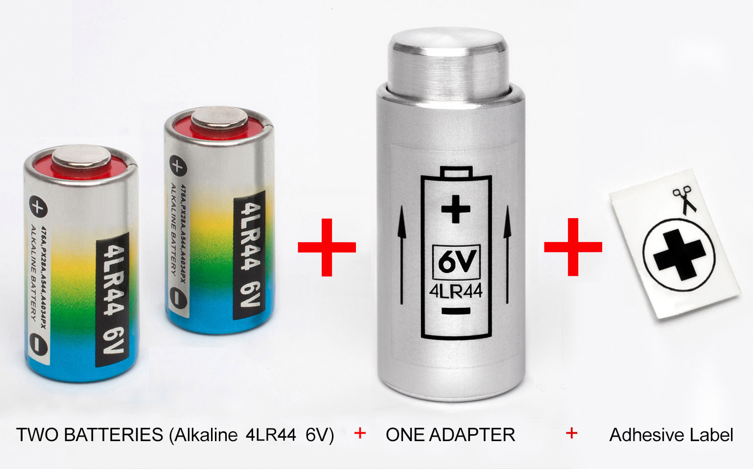

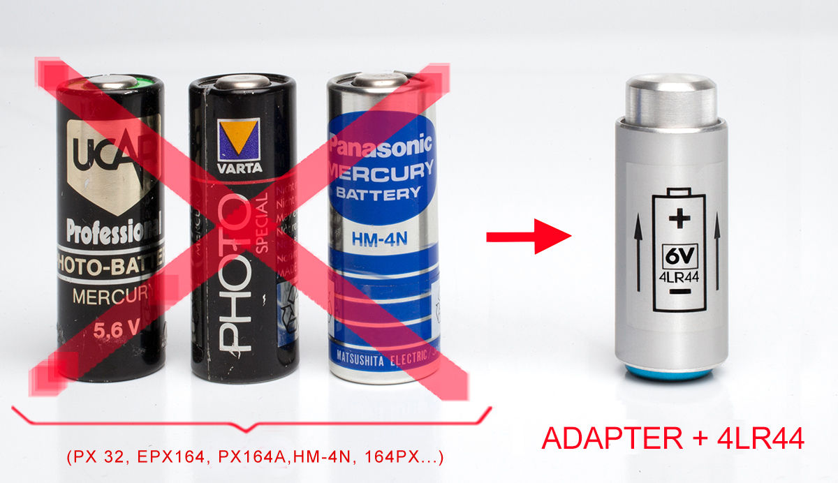

Ya know, I was surprised to see it had an adapter in it to use 4x LR44s already, So I might core out the edges of the inside to fit a px28 I have lying around from my broken TL Electro X
