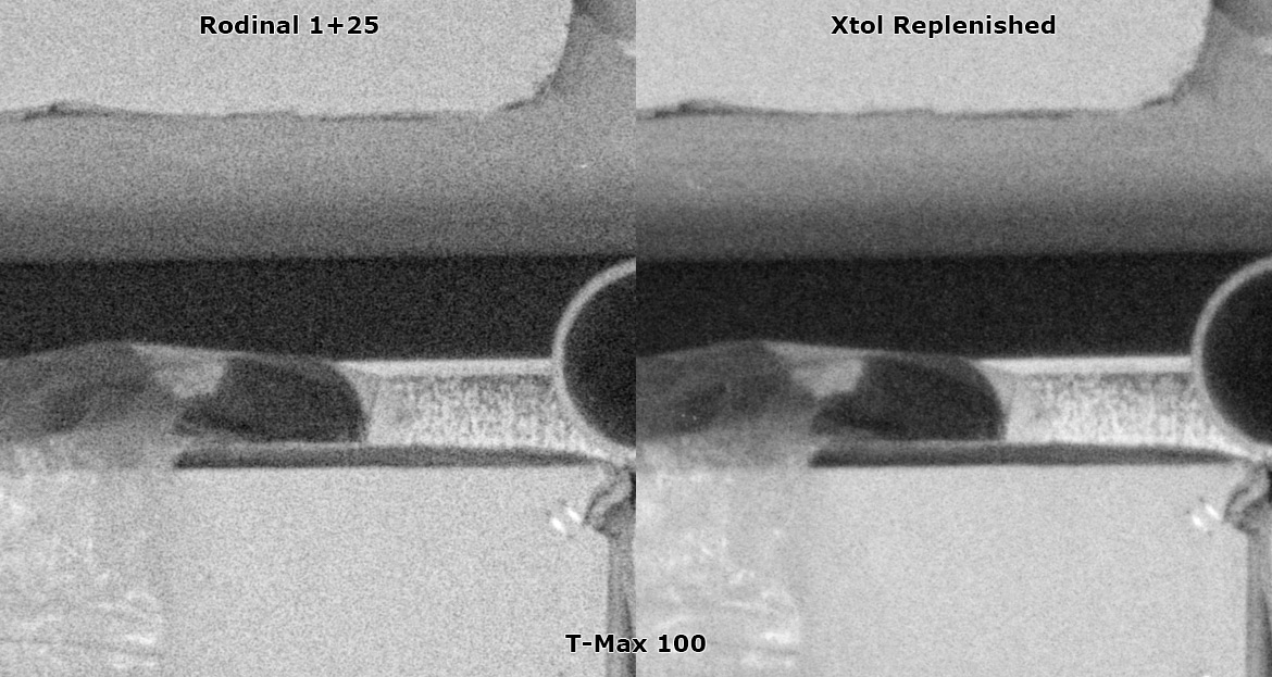

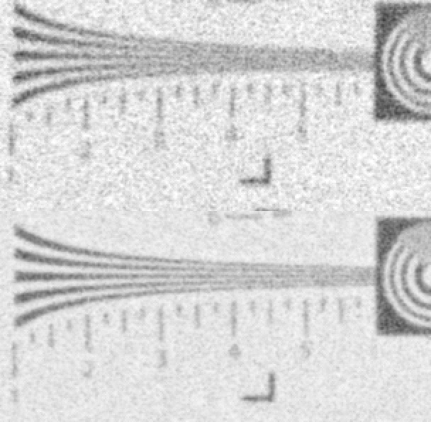

I found some test samples that people might be interested in, based on T-Max 100, so you can see what is happening.
The grain itself becomes lower in contrast, so appears smoother. Not an issue on T-Max 100, but on rougher grain films, this might actually cause issues in shadows and blacks if you want your shadows to appear black rather than grey or smoky. If you try to set levels or print shadows that are black, you may find either the higher contrast grain makes it appear smoky, with sparse grain. It can also improve details somewhat too.
Fyi, in the last example, the modified Rodinal has had potassium thiocyanate (which is what makes it become fine grained) and potassium iodide added if I recall.
Obviously dont use T-Max if you want the appearance of grain in your images.
