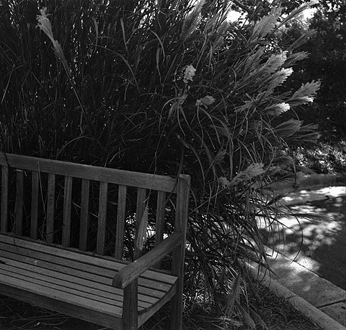

.EDU Ultra (Fomapan) 400, Parodinal 1:50, Super Ikonta B (80mm f/2.9 Tessar).

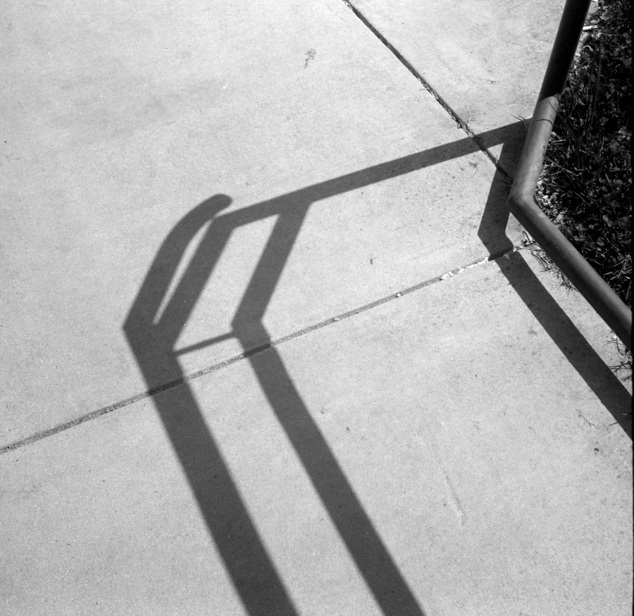

.EDU Ultra (Fomapan) 400, Xtol Stock (replenished), Super Ikonta B (80mm f/2.9 Tessar).

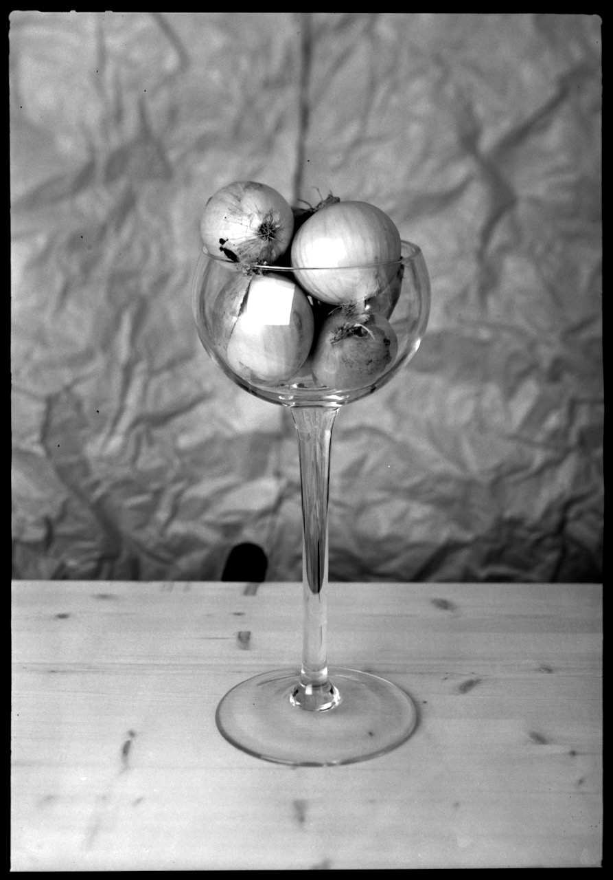

5x7" Foma 100 @ 50, Rodinal 1+25 with 30sec agitation interval (DSLR'ed on light table)
I see mid tones :wink:
I see a bit of contrast boost in that shot. Lovely picture, though the white areas are blown out a bit.

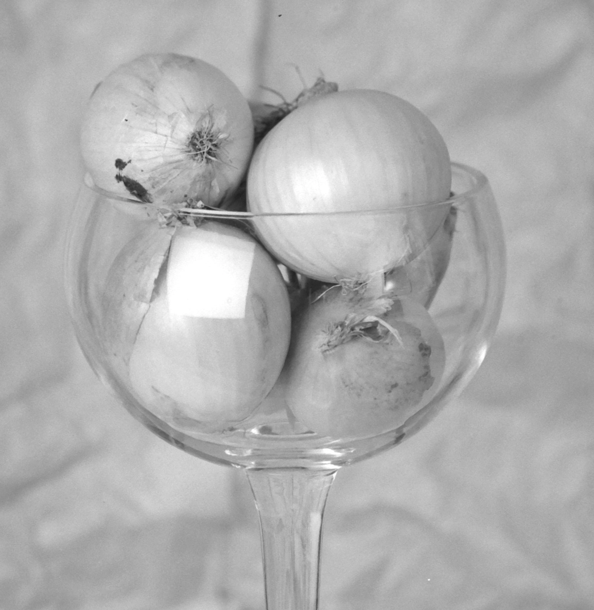

Hey thanks. And you are right, I had boosted it and too much.. Here it is with linear curve.

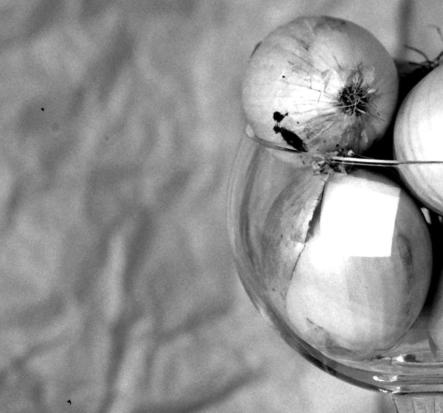

Certainly not as dramatic a shot as the first one. The white is still almost blown out- I wonder if that was the DSLR doing that? There is noticable grain for a 100 speed film at 5x7 size. I wouldn't have expected to see that in these pics.
The negative was shot just to make a digital contact print so it might be that I have not exposed long enough when shooting with DSLR. I just do it handheld and approximate the exposure.
Nice that you noticed the grain :smile: The recipe is from another thread where question was how to achieve "normal" tone but visible grain. I wanted to try the same development recipe for sheet film. I think I can see the grain with plain eyes from the negative (or maybe I'm just biased). The recipe is just overexpose - overdevelop with more rapid agitation interval.
The highlights might be blown on camera or maybe those are just dense because of the development method..
