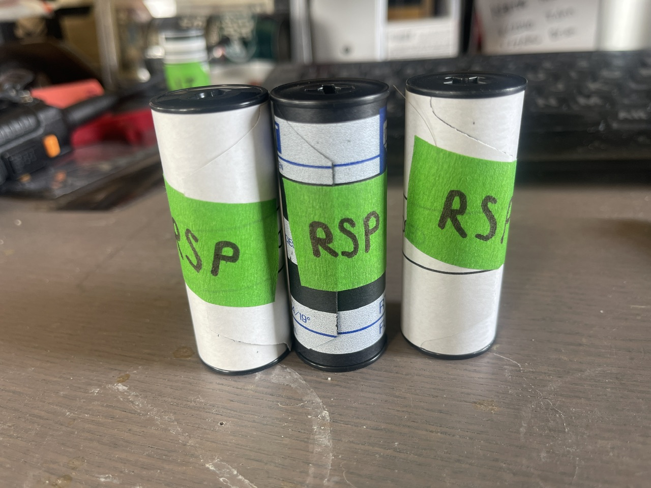

My method: Rubber bands or 3d printed film clips to keep the roll secure, and then into 120 film canisters and/or dark bags for added protection.

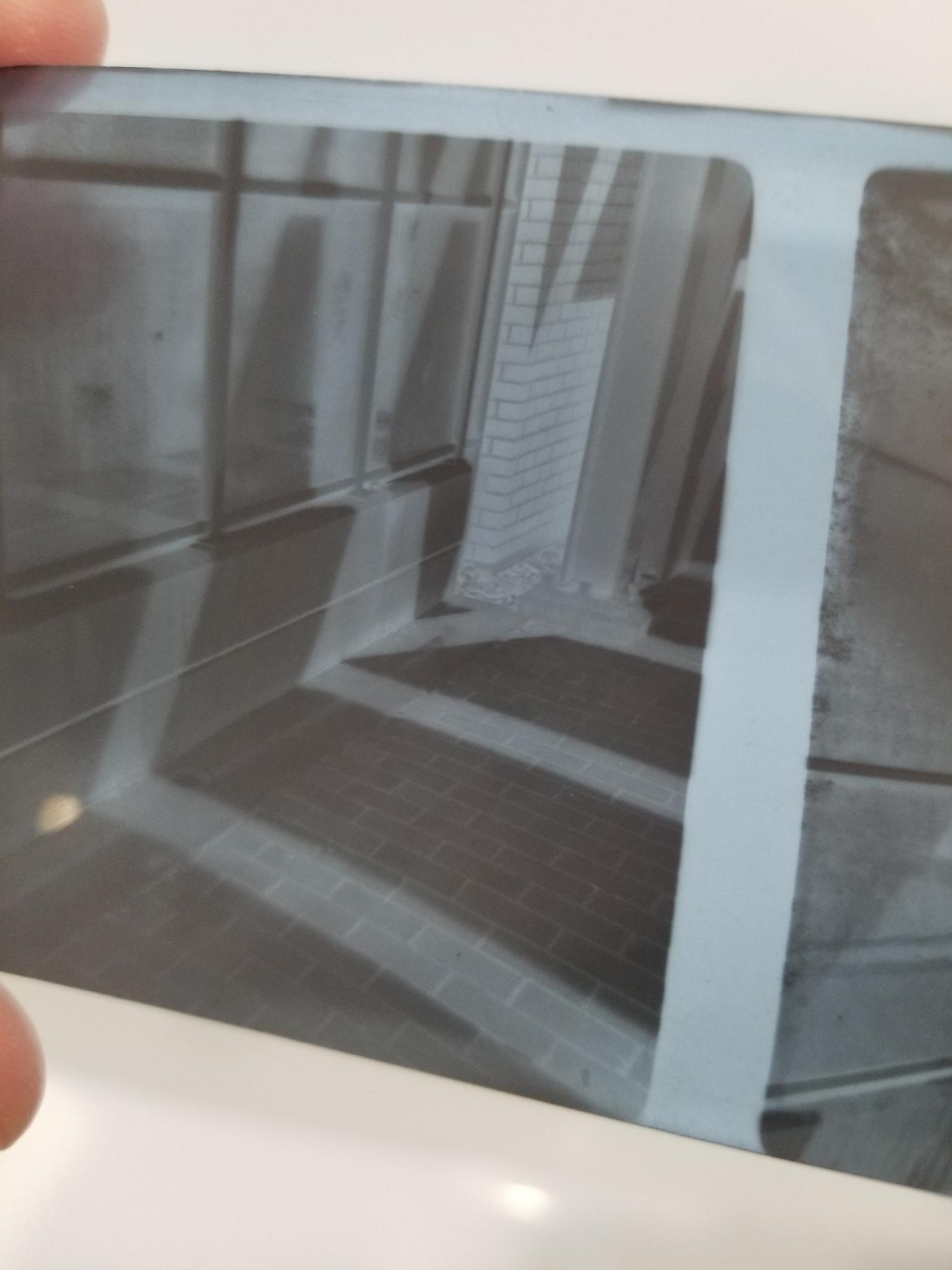

Is this xray film with emulsion on both sides? Maybe the gelatine in emulsion on the side in contact with the backing paper has affinity for the pigments in the latter.
Yes it has an emulsion on both sides. I would have assumed pigments were just lamp black in glue for all backing papers though. Kodak ones are very glossy and ilford are matte, I am guessing more so than pigments it's like a lacquer or something

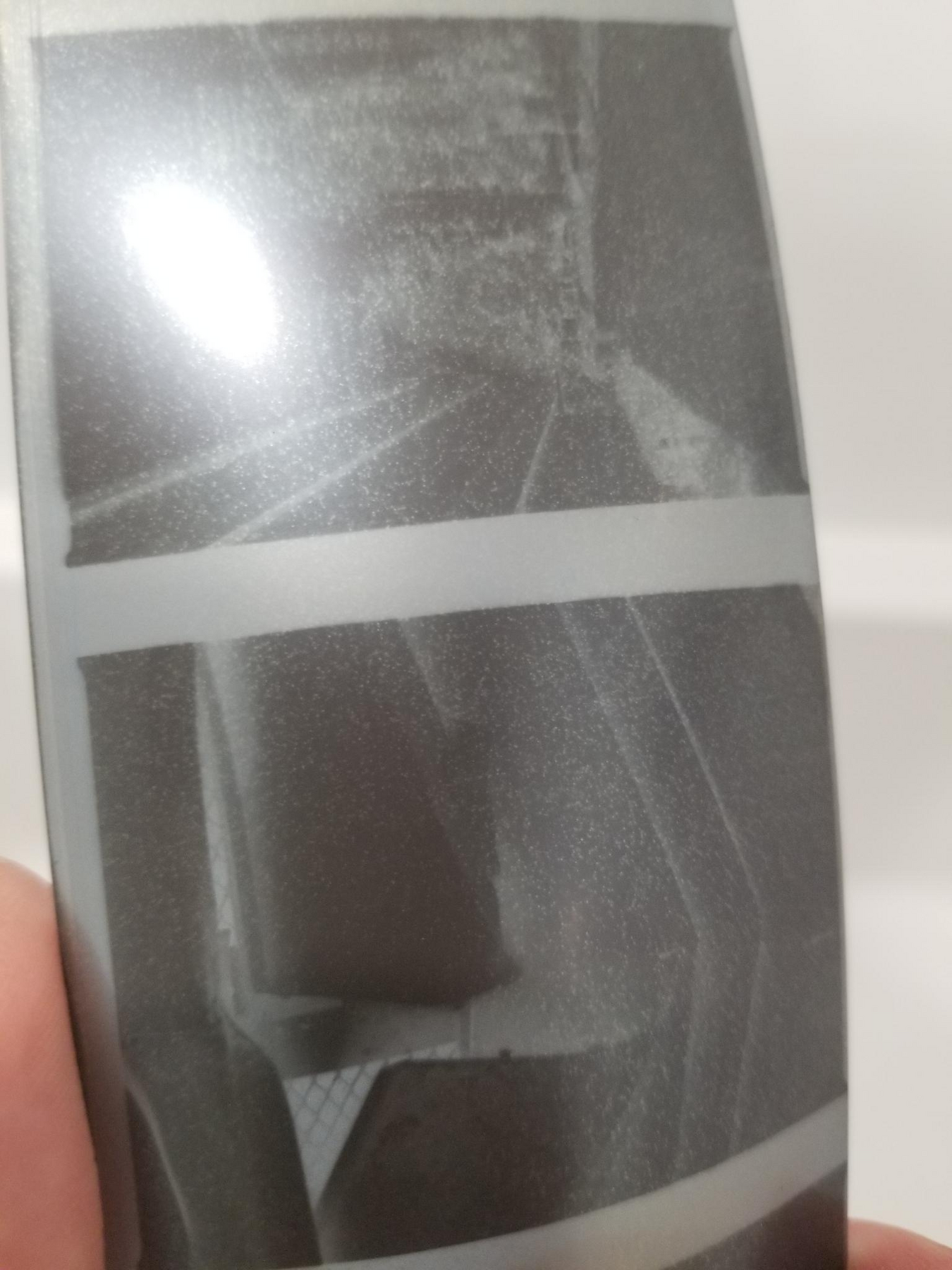

A normal (bluer clear one) photo using ilford paper, versus a kodak papered one. This speckly heavy fog (all on the one emulsion side not the other) is almost as dense as the photos
The numbers and letters on traditional backing paper are printed using the modern soy based inks that the printing industry has transitioned to. The old inks that were formerly employed are no longer available.
The backing paper is a highly specialized product, only available from a very small selection of specialized paper suppliers, printed using very specialized techniques, with long lead times and immensely expensive minimum order quantities.
In almost all cases, modern film emulsions are far too complex and sensitive to not interact with simpler backing paper formulations.
Whatever it is, it was not designed keeping double-sided xray emulsion in mind. 😄 In applications such as yours, I guess one just needs to find something that works and continue use it. It is good to know that Ilford backing paper has been working fine for you.

One plausible reason could be that Kodak films don't have gelatine in the non-emulsion side whereas OP's film being a double sided emulsion has gelatine as noted in post #11. Now, with exposure to ambient moisture, the gelatine in the double-sided xray film could be locking up with some stuff in the backing paper.
