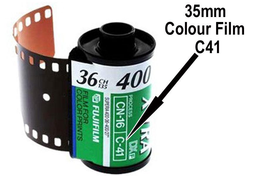

All C41 colour films have the process designation marked on the film cassette, including chromogenic B&W films.
