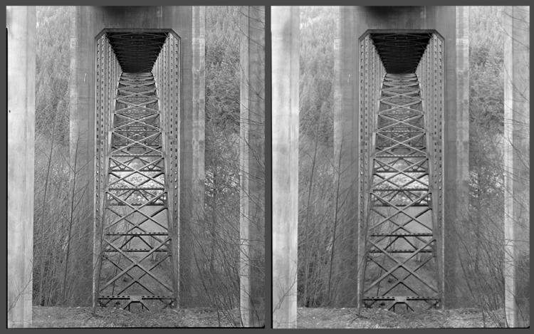

Here is an example of stand (in hanger) VS standard (tray) development. Both in pyrocat-hd. Stand image is on the left. It is slightly sharper.

Thanks andrew. The stand developed Neg looks a lot sharper. Is this normal? If it is that is the direction I am going.
Jim, I don't know if your comment was aimed at me or BVY, but I shot LF for almost 15 years. Granted I have not shot a sheet of film in over 4 years but the learning is ingrained. I have also targeted negatives for traditional papers and POP papers.
Yes, it's normal.
