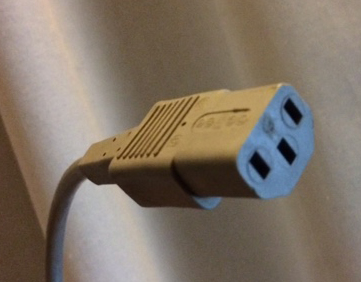

HILO, I saw the computer cord you pictured--the slots are too narrow. I've been to a variety of electrical and appliance parts stores and a hardware store and a big-box DIY store, but no luck!

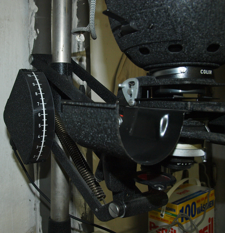

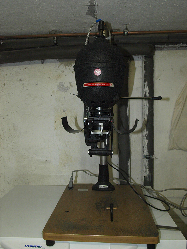

There certainly are Focomats 1c with recepticles positioned at the left rear and on top of the baseboard. I imagine that's where yours is positioned? I attach some pictures. And: Leitz did make (early models) two-prong plugs and receptibles for inside the top of the column that were earthed as well (by something surrounding the prongs) . . . it is very likely that the same model had a 2-prong recepticle/plug on the baseboard as well . . .
Some other things that may help:
- is the illuminated scale attached to the baseboard, or the enlager? (see 2nd picture)
- the Leitz logo nameplate on the foot of the column, is it rectangular or more oval?
- what is the size of your baseboard? (in other words, is it the small or the large version)
Finally, you do realise you can simply run the cord coming out of the lamp head straight into a timer? Anyway, it is nicer to find the proper solution !

YES! AgX, the first picture shows my recepticle. The illuminated scale is attached to the baseboard; the nameplate is rectangular, and it's the large baseboard. I AM missing that cord; have contacted Glennview. Yes, I was thinking of using the cord coming out of the lamohead! I have European to US adapters. Thanks so much. Chip
