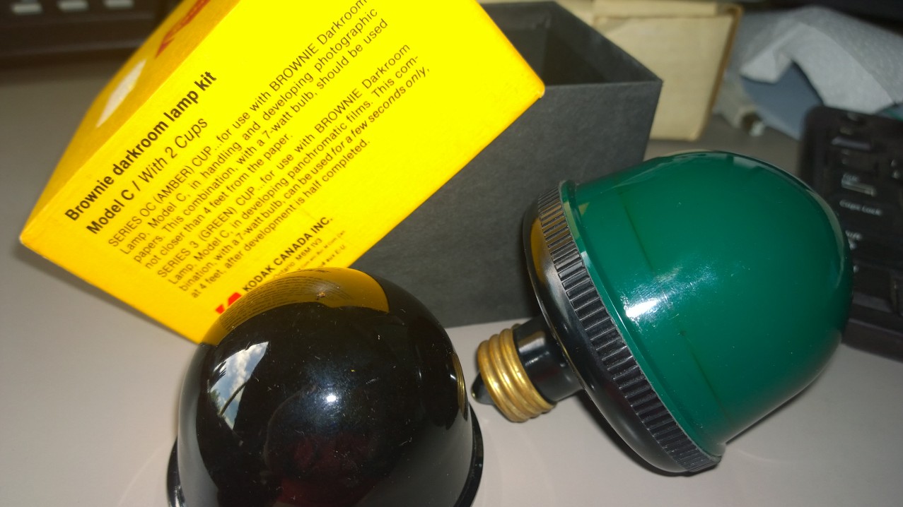

I've had a look round and didn't have much luck. I did find a green filter but it's not marked and rather suspect and not all that dark.
I did come across this Brownie Model C with a OC cup and a #3 cup. After a few minutes I could almost see my fingers a couple inches away from the light.
Hopefully someone else will check there stash of filters and you'll find what you need.
