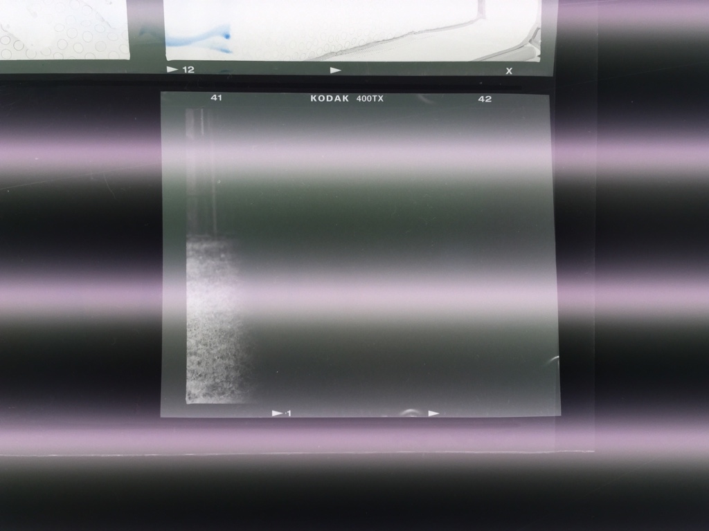

I recently got a Pentax and shot one (or was it two) roll(s) with it. I was disappointed with the one I got because I had issue of almost totally blank frames. I'm not sure if it's a light leak or slow shutter speeds. I haven't done a full shutter test, but that's coming up soon.
The P6x7 issue left a bad taste with me, but I know my camera is unique and the problems are unique to it, not all of them. But man, love my RZ67!
Internally it is a rather simple camera, nothing that a camera tech couldn't solve. The only fine adjustment seems to be at the shutter curtain brakes.
I remember the missing frames were possible < 1/60s, so that's why I'm thinking this. *le sigh*
Forgot to mention:
There is a common failure, which is when the shutter speed dial contacts get dirty/corroded/etc. In this failure I think the consequence is that the shutter stays open. This would cause the problem you mention.
Solution is really easy since removing that part of the top cover is easy. There is a tutorial on the web for this:
http://www.djcphoto.com/index.php/pentax-6x7-shutter-problem-solved/
I've heard about that, but didn't think about it. I'll check then film again to see if it's actually a light leak or shutter related.

I don't think it's a light leak. Eek.
But this is what some of the shots look like. The banding is from the light box and my cell phone, ignore that.
